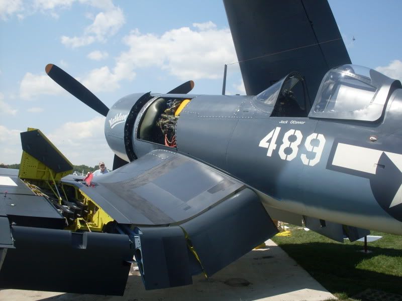

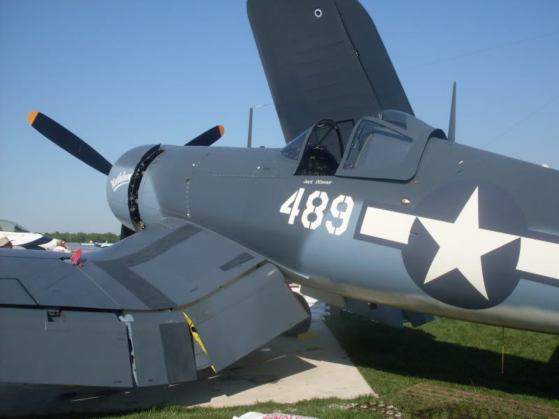

But I'm curious..what's with the dark sea blue on the undersides of the outer wings? Normally they were painted intermediate blue, like the sides of the fuselage and tail. I'm not saying it's wrong, just that I've never seen it before.
I've got numerous period photos showing what appears to be dark blue on the underside of the wing panels, matching the top side of the fuselage. The photos I've see where the medium blue is applied seem to correspond with the earlier red-surround national insignia. Maybe some of our more avid modelers can tell us if the tri-color paint requirements might have been modified to include dark blue under the wings at a later point in time. Being that the color of the underside of the wings would serve the same purpose logically as the top side of the fuselage while the wings were folded on deck, it would make sense to opt for the same color camouflage.

I'm pretty sure that dark blue lower outer wing panels were never standard; it was always intermediate blue.
In a lot of old photos it can be hard to tell the intermediate blue from the dark blue. In the 1970s this misled a lot of researchers/modelers/restorers into thinking that some USN aircraft were dark blue with white bottoms and no intermediate blue, which was never a standard scheme. You still see this on a few warbirds today, like the Corsair in Farmingdale.
However, dark blue could have been informally field-applied to the lower outer wings in some cases. I notice on this restoration that the dark blue panels extend inboard several inches into the non-folding portion, with a fuzzy demarcation line. That, also, is non-standard. Given the general calibre of the restoration, one would assume they wouldn't miss something like this, and that this aspect of the paint scheme is well documented. They've probably got a documentation book for the EAA judges with the evidence in it. It would be interesting to see.

John has more documentation on the Corsair than anyone else save maybe the Smithsonian. He has meticulously documented this one. I have watched this one go together from the beginning and it should get all the points for depth of restoration and degree of difficulty. Also should get points for the last minute thrash as they worked around the clock the last 6 weeks or so and were still painting stuff Sunday.

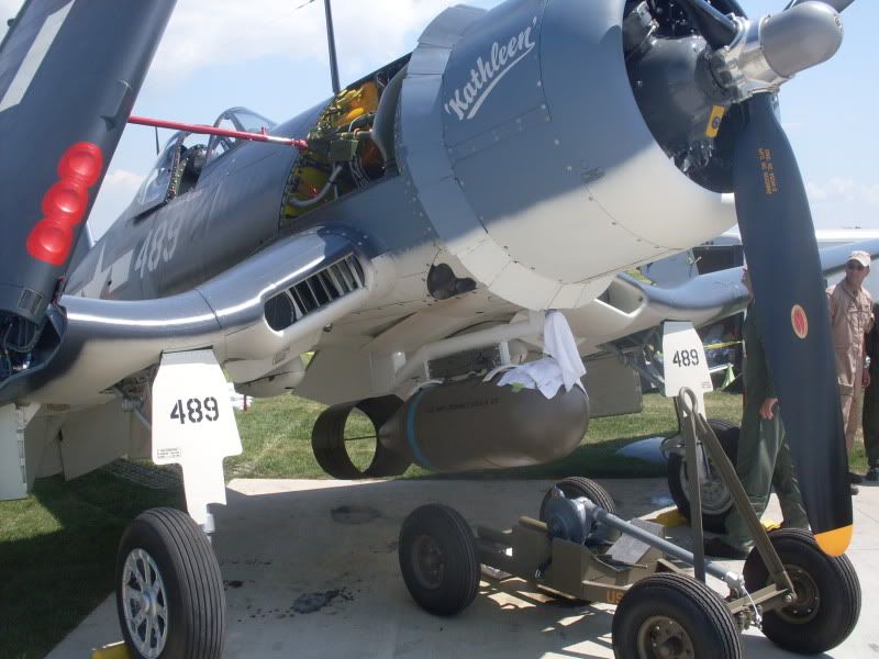

Aaarrrrggghhh! I don't want to rain on their parade - it's a truly beautiful resto -BUT someone needs to show these guys how to do fire sleeving properly! It's not worth a pinch of pooh from what I can see here. The fire sleeve needs to be end dipped to prevent soaking up oil/fuel/etc and the ends need to be secured with the correct bands over the socket. See http://www.sacskyranch.com/hosemistakes.htm
