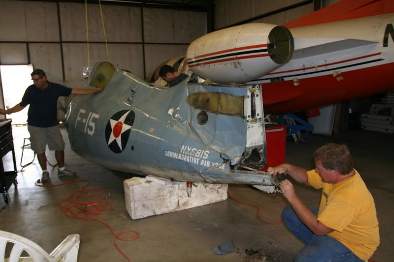

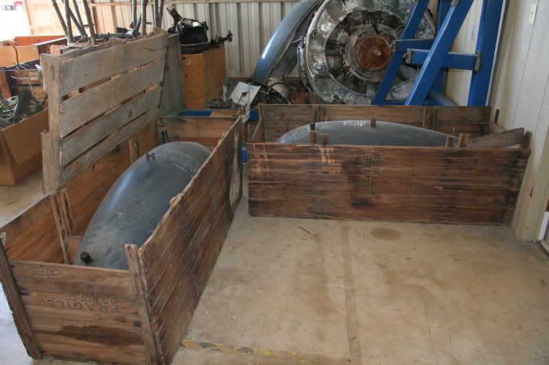

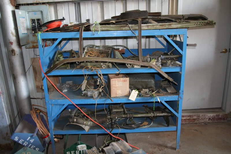

The first couple of months were spent inventorying what we had and what we may need. We also got a set of microfilm that contained, as far as we can tell, most of the FM-2 drawings. We promptly had the microfilm converted to .pdf files and burned on a master CD. I then spent about 5 weeks, on and off work, creating a Master Drawing List in Excel so that we had a searchable data base to look for what drawing we may need. We have a huge inventory of "stuff" and found a few very interesting pieces. One of these were two NOS drop tanks still in their original crates.

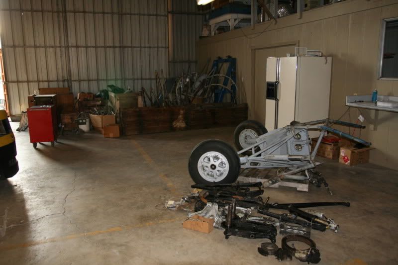

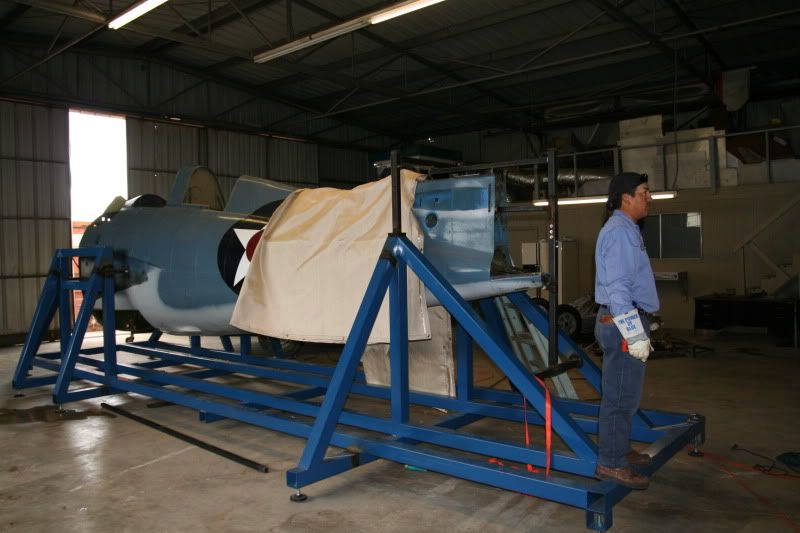

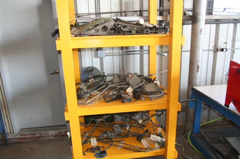

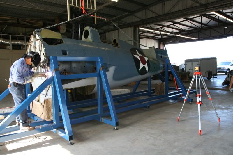

The #1 fuselage is really in great shape with a few areas that need repair. In the middle of October we began stripping all the removable components in preparation of paint stripping, inspection and using this fuselage to finish the fuselage fixture to use on #2 and #3.
Landing Gear and all conduit and components...

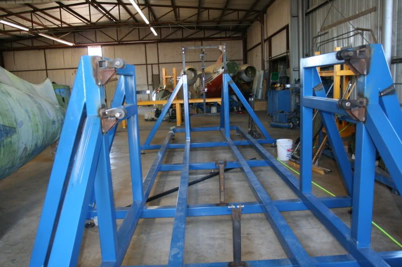

Then the fuselage was loaded into the fixture for locating attach points...

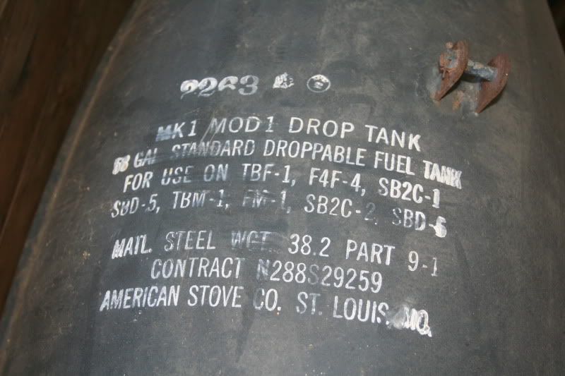

I love the manufacturer on the drop tanks, American Stove Co. It's always interesting to see the variety of businesses that changed to war production.

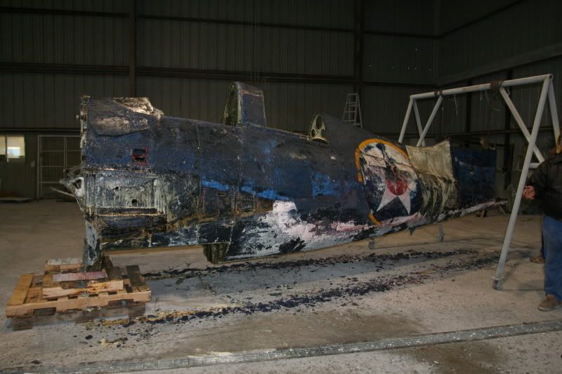

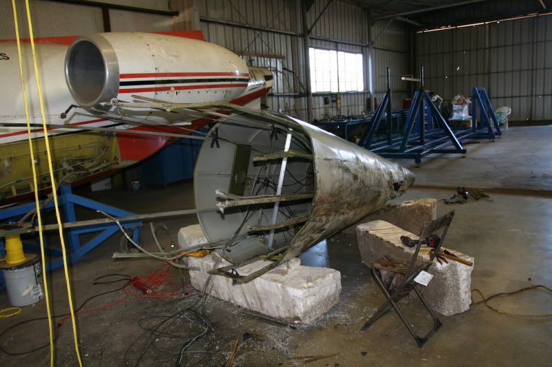

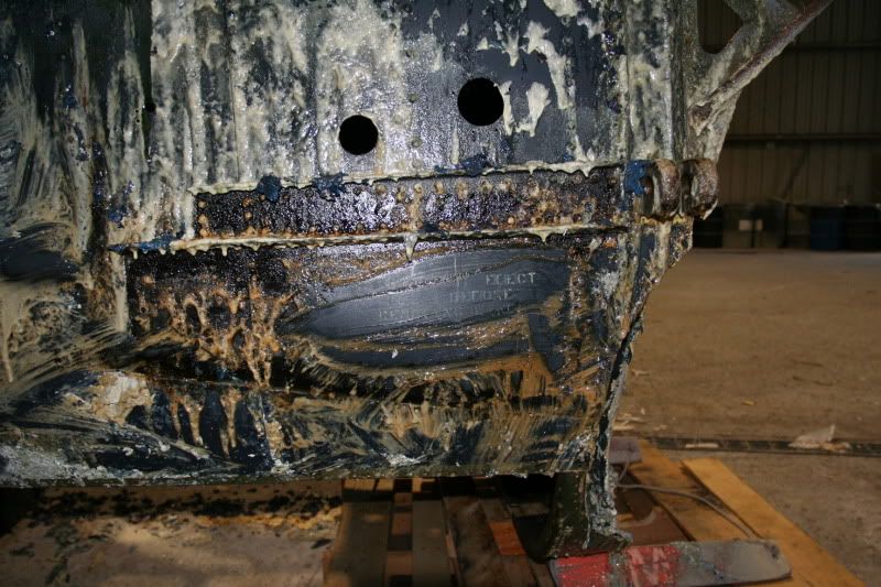

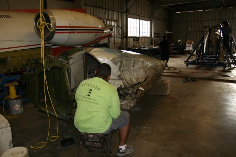

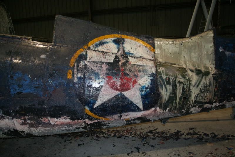

After getting the first fuselage out of the fixture, we sent it down to the paint shop to begin the stripping process.
The somewhat finished fuselage fixture.
Stripping

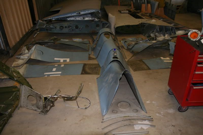

and then began to disassemble fuselage #2

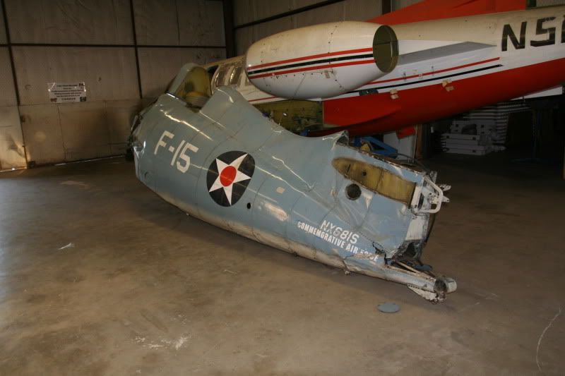

As mustanglover mentioned we have one going on at the Fighter Factory, I didn't want to hijack his thread or steal his thunder so to say. But we have been communicating about the projects. But to give a peak here is our fuselage after it was stripped. I'll post anyother pics and info on it in a different thread.
