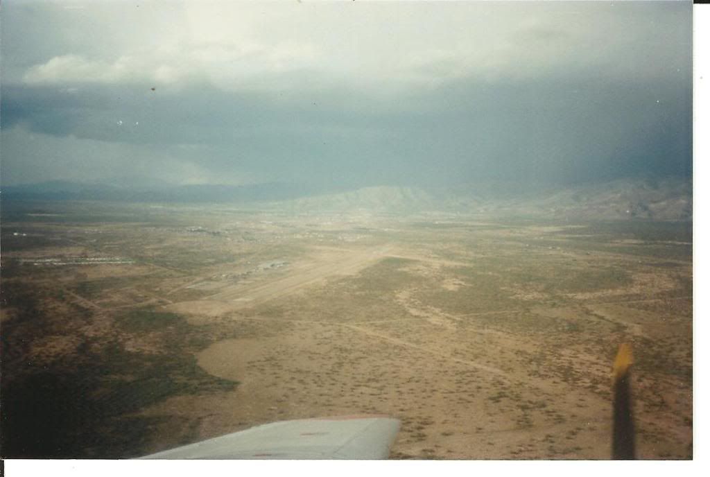

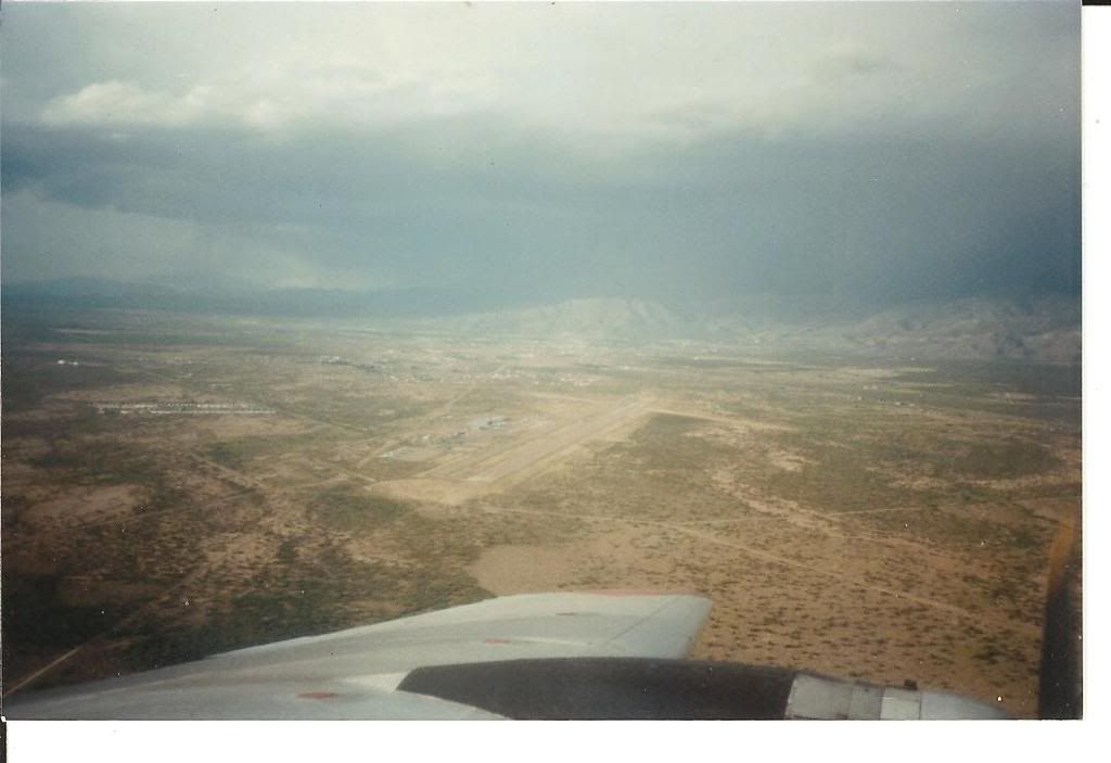

As far as sailplane techniques go,Alamagordo has some mountains just east of the airport that usually supply a fair amount of lift if you stick a wing as close as possible to the hillside and drone back and forth north and south until you find some lift.I'd watch for orbiting buzzards and chase them out of their traffic patterns until the lift gave out.These pictures are looking past the Alamogordo Airport pretty much down Runway 03 from Tanker 22 in 1983.The angle doesn't show how quickly the mountains rise.The tops are close to 10,000 ft.Note the nasty thunderstorm,which is another feature of being based in New Mexico in the spring and summer.

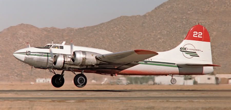

...on the subject of Tanker 22...this is at Hemet...26 Nov 1980...
