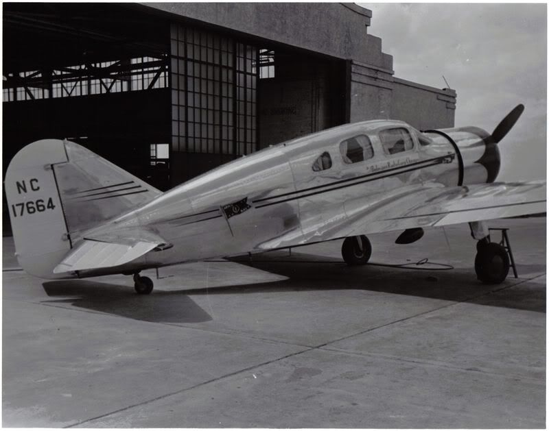

Django,
If you're talking about this one:
Then yes, it is a survivor. Currently registered to Burton Bucher of Waukegan, Illinois.
http://registry.faa.gov/aircraftinquiry ... rtxt=17664

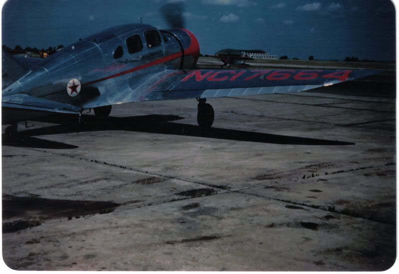

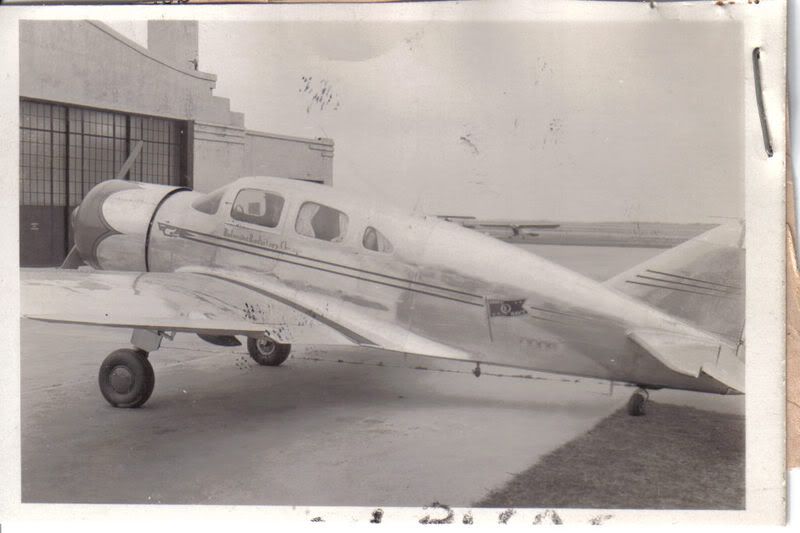

Other shots of this particular airframe (kevin showing off here)
Notice the Army-Navy "E" Award flag on the side...
And just for fun, in color:
Like I said, how bout those fun paint jobs? You could even stick with one airframe and still follow its paint jobs through its history and have fun. Not including the ones that went to Mexico and possible saw service with the Mexican Army or the Spanish Republicans in the Spanish Civil War, there were about 20 Executives that served with either the USAAF, the RAF or the (I think) RCAF.
kevin
