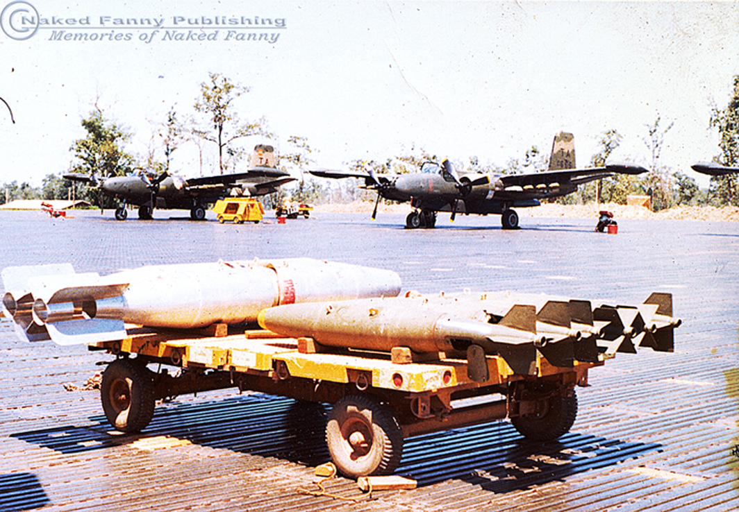

This first pic shows the way ordinance was delivered to us soon after that. By that time the bomb dump had enough people that they didn't have to use the 40 footers any more. Instead, the load needed for each A/C was delivered. In this case we loaded 2 750 lb napalm on the inboards, and 500 pounder Mk82 "Iron bombs" on the rest of the wing stations.
This pic shows a lot. First, you can see the type of "PSP" we had at the Nimrod parking ramp at the time. Also, Notice the two loaded A/C in the background. One is '666 and the other is '660. I took this pic in October '69. This would have been at the end of the rainy season. This would most likely been a load for going up north to Barrel Roll (Plane of Jars region.)

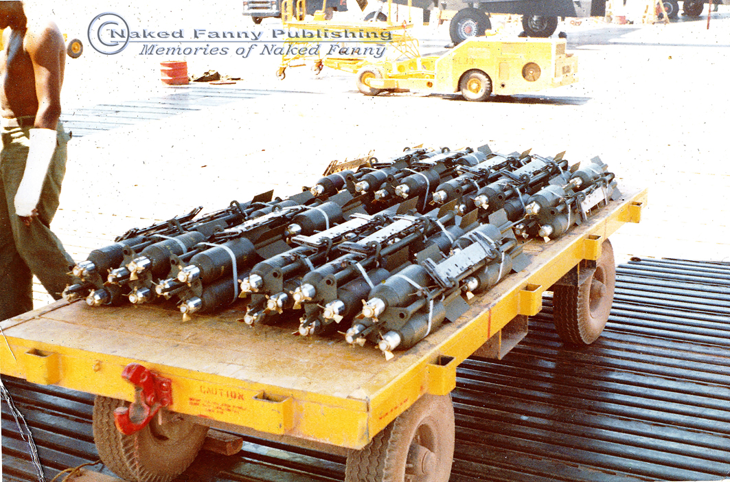

Here's a close up of the fuse trailer... like the one that was in the earlier pic.
The M904s go in the nose and the M965s go in the tail of the "iron bombs".
The Willie Pete go in the nose and tail of the Napalm. The little fuses to the right of the Willie Pete are the burstors that screw into the Willie Pete... they explode on impact and burst the Willie Pete canisters open.
The little fuses in the black tin cans are for the M1A4 cluster bombs (next pic).

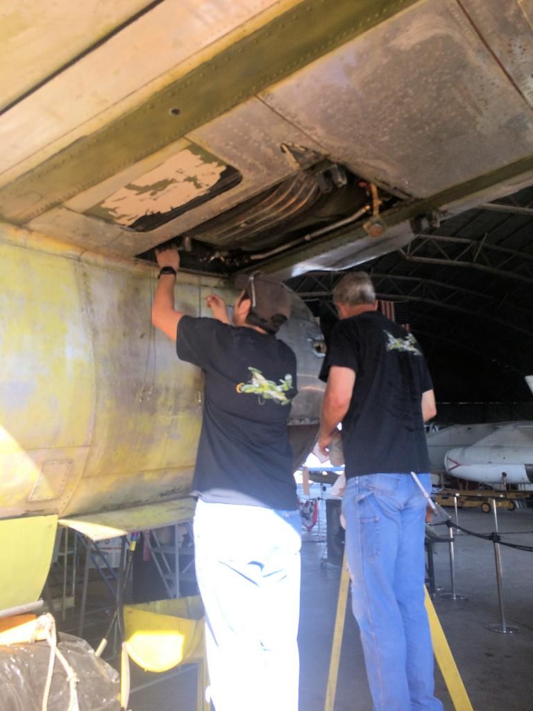

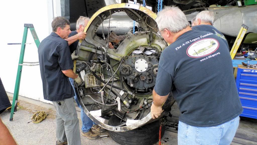

The team had a great day. JR decided we needed to remove the QEC before the engine gets picked up for the long trip to Idaho for overhaul this week. So everybody turned to and started loosening wires, hoses and anything else that got in the way. We thought it might take an hour. Wrongo... took the better part of the day so everybody is worn out including me. It was a great time for Big Mike to visit since we needed his strength to help lift it. He is home from FL for awhile. He has been missed on the team. Will post some more pics tomorrow. We had a great BBQ luncheon today in the briefing room with the CAF A-26 guys and some from the Navy A-3 crew. Viewed a grand video put out by EAA Warbirds about OSH and why folks continue to restore great old airplanes, tell the stories of those involved originally and preserve our history. It is narrated by David Hartman and very well done. Can find it on youtube. Look for 2014 Warbirds in Review. A good time was had by all. The other JR PS If anybody is interested, the CAF is planning to pull Buba out in the morning about 9 am and see if the carb adjustments worked with some engine runs. Good 2800 noise! :-)

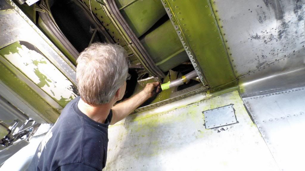

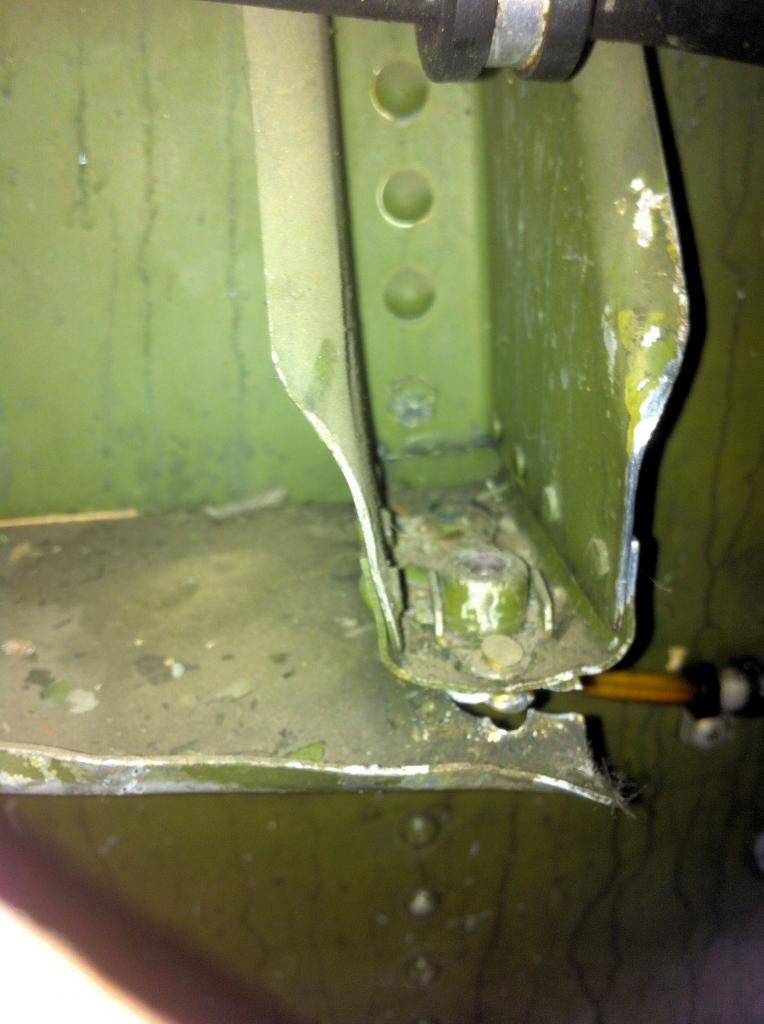

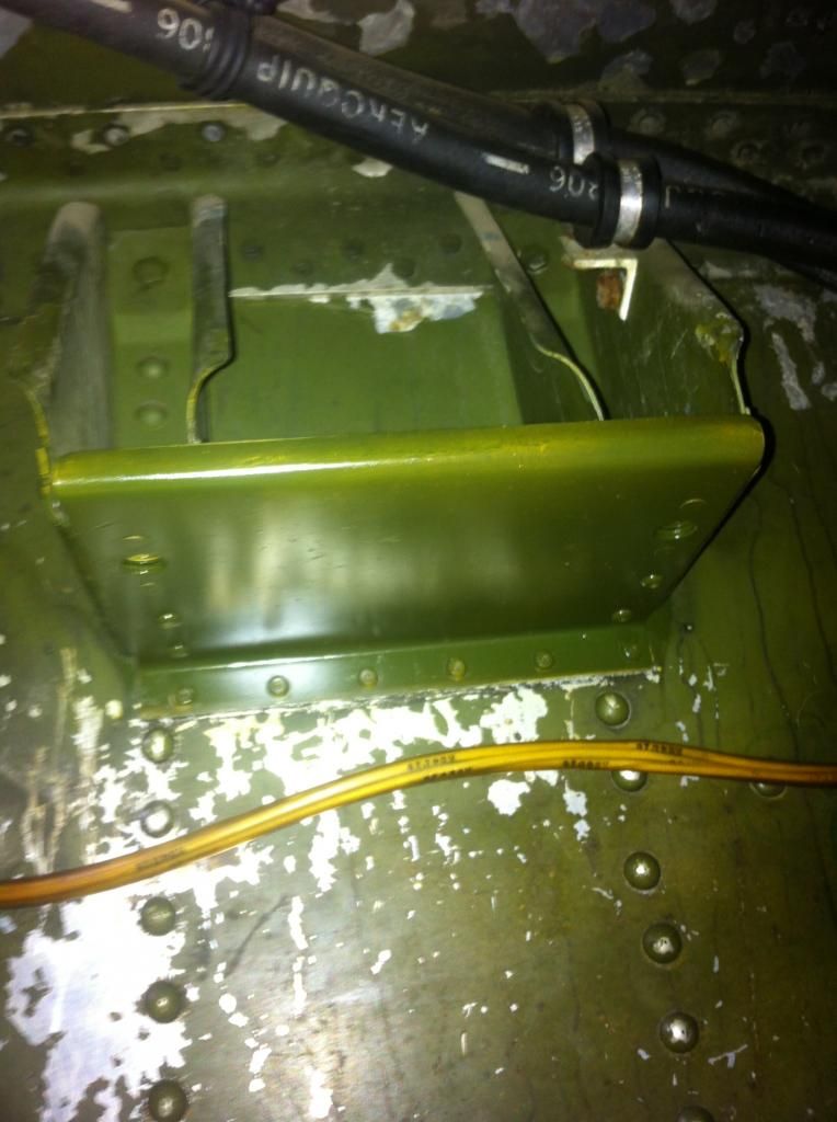

In the process of pulling the right oil cooler yesterday to send off for overhaul, the bracket suffered an owwwwie. Luckily, Metal Man flew to the rescue. Ck out the difference Ray makes in the next two shots.
PostPosted: Sun Aug 10, 2014 1:54 pm
Posts: 2563
The bracket tore out when the oil cooler was pulled. Doesn't appear to have been out in ages. Good thing we decided to get the oil cooler overhauled. This area had all sorts of gunk built up around the compartment. A good clean start of all components for the new engine is something JR thinks will save some trouble down the line and we couldn't agree more on it. The other JR

Here is the after shot. Ray did a bang up good job fitting the new bracket in a very confined area. As usual, we have come to expect miracles from our Metal Man!!! He always delivers! Thanks Ray!! You da man!! JR

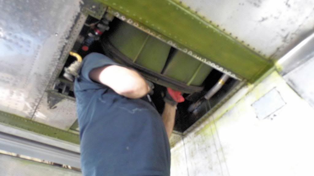

Here is where the trouble all began while Tim and Frank were trying to remove the oil cooler. There was a big buildup of gunk, dirt and oil inside the compartment. Frank cleaned on it for hours. The steps and floor beneath looked like a dirt pile when he was done. The airplane is probably ten pounds lighter now. :supz: Thanks guys! JR
