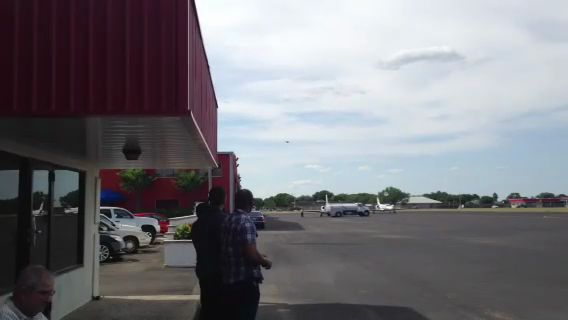

Lets try this!
A new never before flown Wildkitty is now gracing the skies of the world!!!!!
Clicky Clicky...
