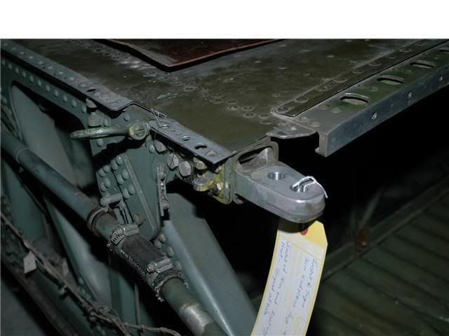

Image Three of the wing extension attachment point brackets are back in, Yellow tagged with new hardware.

Sorry there's no pics this REPORT...
We had ANOTHER new "extrusion" manufactured at a machine shop up in San Antonio... It has picked up the nickname "The Napkin Holder" because for all the world that is just what it looks like.
But when we whittle it down and drill it and mount it, it will more resemble the Compression Channel Tie (thingamajigee) pictured in earlier posts.
Now we are experiencing the joys of suspending the bomber between four jacks and two heavy stands and tweeking it with a hoist, so we can relieve the pressure on the bolts of the old napkin holder so we can remove it and put the new one in... (Herman Melville would be proud of that last sentence...except I left out the whale and some of the inner angst!)
We are competing with the rest of the CAF for an internal to the CAF Restoration Grant. That would sure speed things up.
TEXAS RAIDERS is back on its wheels again, because we had to reposition it, so it really does look good again.
Other than dodging Gustav, rebuilding a workstand, stringing more flight cables, completing Grant Applications, drilling out old rivets, cleaning wing attachments points for the new napkin holder, work on the top turret cuppola, the bomb-hoist rack, the rudder trim assembley, not a lot has been going on.
