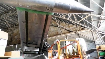

FILL THIS SPACE!!
Saturday is coming and we have some really import milestone events in the planning stage. Filling this space is one of them. You can see the gap seal halves inside the slots. The other half is attached to the aileron and then zipped to the middle from each end. The left aileron is the last control surface we have to mount. Yay!! Now, the big agenda item is to hang the left engine. If we have enough troops and all goes well, we might just get that done this weekend. The prop then can go on the following weekend. There is a lot of work to be done hooking up all the gauges and control cables to the engine so keep your fingers crossed it goes without a hitch. Big Tim did a lot of the legwork on his own last Friday to get the aileron ready to hang so thanks Tim. You are appreciated, big guy!! Cheers... :-) JR

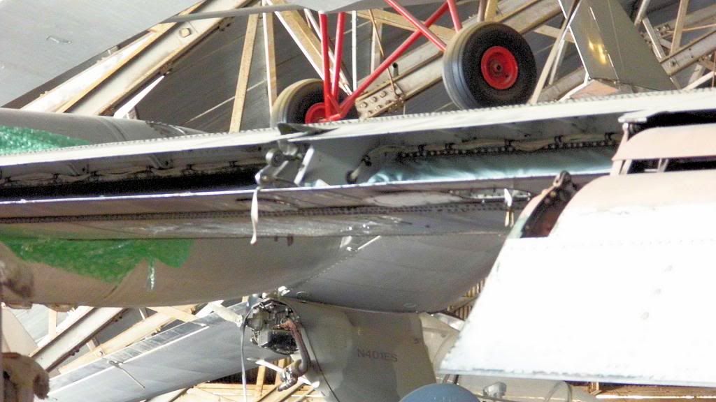

Different angle, same story. Fill this space!! Also, the tip tank is showing where the jettison vent is on the end... the former mystery part of the week. Frank's story about jettisoning fuel during the break from an overhead approach started me thinking that if we can't make them hold fuel, wonder how hard it would be to put smoke generators in there??? Just daydreaming outloud!! :-) JR

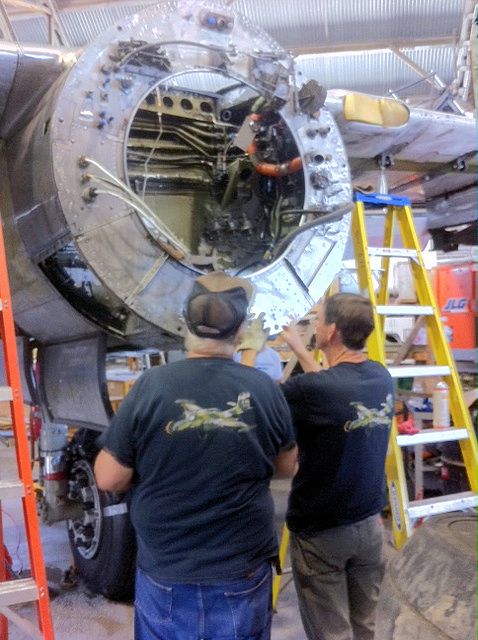

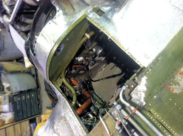

So where did the engine hang start... well, with Ray's repair on the nacelle that had been damaged by the left gear collapse many moons ago. That curved newly primed area had some corrosion problems as well. He fabricated a section to replace this area. He can do magic with metal. I sometimes think that he could build a whole new airplane if he wanted to do so. :-) Thanks Ray! JR
PostPosted: Wed Jul 16, 2014 8:07 am
Posts: 2563

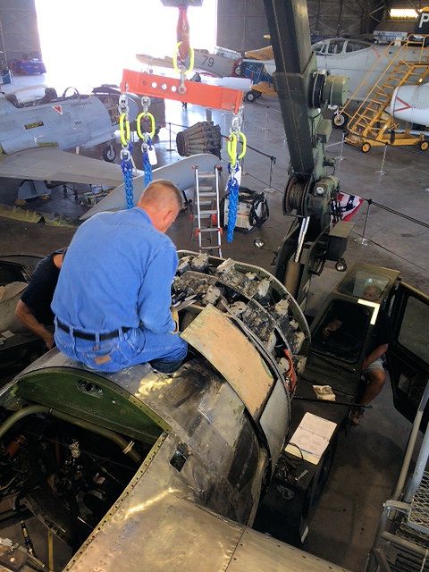

To fill this space, the team finished the prep and got everything ready for the lift. You probably won't see this space empty for a long time... we hope. This will be the last picture of the firewall until the next engine overhaul whenever that may be needed. Rand and Stan are making sure all of the hoses and wires are out of the way as Ed drives "Ichabod Crane" up in place with the engine ready to hang. JR

David A is on top looking at the alignment so the six bolts can be inserted without much trouble. Hmmm, well that is easier said than done as it turned out. :-) JR
