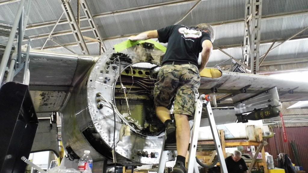

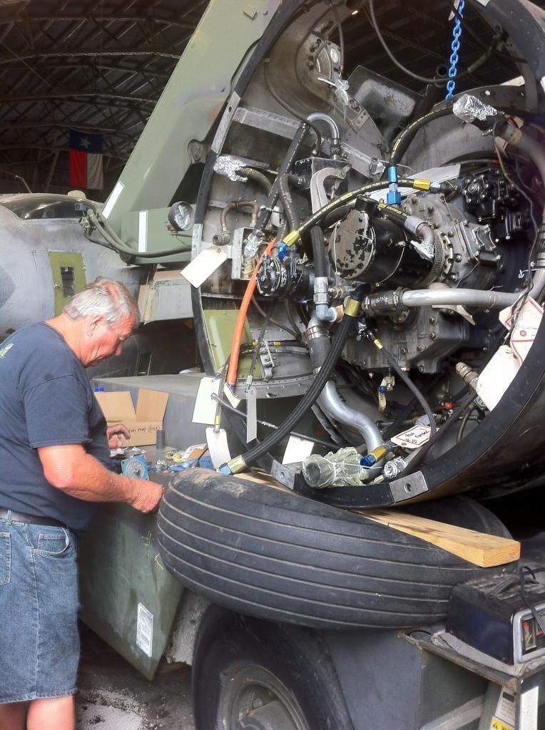

Ed and JR got busy installing the engine accessories that have come back from overhaul by our friends at S & T down in New Braunfels. This engine is about ready to hang on the airplane!!! Whooo hooo... then the other one goes out for overhaul. Light at the end of the tunnel and it is not a train this time! :-) The Other JR

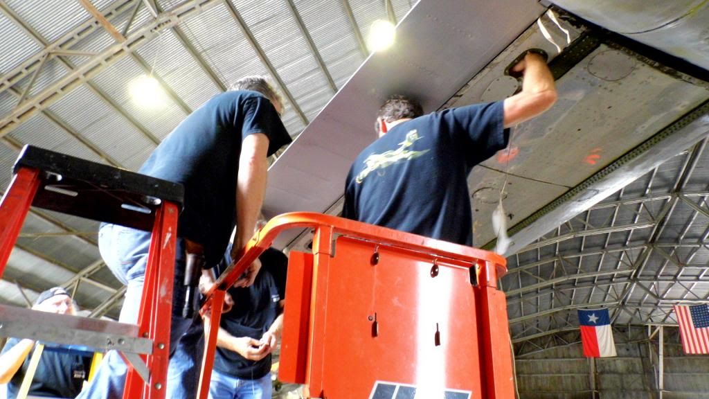

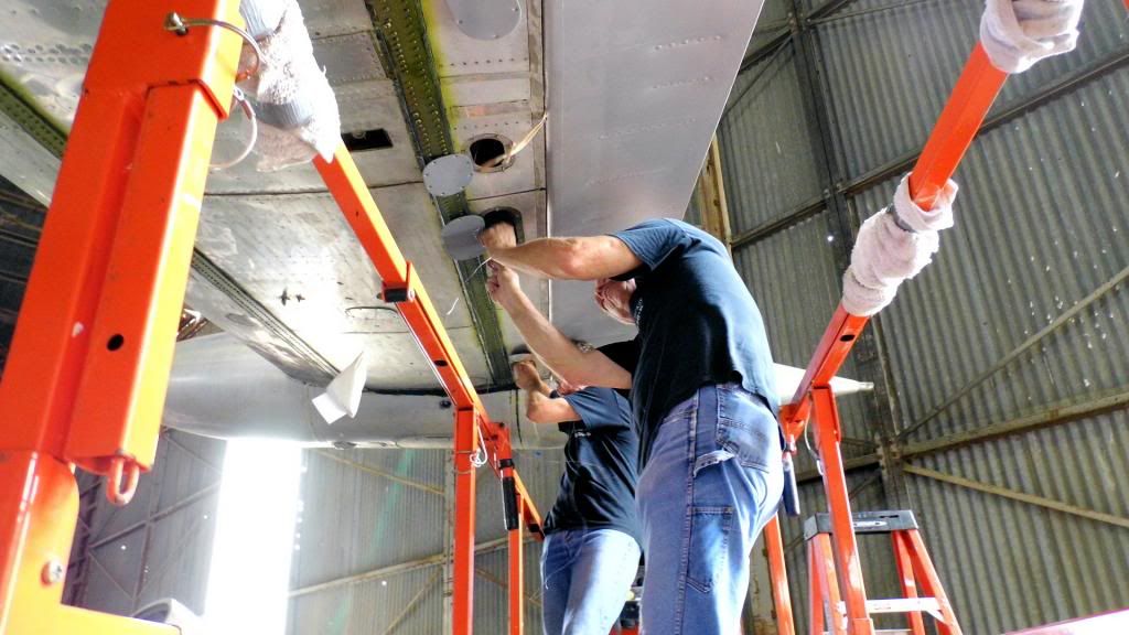

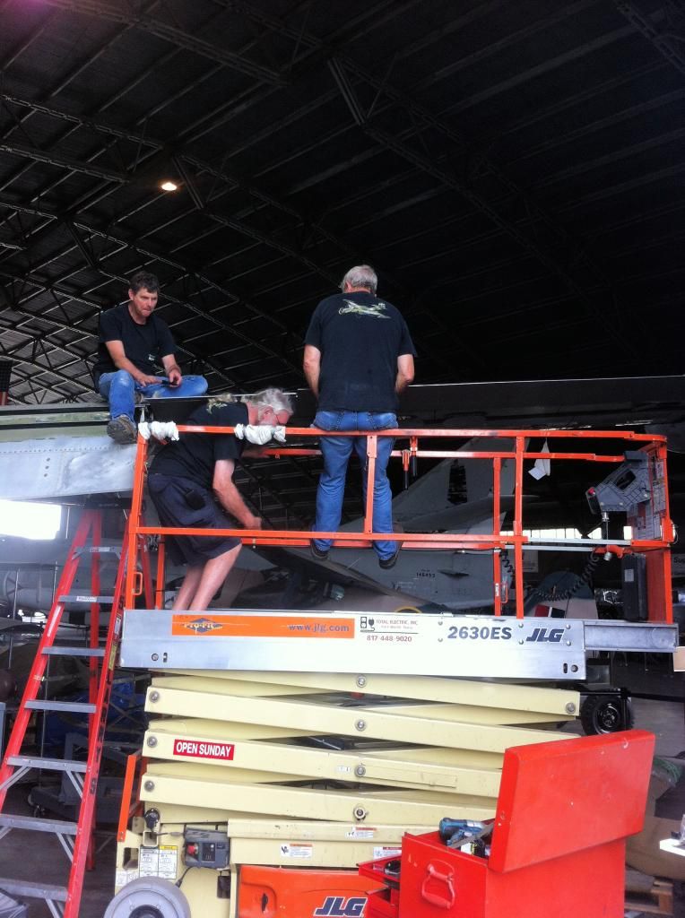

Tim, Rand and JR had their hands full with the zippers on the gap seal after hanging the aileron. There is no room for hands behind the aileron to zip the two pieces of the gap seal together. Instead, they had to use some safety wire on the zippers and pull them closed thru the inspection ports on the bottom of the wing as seen here. It took a couple of tries to get the geometry right, but Tim finally got it figured out. The zippers slid right up like a prom dress on our ol gal K. :-) Congrats to the team who made it happen. May you have even better luck on the other side! The other JR

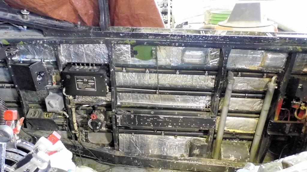

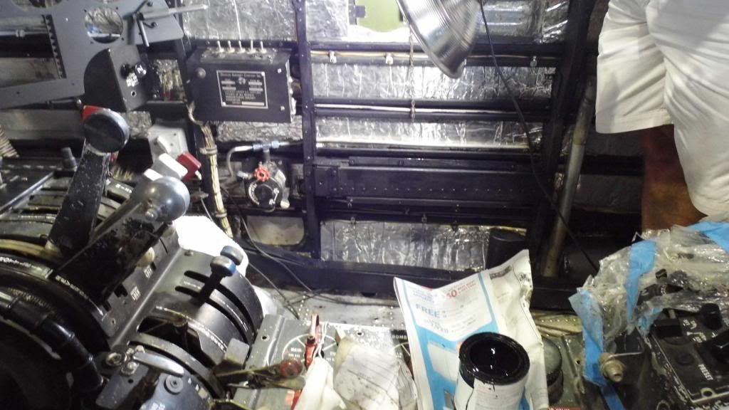

Meanwhile, work continues on the cockpit. Rand got the insulation installed awhile back, but here Jim S is putting on some flat black to touch up the sides before we place the quilted material over it. So now, that leaves open the question of why we used flat black there instead of primer so go ahead and ask, Duck Drivin Lady! We know you are dying for the answer.... :-) JR

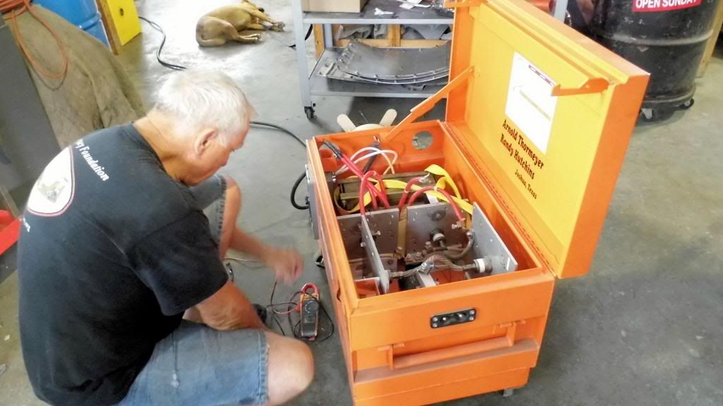

Arnold, with his able assistant, Inu, has been checking out our ground power unit to make sure it is putting out the right voltage for the avionics guys to run tests, etc. It appears that the line voltage coming into the hangar changes from 240 down to 236 v as the day goes on with the all the air conditioners kicking on with the heat of the afternoon. The hangar floor area is not air conditioned but we do have a large number of big fans around to try to cool things a little bit. Anyway, he just about has a handle on it so we can continue with electrical checks. The guys are just about ready to start with the engine instrumentation among other things. Thanks Arnold!! :-) JR

Tim, Rand, JR and Mac had better remember how they put the right aileron up because we hope they can repeat the feat next Saturday on the left side. This means that all of the control surfaces will now be mounted and ready for rigging. Besides the usual activity around K, this is going to be a very busy day. Buba may take to the skies once again for the airshow at Cedar Creek Lake and if so, I am supposed to be on the crew. The DC-3 is available to book fireworks flights on Friday and Sunday evenings. Contact Dana at greatestgeneration@yahoo.com for info. Saturday night, our volunteers have a DC-3 flight over the Six Flags area to watch their fireworks display. Talk about a ringside seat. It is a "thank you" for helping out so much on the airplanes. Incidentally, we have a new webmaster and want to welcome Jeff on board. The A-26 website is under construction and already has a new look. Try http://www.gga1.org and click on the picture of the A-26. Or use http://www.thormeyer.net for the direct link. We are excited about these new changes. Stay tuned for more. The other JR

More of the guys hanging the right aileron. It really did take all four of them to get it lifted and held while the free hands put the bolts in. Then the gap seals had to be zipped together which took a great deal of coordination. Kudo's to the team on this one. BTW, that tail in the background is of the Navy A-3D that was brought in from the outside while the B-29 and B-24 are gone on tour. The former A-3 Navy guys are working to restore it cosmetically and will place it on display as a memorial. This was the largest aircraft ever to operate routinely from a carrier deck. To lighten the weight, the ejection seats were removed. Some jokester then came up with the phrase for the A-3D as meaning "all three dead" if there was a problem. Actually, the aircraft sometimes had more than three. It was similar to the B-66 that was depicted in the movie "Bat 21" when doing Intel or recon work. Others were used as tankers because of the load they could carry since they were originally intended to be bombers. It has quite an interesting history. Drop by on Saturday and talk to the Navy guys about it. They would be happy to tell some sea stories... and some of them might even be true!!! :-) JR

Ray finished up the nacelle repair with his usual metal magic. It was a complex curved part he had to fabricate, fit and get heat treated. Then shoot the rivets to hold it in place. Hard enough to do, but he was wrestling with a back problem at the same time. Talk about dedication! Can't say enough about his contributions to our project. Thanks Ray! JR

In the cockpit picture where the insulation is going in on the right side, are the two vertical tubes sticking up there connected with the entry ladder that pulls down on the right side? Woodie

woodie wrote:
Jr:
http://i1250.photobucket.com/albums/hh5 ... 1684af.jpg
Woodie, that's right... part of the entry ladder system. This will be covered up when we are done with the cockpit. There is a release from inside the cockpit to extend the ladder. Could come in handy if we can't get the bomb bay doors open for some reason. I suppose us old guys can go down it even if we can't go up so easily. Hope I never have to prove that!!! :-) JR
