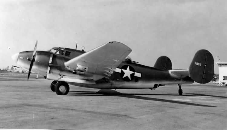

This is a photo of VPB-148 Harpoon when they were stationed at NAS Kaneohe, Hawaii. They lefy for war in the PTO from here and then continued anti-sub patrols while based here after the war.
As Jenny said, we certainly enjoyed having these fellows out to the Harpoon and hearing their stories. I encourage any WIXers who have ties or contacts to any of the other Patrol Squadrons to contact us with stories, photos, or who would like to visit the Harpoon. We are always happy to keep the history alive.
PJ

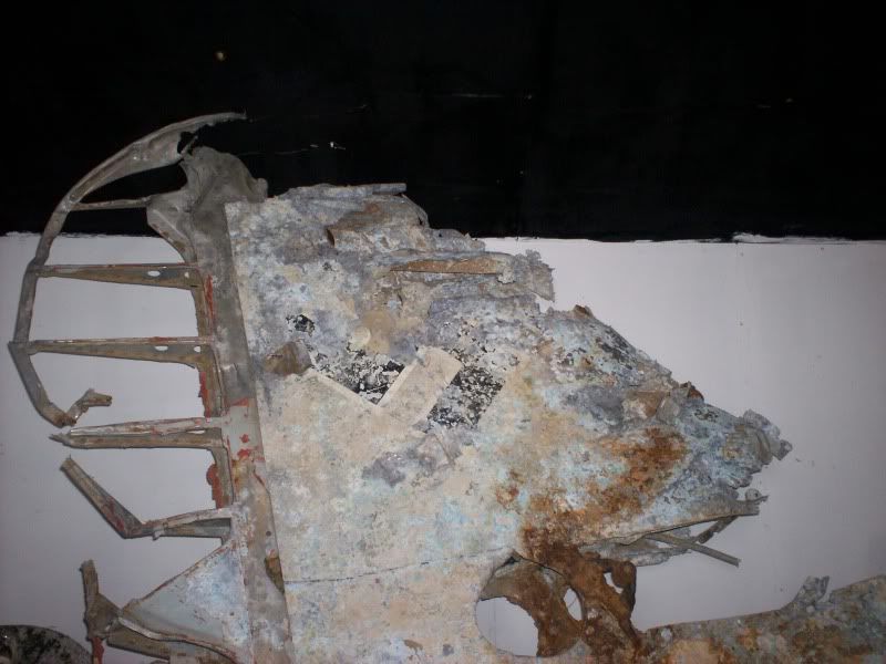

Here is the tail section and various parts from a Fw-190 that were discovered during the dig:
Another view:
As you can see being buried all of those years and the freezing and thawing in Indiana haven't done them any favors.
These are some sort of turbine parts off of German planes:

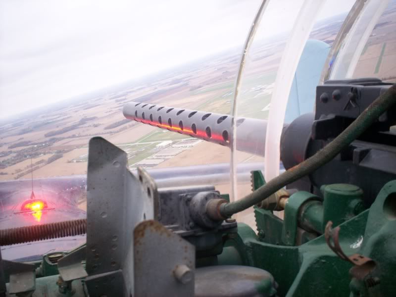

We finally have two new Crew Chiefs signed off for the Harpoon. This allows me to ride in my favorite position and THE best seat on Hot Stuff, the top turret. Here's my view on take off:
And looking forward:
This was a practice flight for Tall Glen's checkride and the sign off checkride for new Crew Chief Hot Rod Steve. He was under the watchful eye of Head Crew Chief Jenny and passed with flying colors.
It was a cold and damp day in Central Indiana and I wished the old Harpoon still had her Aleutien heating system or that I had an electric blue bunny suit, but any day of flying on the big blue bomber is one to be cherished. I could only imagine the looks of the people on the ground as we thundered by overhead with the contrails streaming off of the props looking like all business. All of the years that I was ground bound and wished to fly, and now I am able to do so. I am one of the luckiest people on earth!
