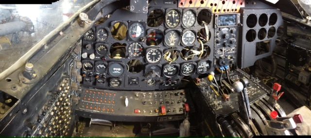

Larry and Stan the Man made a lot of headway today getting the instruments installed back in the panel. Ran into a glitch with the HSI though. Looks like we may have to send it off for repair. I suppose we should not be surprised when something simple goes to the complex side!! At least the flux valve problem was resolved. It was 180 degrees out because of the reversal of two wires when the shop built the wiring harness. Oops! Took awhile to figure out, but Larry birddogged it until he got the thing working. Well, a lot of other things happened today, but I just got back from Canada, eh, so will post some more pics tomorrow. Please check back. JR

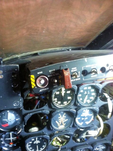

Guess what Larry found out yesterday. You see that little round button that is marked wing jettison?? Well, it is on the left battery hot bus, meaning it is live even with the battery master switch off. He bumped the switch on the backside with the handle of a socket wrench and got a big surprise. Nothing was jettisoned... except Larry out of the cockpit!! :-) JR

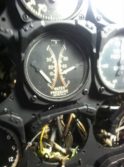

Ever wonder where the phrase "steam gauges" comes from?? Well, this is it!! :-) JR

......... He bumped the switch on the backside with the handle of a socket wrench and got a big surprise.
Sounds like what happened over at NKP one day when a crew chief was working in the cockpit and somehow shorted out the "bomb bay jettison" switch and a whole load of M120 Frag Clusters dropped onto the ramp. That got his attention also!! Fortunately they dropped in the "safe" mode and nothing spectacular happened--thankfully!! EOD had it cleaned up in no time. But, it resulted in our having to disconnect the batteries upon shut down on the ramp. So the battery connectors got a good work out for the rest of the time I was there.

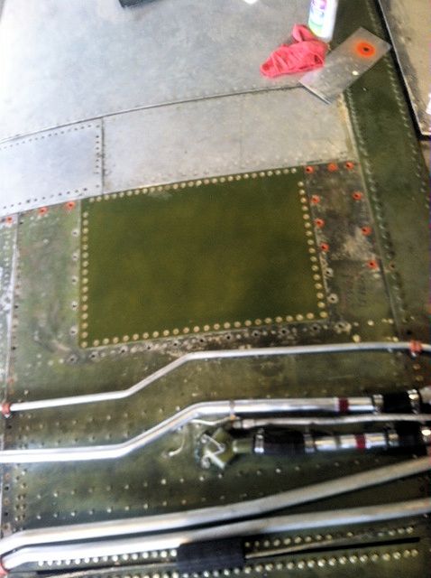

Stress plate is reinstalled with new hardware on top of the wing outboard of the nacelle. JR's new vent lines on top shine like new silver dollars. Jim S and Mac got the ones on the inside of the nacelle in the same shape. Those holes with red circles are where the prairie dogs emerge when a snake enters another hole. Now wonder if anybody will read this and swear off drinking? Or perhaps the Duck Drivin Lady will start with her twenty questions? Did you ever notice that about her, Ober? Oh anyway, it is Summer guys, lighten up!!! :-) The other JR, glad to be home in the Republic!
