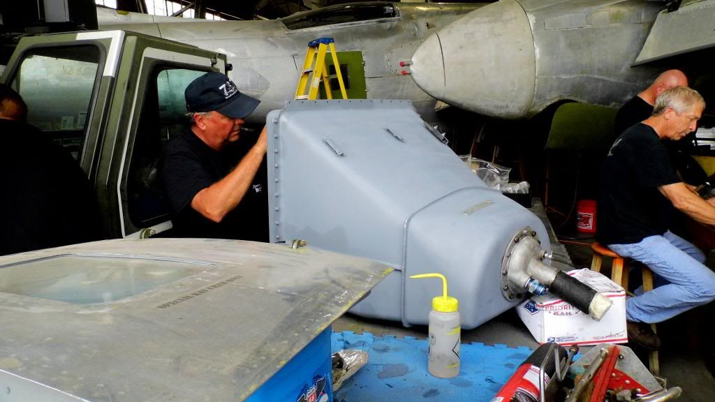

While Tim and David B are working on the aileron gap seals, Jim S is finishing up the oil tank for the left engine. Ray got it painted last week so now all the fittings can go back on. This is another item off the to-do list. JR reports we are up to about 78% completion at this point of the restoration. Fantastic work!! The other JR

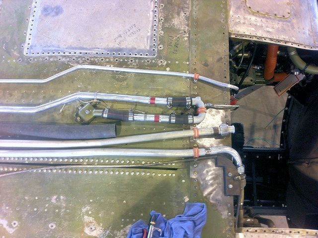

JR and Ray worked today on the left nacelle. I still chuckle over the fact that the Americans invented the aeroplane, the French got to name most of the parts and the Russians took credit for it. :-) But I digress... We are looking at the top of the wing behind where the oil tank goes with the cover removed. These vent lines run to the back of the nacelle. JR got new hoses and fittings on the fuel tank vent so that is now ready to go. The rest of the fuel system is about complete and has been leak checked. All fuel selector valves now work properly. We have one fuel pump out for overhaul. Should be back perhaps by next weekend. Keeping fingers crossed. Ray got a lot of the nacelle metal work done. Still has the one piece that will need heat treatment. He said maybe it will get finished this week. It sure takes a lot of dedication to put in extra days working in the heat of the hangar. Several attaboys are due!!! Thanks guys! The other JR

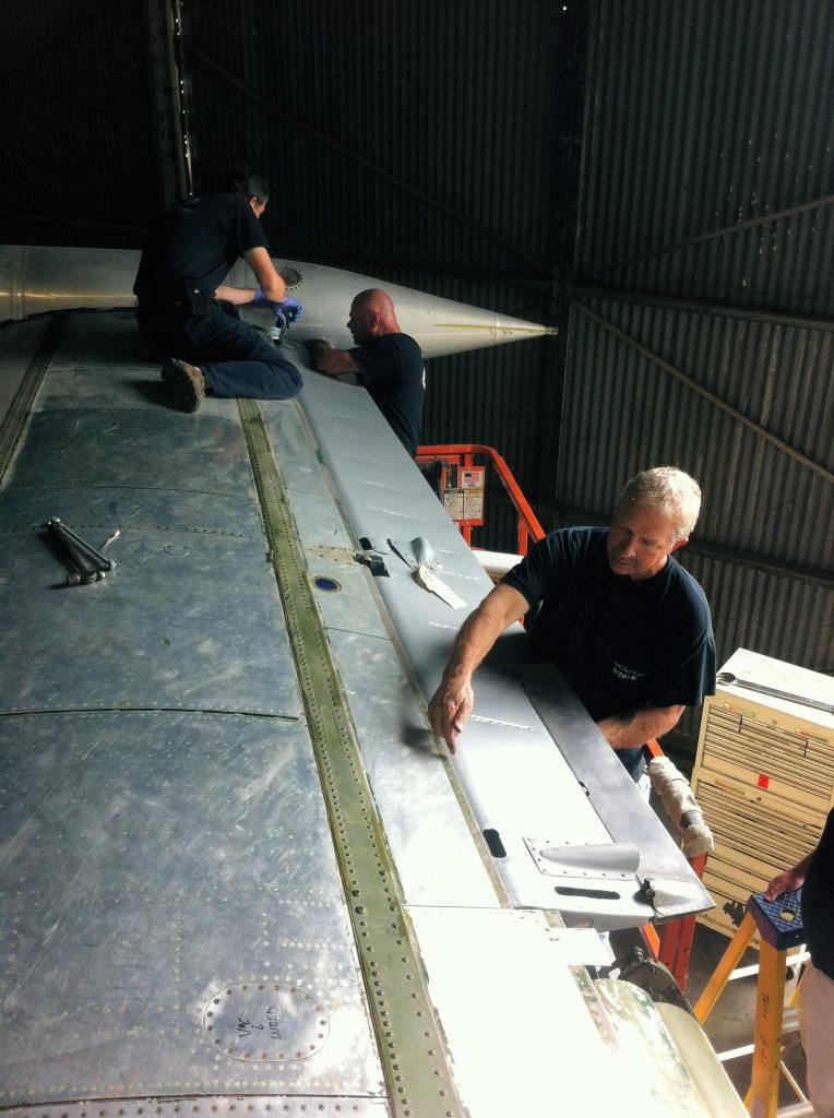

Tim, David B and Rand did a trial fitting of the right aileron and found some problems with one section of the gap seal. The manual does not show it real well or really explain how to get the zippers fastened. It can't be done with the aileron in place. So more puzzle. It finally became clear that two inspection panels on the underside of the wing could be used to access the gap seal area... barely, howsumever, instead of one long zipper that goes from one end to the other like we thought, it turns out to be two zippers that start about in the middle of the seal. Go figure... Always making something simple into something complex. Where have we heard that before?? :-) JR

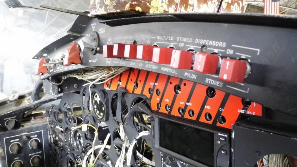

Rand has been busy with the refurb of the ordnance selection panel. The red blocks can be selected to arm each pylon separately or together for the drop or firing. Look out hogs!! We are getting closer!!! :-) JR, and the Ace Wild Hog Extermination Co.

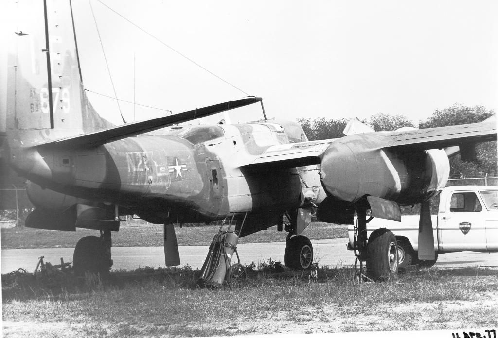

Guess this purty well settles the question of the tail code on the vertical stabilizer. This picture shows K in Macon, GA, when she belonged to the Georgia State Forestry Dept., before the crash landing in 1978. This is just the way she came from the boneyard at DM. The Forestry Dept. had obtained three K's with the intent of converting them to firebombers, but that never happened. The three airplanes were sold off and K was supposed to go to Canada's Air Spray, but the crash landing changed that plan. When Rob S. found her and talked Denny Lynch into buying and restoring her, it was a very close call. She was destined for the scrap yard otherwise. We want to thank Rob and the Lynch family again for saving K. This is just an incredible story of survival!! K was the last off the OnMark assembly line and the last flying example left. We are indeed fortunate that it didn't go a different direction. JR

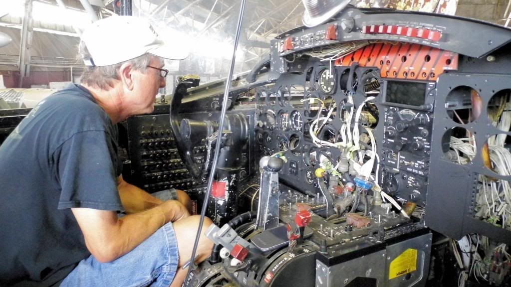

Larry is busy testing the bucket seat again. We are starting to get the picture that maybe we should go with something a little more stable. Anyway, he is busy installing instruments and finishing up the avionics. Has started eyeballing the engineering needed to install the Bendix King Lift Reserve indicator system. Mainly it is a matter of figuring out where to place the sensor. We have a spot on the nose in mind as being much simpler than trying to pull wire thru the wing for a mount out there. Will see how that plays out. BK suggested the nose as the first try. We ran into a glitch with the HSI system so that is taking higher priority right now. Always that "simple things turn out to be more complex than first estimated!!" :-) JR

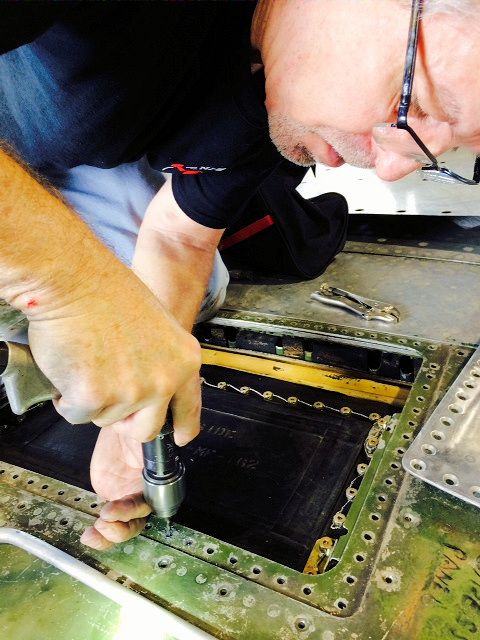

Our metal magician, Ray, spent some extra hours this week drilling out bad fasteners on the stress plate at the top surface of the wing just outboard of the left nacelle. I'm sure that you can picture that spot with this brilliant description??? :-) Anyway, we appreciate all the extra hours Ray has been devoting to this highly important phase of the restoration and trying to wrap up the metal repairs. On the other subject, Bob, I hope between Randy and me, we got your question answered. I think he on the road somewhere between Yellowstone and home base. Me, I am Toronto bound until Sat. Will be back just in time for lunch. How's that for good timing?? Well, except the guys are expecting me to bring it. Guess I better not be late. As hot as the hangar is getting, I suppose some Blue Bell ice cream would be in order! :-) JR
