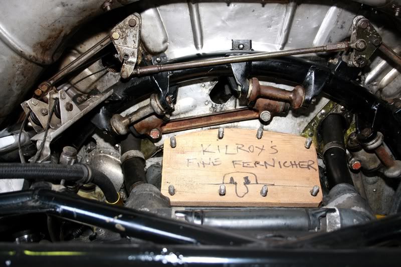

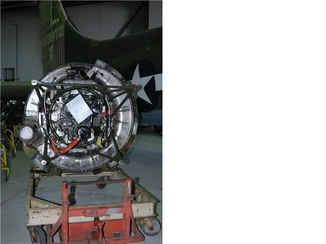

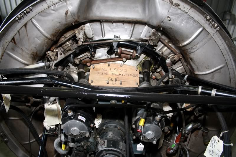

Latest updates... Col. Ron Dietes put some final cleaning on Eng. #2 and put the scat hoses back on.

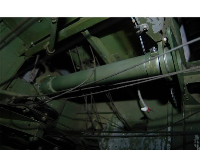

Do any B17 restorations have a picture of the Rudder trim tab adjuster mechanism that mounts in the rudder? (The cable drum and mounting bracket specically.)
We have drawings, but if we had a picture of a real one we might know what to look for.
Somebody removed TEXAS RAIDERS while the Rudder was being recovered and neglected to label it.
:evil:

 Post subject: Trim mechanism found
PostPosted: Mon Jul 14, 2008 5:40 pm
Joined: Wed Jun 25, 2008 10:13 am
Posts: 36
Location: Houston
Update:
Don located the rudder trim mechanism this Saturday. Thanks for all the help figuring out what it looks like.

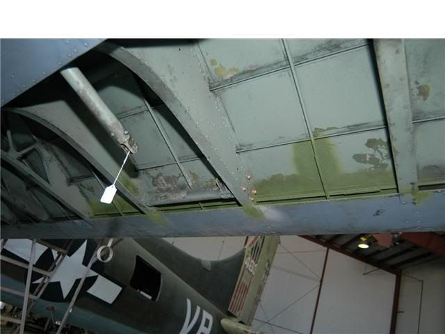

Hey Second Air Force...
How would you like to be in charge of "dropping the ball" (turret) that is next time you come down?
We need to address some corrosion in that area and it has been recommended that we do it BEFORE we hang the engines so that we don't risk a potential "nose over" when we lift the tail high enough to lower the ball onto a dolly-jack.
