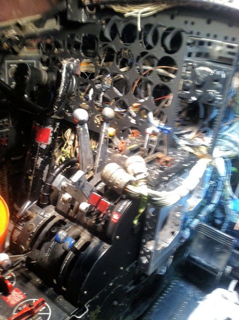

Posts: 2559
Larry and Stan have been putting in a lot of work to do this trial fitting of the instrument panel and arrange all of the wiring bundles. When completed, the panel will be repopulated again with all the instruments and radios, etc and installed so we can call that portion of the cockpit done. Well, er, sorta... subject to change as we have discovered that Murphy's Law still applies when it comes to this airplane. But everybody keep your fingers crossed when the guys flip the switch for the first time! JR

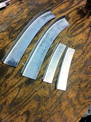

Our metalsmith Ray has been hard at it again. These pieces form part of the cockpit rear canopy frame. The original was badly corroded so Ray took flat metal sheet and formed it into the exact duplicate of the original shape. Here the pieces have just been heat treated and ready to start fitting to the airframe. These were not as easy as they might look to fabricate. Another attaboy for Ray! Great job! Thanks, JR

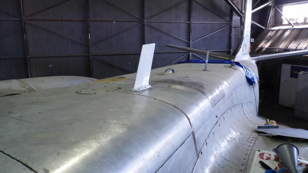

A funny thing happened on the way to the drag races up by Denton a few weekends ago for Stan. He just happened to notice this truck had two of the antennas we have been looking for on the back end. So he struck up a conversation with the owner and while the guy didn't want to take them off the truck, he allowed as how he had two more at his shop and would donate them to Stan. Wow! This is the shark fin antenna that was on top of the fuselage. They are in very good condition and they fit perfectly in the existing mounting holes so that will save some time. Attaboy Stan for the sharp eye!! Meanwhile, also on the avionics side, Larry reported two glitches with the wiring harness routing that may delay installing the panel for a few weeks. Two steps forward and one step back. Sounds like the "Texas Two Step" dance so that's ok. George Strait would be proud of us!! Maybe we need to play some George at the hangar so the guys can get in rhythm??? :-) JR

And this is how the antenna looks all mounted up. Should work just fine and last a long time!! Meanwhile, down below, Ed worked on getting the left hand main gear door shimmed to counteract the bend of the nacelle wall. Ethan and Kevin cleaned out the corrosion and mess found in the battery jar area inside that nacelle wheel well. All did a mighty fine job of it. Had a good turnout of guys this weekend. Slowly but surely, the many small details are coming together. Some big projects remain such as the aileron gap seals, but Tim and David B finished up the templete for the inboard segments so we can send that out to be made. Then the ailerons can be hung and the cables all hooked up. David A all but finished out the control cables for the vent system in the cockpit. Overall, a good day for everybody. Many thanks to the team! JR

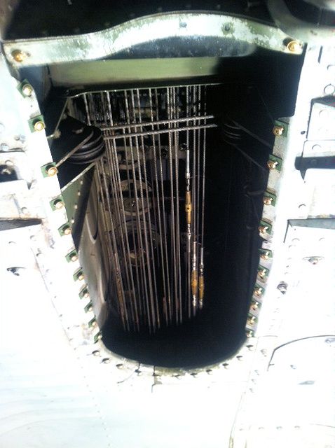

PostPosted: Mon Mar 10, 2014 4:46 pm
Posts: 2559

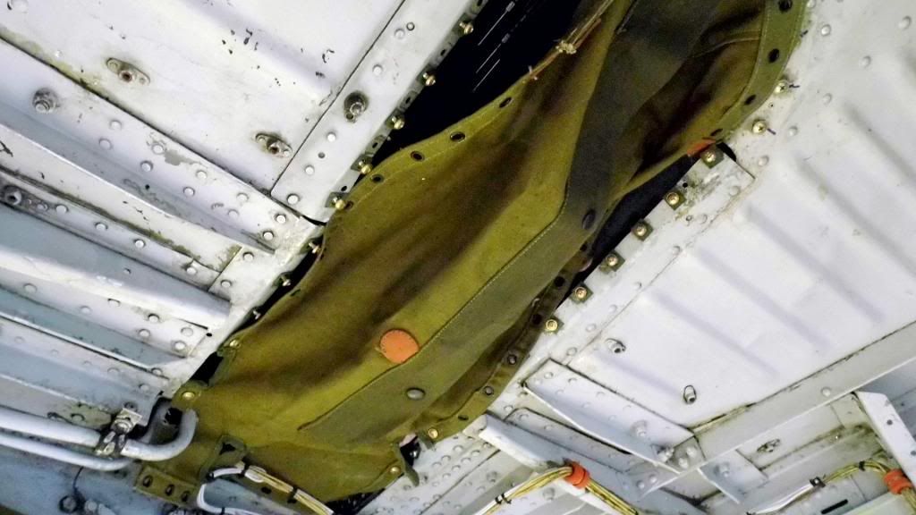

Ray has been prepping the nose wheel well for the boot we found that covers the access hole to all the control cables in the throttle quadrant. We were very happy to find the canvas boot as a NOS item. It was another one of those things made in the 60's that never left the box. BUBA needs one also, so we ordered one for it as well. Speaking of BUBA, rumor has it that it might come home from Brownsville by the end of the week. Everybody keep fingers crossed the weather cooperates. The next show will be at the JRB in Ft Worth on April 26-27 with the Blue Angels and many other notable performers. It is always a great show. Stop by for a visit and share your stories or interests in A-26's. JR

Here is the aforementioned boot that Ray has been working some late nights to finish. It is nearly ready to install, but we want to take it back off since a lot of work remains to be done in the quadrants and cables above it. This will save getting it full of dirt and crud. When the top is ready to close out, we will install the boot again. A big Attaboy for Ray ..AGAIN! Thanks for all of your hard work! :-) JR
