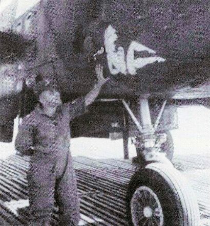

A little noseart never hurt a thang!! What you say it looks grainy and out of focus?? No, it is perfectly clear. You must be trying too hard to see the gal. If so, you qualify as an attack pilot!! Anybody recognize the pilot? :-) JR

That would be Jim Galluzi

Randy, you mean the Director of Maintenance, his ownself?? :-) Heard from him recently. He is enjoying life in FL. BTW, the way we know the engines were changed out.... the K model engines can turn 43E60 props while the stock engines run the smaller hub 23E50 prop as used on the A-26 B and C, plus the B-25 and several other airplanes. JR

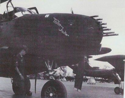

Another view of life at NKP with "Nother Trucker". Any guesses on who the 3 striper might be? Bueller, Bueller, Anyone, Anyone?? JR

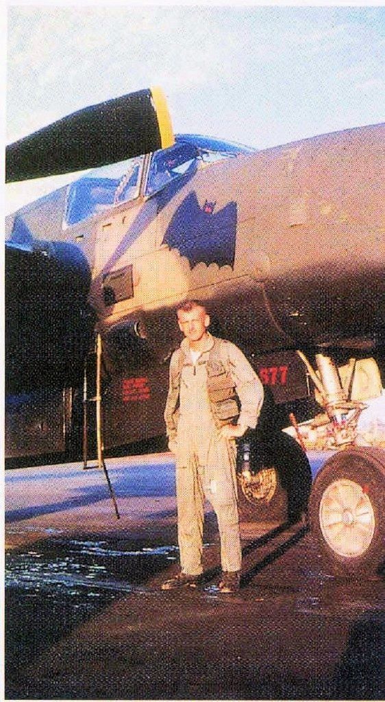

Looks like Batman, eh? This airplane, 677, is only 2 serial numbers away from K which is 679. The other things that show up well is the fact that Armament load panels had been introduced and the crew names were painted in red on the right nose door. Looks like the latter period of operations at NKP. It would be nice to find an original survival vest like this one for our cockpit display. So anybody know this troop?

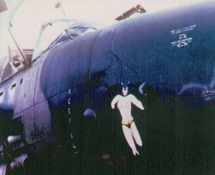

And where there is Batman, there must be Catwoman, aka Aircraft 64-17654 of the 609th Special Ops Sqdn, 56th Special Ops Wing, NKP!! I am assuming it to be Catwoman because my recollection is there was no Batwoman. And who could forget Halle Berry in her Catwoman outfit. Wow! That would make a very nice Valentine's present!! Not to become too distracted, back to the airplane, to the left of Catwoman is a red prop arc "Keep Clear" marking. Haven't seen that very much in other pics. There are also two external labels on the gun nose doors. Randy or Bob, any idea what these might have said? We found where the location, size and Part Number of all the external markings is located in the last chapter of the Illustrated Parts Catalog, howsomever, the markings themselves are not shown anywhere. Another dang mystery to solve if somebody can help us out with leads. The AF Museum did not label their K and we suspect they don't have the markings either. But we are digging still. Now where did I put my DVD of Catwoman? Hmmm, be a nice way to spend the evening! :-) JR

Well, the guy in front of 677 is Larry "Robin" Counts, Navigator.
As far as the markings on the gun bay doors on 645 or 654, which ever one it is, I don't remember them. It appears that the lower marking is over the hex locking bolt on the door, indicating which direction to lock or unlock the door. It may have been put on there to indicate a "Locked" or "unlocked" condition. It appears that a white horizontal line was painted across the door and bolt, probably so the crew could visually check it on walk around or something.
Probably are instructions above on how to access the guns. If I remember, there are also several Dzus fasteners around the door also in addition to the locking bars.
Here's a theory on why that may have been added. I heard that at some point, a A-26 landed at another base in Thailand one night, and no one there knew how to dearm the guns. Maybe they added instructions for those not familiar with this plane! I think the T-28 was the only other Air Force planes to carry the .50 cal. that I know of.
Batgirl. Later work of Alberto Vargas (Varga) Playboy July 1966

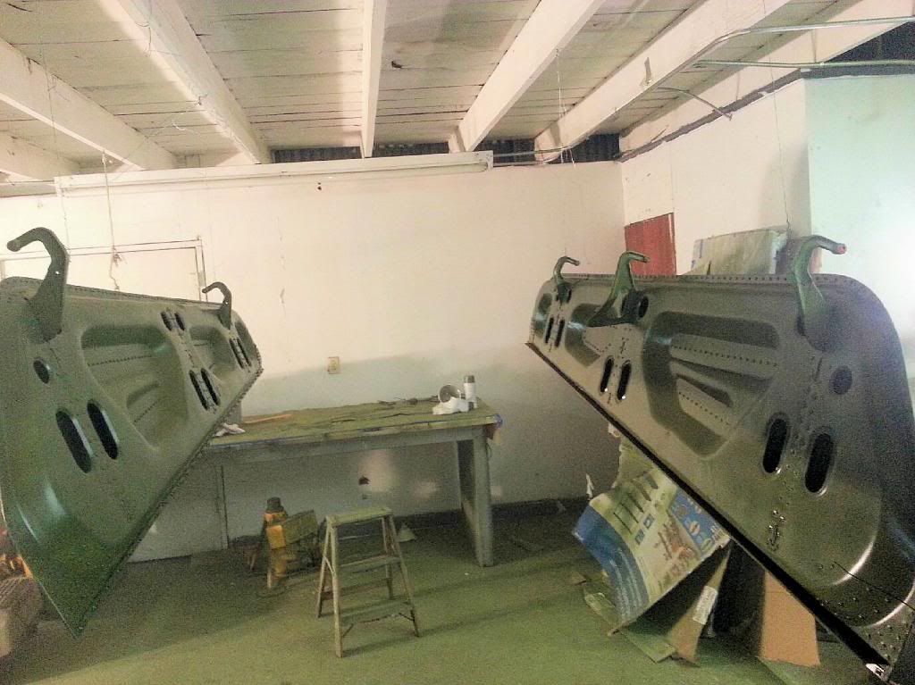

Today, Ray prepped the nose gear doors for primer while other folks worked on the aileron gap seals and the cockpit. Our crane, Ichabod, was also up and running again after much work by David A, Arnold and Jamie. We should be able to pull the left engine soon and start the repairs on the firewall from the old crash landing at Macon, GA. Couldn't have asked for a nicer day. 70 deg and light breeze out of the South!! JR

...and this is the "after" picture when Denis finished priming the doors. They should be ready to fit and mount next week, but we will have to check out the retract cycle on all the gear and we are waiting for one fitting to arrive for the left nose door. Keeping fingers crossed it comes in soon. JR
