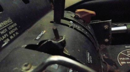

As I have sat in the cockpit of the B to get familiar with the different layout of switches etc, I noticed it has the same landing gear safety mechanism as K. The gear handle sits right under the throttles. On the ground, this pin pops up to keep the landing gear handle from being raised to the top and thus causing the gear to retract. When the weight is off the gear as in flight, with electrical power on, the pin automatically retracts and allows the gear handle to be raised. If the squat switch or solenoid doesn't work, it can still be overridden manually by pushing the pin in if it is absolutely necessary to get the gear up such as when an engine fails on take off. It's just a little procedure to remember when things are not going so well. I am planning to be on the crew when the CAF 26 goes to the Brownsville Airshow the weekend of Feb 22-23. Hope to see ya'll there. Come on by and say howdy. JR

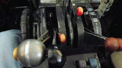

The earlier shot was a profile so this one is straight on. Throttles to the left (big knobs), Props in the middle and mixtures on the right. Below the throttle quadrant on the right are the carb air heat levers. The smaller redish knobs on single levers are the friction locks for the other levers so they can be set and then won't creep back under the vibration. The yellow button on the side of the left throttle lever is for radio transmit, but on the Enid, OK airplane, Lady Liberty, it will run the flaps instead. So it just goes back to the old saying. If you have flown one A-26, you have flown one A-26. Can have many configurations by the time they have come this far. Another gotcha is that the oil cooler door switches run just opposite between these two airplanes. Glad we got the automatic feature working on K so this shouldn't be much of a factor for us. There are no indicators except the oil temp gauges as to how far the doors might be open. Seems to me I once heard a fella say that a man has to know his limitations. Well, the B manuals have the airspeeds in mph and the K manuals are all in knots. Go figure. So that's why I am up late. Trying to study the limitations and need a break!! :-) JR

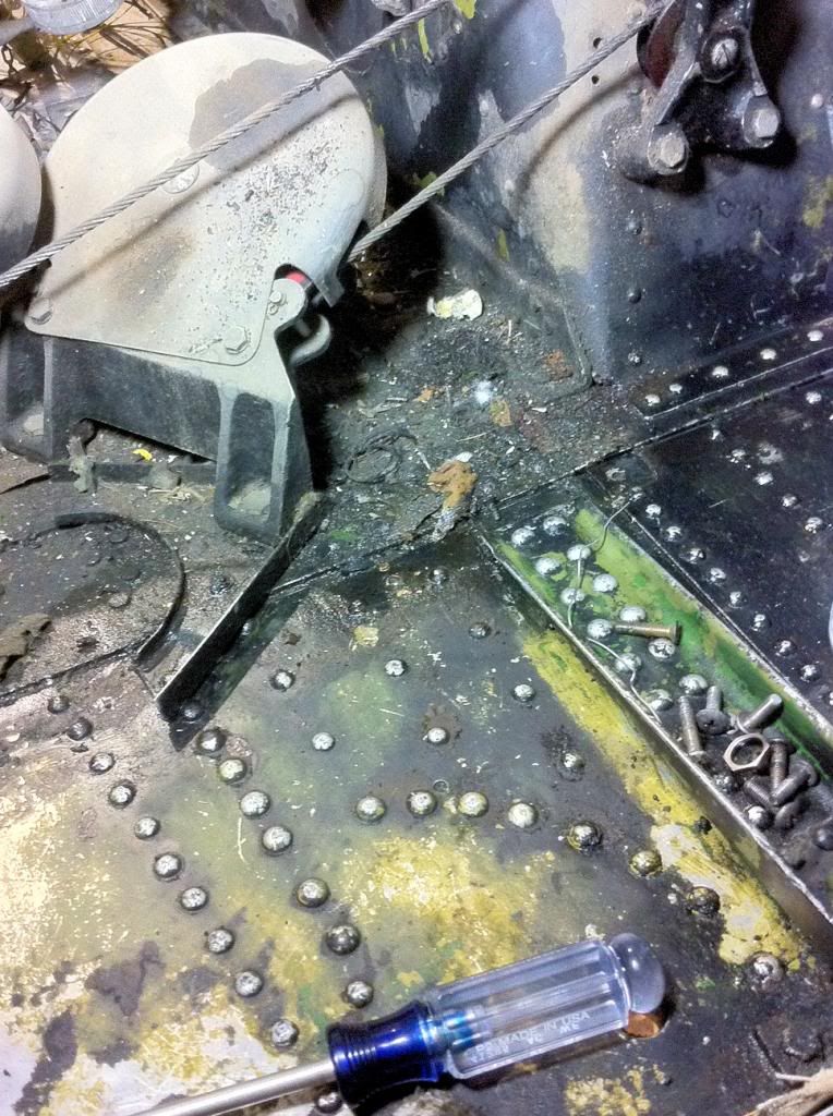

This past Saturday, much was accomplished, however, I have to admit I was not there to get the complete story. Picked up one of those bugs that just made me think I was going to die and then was afraid I wouldn't. Sheesh. Anyway, the gang did get more projects done. Here they are cleaning out the bottom of the cockpit in anticipation of paint. There was a goodly amount of FOD down in the bottom so they had quite a collection. The insulation on the right side of the cockpit needs to come off and be replaced with new that JR found. Then I think it should be about ready for paint. The other JR

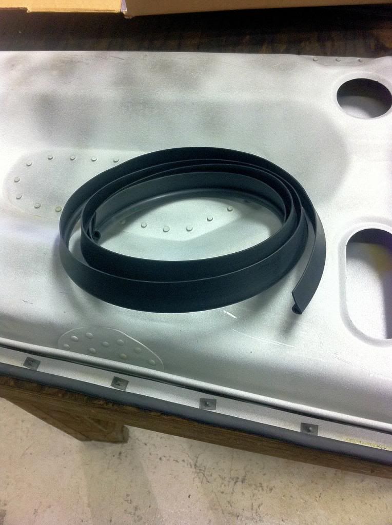

New nose gear doors have been walnut blasted, primed and new seals put around the edges. Can't wait to see them on, but we have to figure out what caused the problem in the first place before installing them. Chances are these are the last good doors out there that might be available. I'm sure there are some, but nobody is offering them for sale anyway. We don't want to take any chances. JR

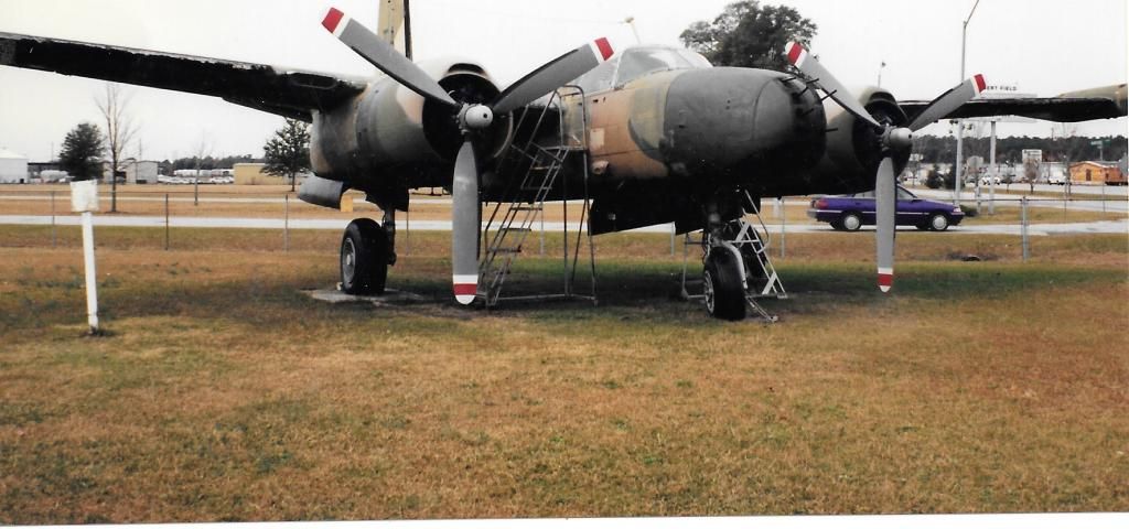

yessirr, that would be 676, one of the original 8 deployed to NKP. 671, which was at Florence Air & Missile Museum, was also on the original deployment. The first and second time I visited 671 at Florence, she had the correct props. The last time I was there prior to it being scrapped, I noticed that the props had been changed. A guy at the museum said that "the Air Force came down and changed out the props for the ones that are on it now." I didn't know they had changed the engines also. I was not aware at the time that 676 was being restored in Dayton. When the scrapping began, there was an effort underway to remove 666 from the concrete pylon at hurlburt and put it on its wheels. Apparently it had none. Somehow, and I never found out how this transpired, the landing gear from 671 was "aquired" for 666. Way back, I heard from someone that the gear was located in the C-123 in Hurlburt Air Park. 666 eventually was put on its wheels. When I learned, quite accidentally, that 671 was being scrapped, I made it down to Florence and salvaged some of what was left of it. There wasn't much left, and the trunk of a Grand Am wouldn't hold but so much. Proud to say I still have some pieces of it here in the "Nimrod Room".

This is how I found 671 when I went to Florence in June of 99

Here is 671 in better times.
These were taken at Florence the last one was the last time I saw it.

This is after the engines and props were changed. This was the last time I saw it in one piece.
