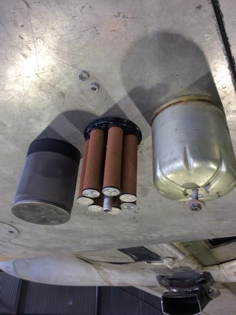

As part of the cockpit work, the instrument air filter was pulled and opened up. It appears to have not been opened since the late 60's. Wasn't in too bad of a condition though. It was cleaned and reassembled ready for installation. JR

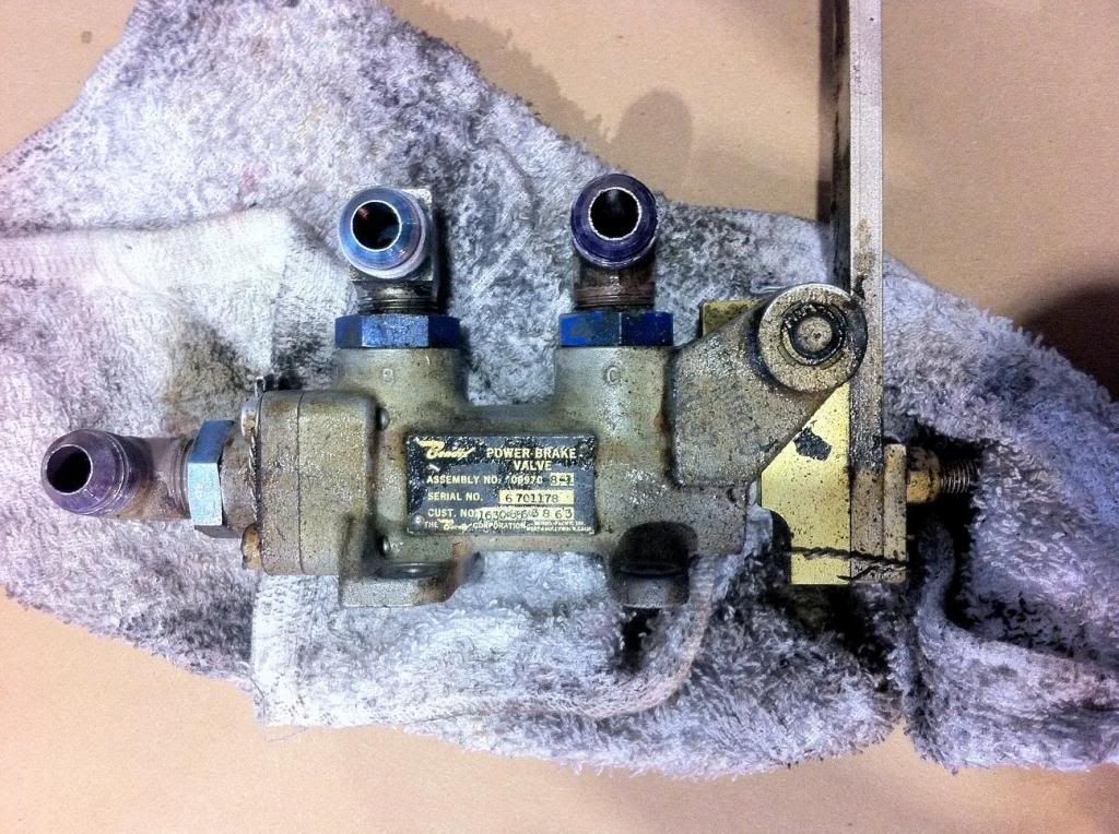

Another little pesky item that has been cleared off our to-do list, the brake valve assembly. This is a before shot. When we pressurized the brake system recently, the valve decided to leak. It was removed and disassembled for cleaning which will be shown in the following pics. JR

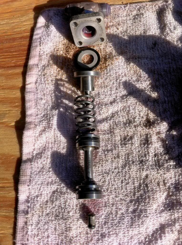

JR with a little help from his friends, cleaned up the brake valve innards and installed new seals. Upon reassembly and being filled with fluid, it didn't dare leak with JR standing over it with a big hammer. :-) JR

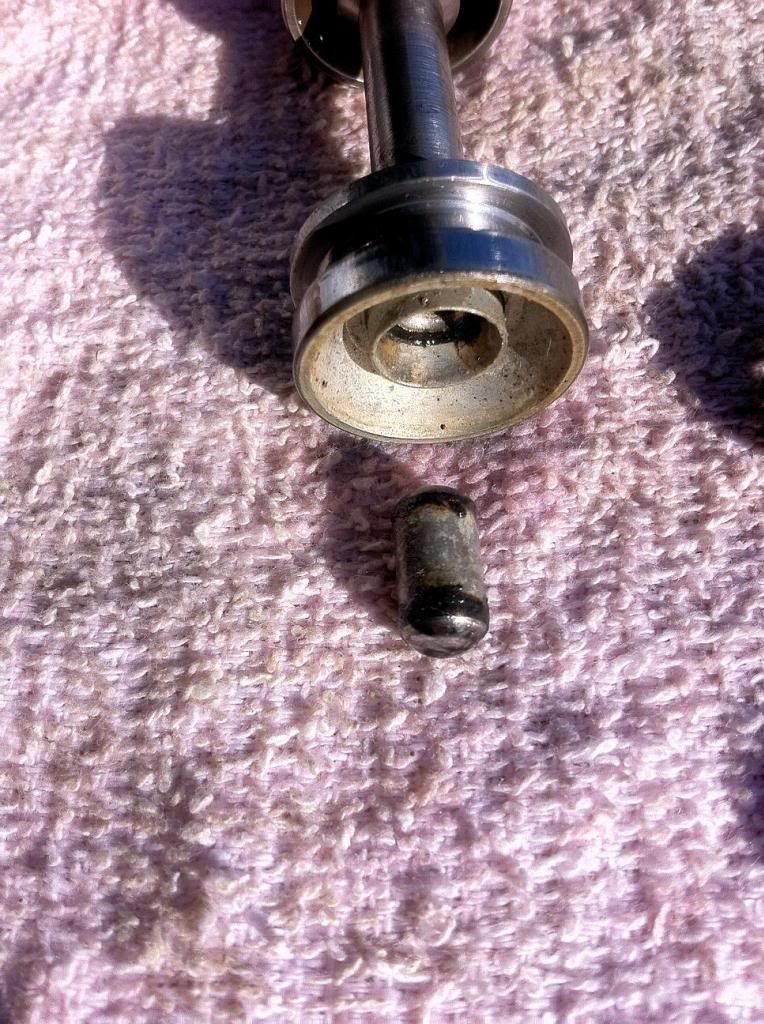

A close up shows that some spots needed to be honed and smoothed to make sure it all fit back together without leaks. JR got it done personally so thanks JR from the other JR!!

Ahhhh, it's a beautiful thang. David A got it installed this morning. Still no signs of leakage, but the true test will come next Saturday when gear swings will commence in earnest again. We need to get K steady on her own feet so we can pull the left engine to do a sheet metal repair on the firewall/nacelle. Thanks David for going above and beyond today. Rand was there helping clean up the fluid in the cockpit so kudos to Rand as well. JR

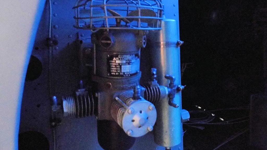

Randy, Bob D and all the other A-26 gunplumbers out there... how does this look? Forgive the blue tint as a blue tarp is kept over the doghouse area to keep it clean. Jamie finished up mounting most of the hardware and mil radios last Saturday. Just need some air lines to the nose and we are one step closer to going Wild Hog huntin out at the ranch, huh? The Ace Wild Hog Extermination Company rises again!!! JR

I'm still being amazed at the parts you are able to find. That compressor looks like the same one to me. As far as the air lines, I did see the gun charging solenoids are still in the gun bay, along with most of the gun charger lines running to the guns. I did see that some of them had the quick-connects cut off. The charging solenoids have a push-button on the back of them that we used when we did the initial charge on the fight line. That operation didn't actually chamber a round, but put one in on top of the breech block. I think the navigators took care of the armament panel during the flight, and when they charged the guns again, they were ready to go. We were always careful when we were working on the guns if someone was in the cockpit while we had the ground override switch on. It would have been possible to charge and fire the guns in that condition with the aircraft on the ground.

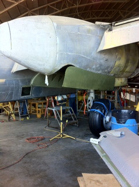

The right side gear doors are hung. The only remaining doors left to install are the nose doors. Some parts are having to be fabricated and some bushings found to complete the fitting of these. When the gear swings are done this weekend, we will check the fit of the replacement doors themselves with the nose gear up. This has been something of a setback, but we have been accomplishing other things while waiting for the missing parts to come in. Restoring this airplane is a little like being pregnant. Just have to wait for it to determine when it is ready to come out of the hangar! :-) JR
