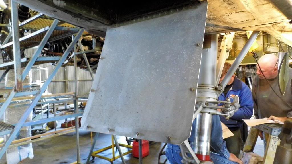

So this is what we found when we openeed the bottom nose gun door. Definitely looks like a post crash replacement. We may see if our magician Ray can do a better job with a new one later and/or place the AOA probe there if it lines up with the airflow properly. More cool stuff to think about it. Frozen in NJ, JR

I think I can definitely say that was not the original door.

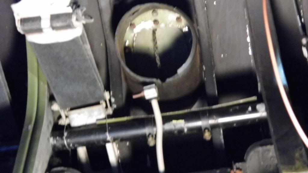

Was looking up to the top of the forward bomb bay and noticed the big round tube like structure for the first time. Just happened the area was lit up since the guys were working on the bomb bay door actuators. The wide black straps were used to support the forward bomb bay fuel tank. It had a 125 gallon capacity but was not filled more than 100 gallons. Beyond 100, it could vent fuel during acceleration which could be ignited by the operation of the electric flap motor nearby resulting in a possible explosion. Now, back to the tube like structure.... Randy, did that have anything to do with fueling this tank? If not, any idea what it was suppoed to do? JR in the frozen north.

........ Randy, did that have anything to do with fueling this tank?
I don't have a clue what it is. I'm pretty sure it didn't have anything to do with the armament system. I remember seeing those bombay tanks before they were removed, but really didn't pay any attention to them. Lindsey Jackson would probably know what it is. Bet you wish you were back down south, eh! 38 degrees here seems like a heat wave compared to the -4 we had earlier this week!

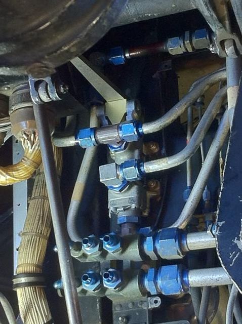

JR reports another productive day today. I was sorry to have to miss it especially since Hawkeye fixed lunch. David and Rand fixed the hydraulic leak in the brake control valve that was discovered last week. We keep discovering little details like this that must be dealt with before we can take the next step like install the instrument panel. On another note, heard from Tim Black that the Air Commando Association along with the Nimrods are planning the next reunion in Ft Walton Beach, FL, the weekend of Oct 17th. We would very much like to have K ready to make her debut there. The race is on!!! The other JR, gettin wet in NJ....
