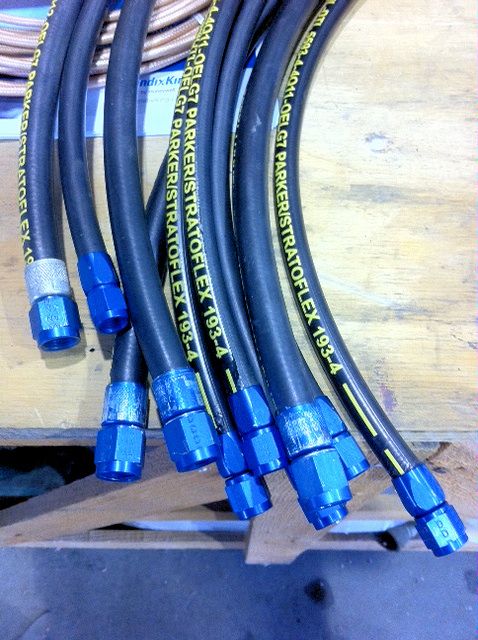

Glad to have Big Mike back from Alaska as well. He made up all new vacuum hoses for the cockpit this week. That is just one more big step before re-installing the instrument panel. Oh, the other big news for the week, Bendix King said they are interested in helping with the installation of their KLR-10 Lift Reserve System. Wow, be nice to have some form of stall warning system on the 26. This sounds ideal, but where to place it will be the big question for their engineers. :-) JR

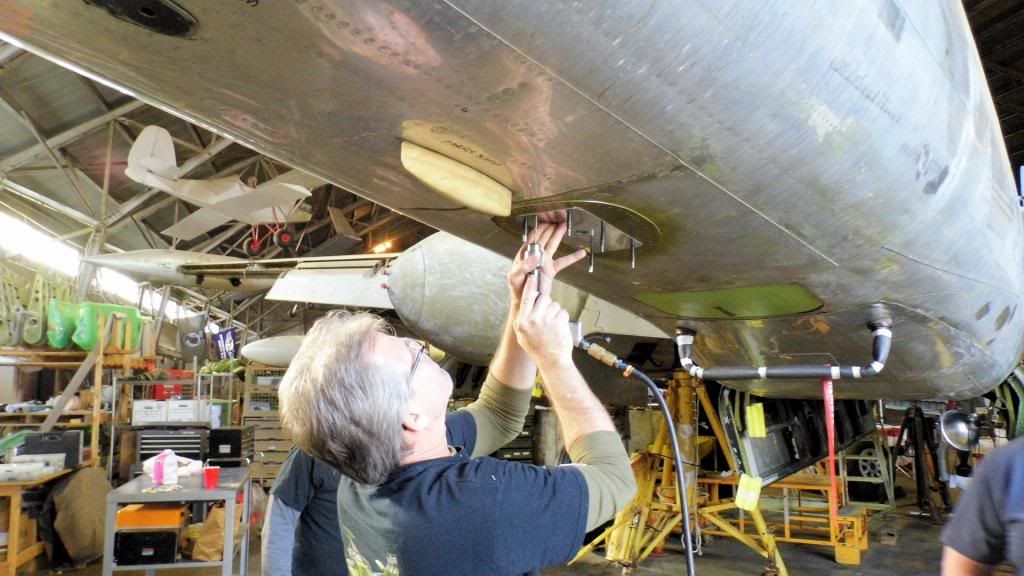

Ray is building a doubler for the installation of the VOR antenna. We found an original antenna out in Florida so Ray thought we needed a doubler plate on the inside of the mounting plate to make sure those high speed passes at airshows don't break it off.... drool drool.... slobber slobber.... can hardly wait to do that and blow up stuff. EEhaw, the wall of fire routine just is so impressive!! Just hope we don't burn up the airfield like a certain Oscar Deuce driver we know. :-)

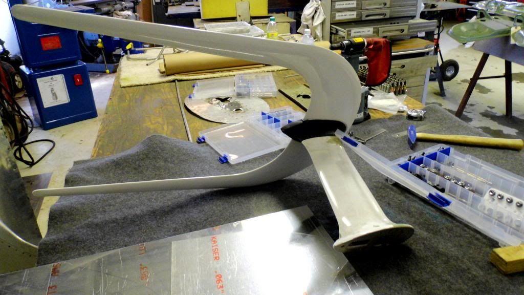

Here's the antenna from the previous post. JR

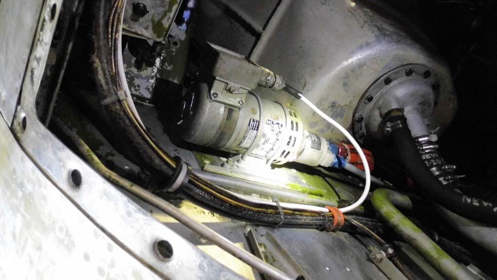

Here is one of our pesky hydraulic leaks. This is an aux hyd pump driven by an electric motor that was not present in the stock WWII A-26's. It is capable of running the system in the event of both engine driven pumps failing. Then below this level is the hand pump. JR took this all apart and replaced the seal between the electric motor and the pump, but fluid leaked again so there is some kind of problem in the drive shaft area to the motor. Better to find it now than later, we reckon. The other JR

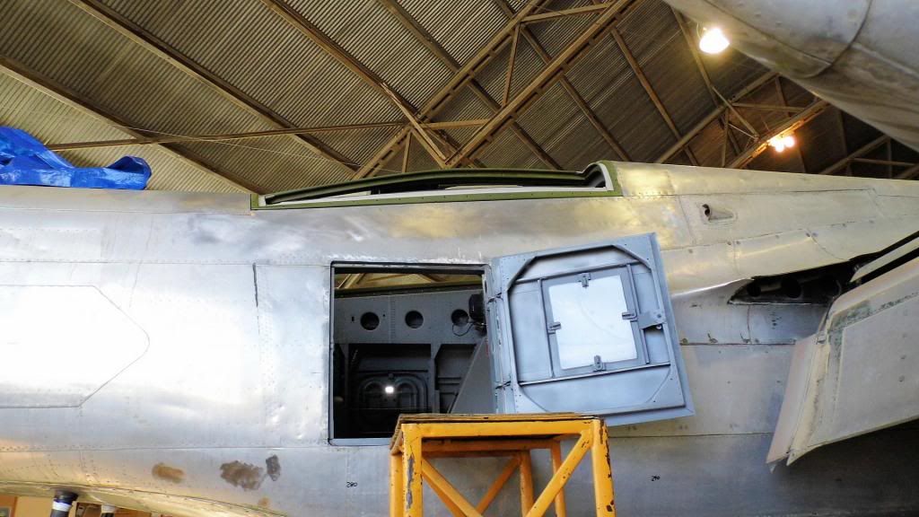

Notice anything different?? Yep, the doghouse canopy is now in place. When Jamie gets thru installing the old mil radio gear there, we will install the new glass we have for the side panels. Starting to look like an airplane again with the elevators hung and the doghouse covered! We also got our new nose tire mounted and the wheel installed today. This gives us three good legs. Getting closer to the day we can lift the left engine off to work on the nacelle behind it. JR
PostPosted: Sat Nov 30, 2013 9:27 pm
Posts: 2563

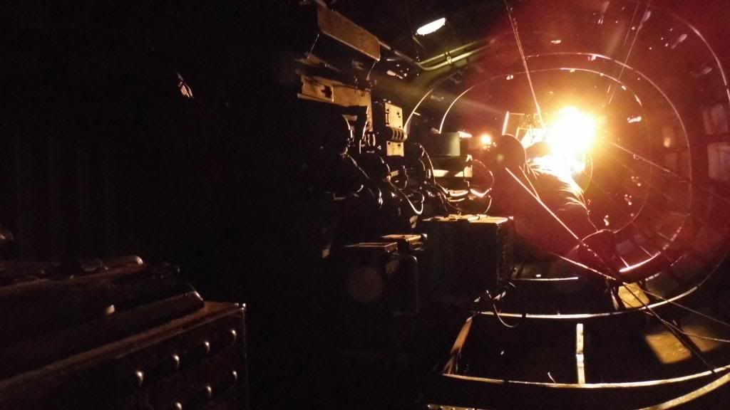

Here is a little closer view of the rear gunners area or "doghouse" as we call it. Most of the old nav radios are installed. The intercom wires have been run and now Jamie is cleaning up the old oxygen lines. With a ceiling of 30,000 ft in the book, we kept wondering why until it dawned on us that the airplane was used for mapping and hi alt recon photos. Duh... what were we thinking. The Nimrods and others told us they never used the oxygen system except maybe to test the theory that breathing 100 % oxygen would relieve certain headaches, but they were always at fairly low level looking for trucks to make flat. All K's were delivered with two noses.. glass and solid so they could do either job. JR

Are you saying that you didn't replace the shaft seal on the pump and only replaced the gasket between the motor and pump? I am a retired "bubble-chaser" (name given to hydraulic mechanics and referring to the bubbles that are on the id tape on hydraulic lines) and have fixed many pumps in my time.
I am not sure what type pump this is exactly but most had a replacable shaft seal that could be replaced back there and some kits may still be available. Some kits came with a special rounded plastic knob so you can put the seal in without damaging it when going over the end of the shaft (you first have to remove the splined shaft that goes up into the electric motor by popping the lock ring out) However, sometimes there is wear on the shaft where the seal rides and you might not be able to do anything but have it rebuilt with a new shaft. It shouldn't be that hard to fix otherwise. Woodie

Woodie, everything you suggested has been tried as far as seals go. The problem is that this particular hyd pump is not on the 1965 airplane and was one of those substutions made because the original was not available. We have searched all of the internet data bases for inventory and can't even find a shop to overhaul it, much less a kit so that we could do it ourselves. So now, we have to try one more time with new seals and see what it does while looking for another substitute pump. Who woulda thunked that would have been a problem. Just another small issue to solve, but I have every confidence that JR will figure it out. Thanks for your input. The other JR

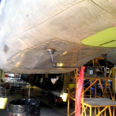

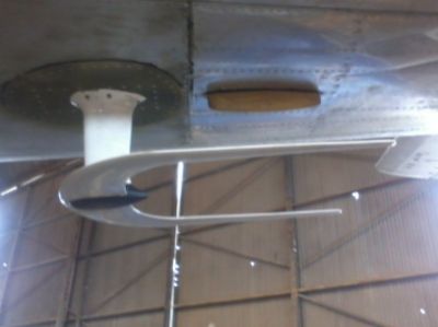

Ray got a trial mounting of the VOR antenna on the dorsal ... or is it ventral side of the empennage? I can never remember the proper term. Don't have the Duck Driving Lady around to correct me. Anyway, Ray got it on the airplane to see how well his doubler on the inner side works and so far it is looking great. He removed it so that nobody would run into it since we aren't used to having that antenna there. Somebody would no doubt poke one end in the eye. It is kinda like my mother telling me to never run with an open knife, carry scissors in my pocket or shoot my BB gun at anything or anybody OR else. I got the OR else more than once before I learned. :-) Looking good, huh? JR
