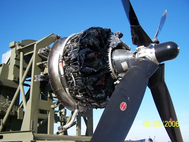

Gulf Coast Wing now has an Engine Test Stand.
I have spent the past few days dis-assembling, grinding, sanding, dodging wasps, and generally trying to beautify the beast.
We still need a test club, but we know where an expensive option is.
The stand was originally designed for an R-985, so we are having to beef it up a little and add some instruments that the original cell didn't have.
The idea is to run the engine(s) for about 5-6 hrs and make certain that the main and rod bearings haven't decided to discombobulate due to electrolysis while sitting.
The engines have all been turned with an oil pump on an external cart lubricating the bearings and marvel mystery oil (tm) shot down the cylinders to keep the rings happy, but there was a time after the initlal shut down of the airplane that they sat.
And sitting is BAD!

PostPosted: Mon Jun 23, 2008 4:25 pm
Posts: 4468
SPANNERmkV wrote:
...We still need a test club, but we know where an expensive option is.
SPANNER
Why don't y'all just use the props that go on the airplane? That's what we're going to be doing with the B-29 engines on Testiclese.
Just curious.
Gary
PostPosted: Mon Jun 23, 2008 5:29 pm
Posts: 1275
Location: Houston, TX
Because...
The four props are zero timed rebuilds.
If we use them on the test stand the clock starts on re-inspection.
WE are possibly 9 mos to a year out on flight and we don't want to use up that "time between overhauls" with the props just sitting.
Conversely, we want to know if we have engine probs. sooner, rather than later, so if we do, they can be addressed while we finish out the airframe and sub-systems.
And LASTLY... our stand isn't as high as Testicleese... it will not accomodate a full size prop., but it will accomodate a test club with a smaller diameter.
This is all necessary because a certain wanker in Midland wouldn't loan us Testicleese! :butthead: :rofl:

Test clubs are better for engine cooling than propellers too.

Don, it's probably just as well that you can't "borrow" Testiclese--it would cost thousands in fuel to transport him to Houston and back at todays diesel price! :ouch: He is one massive piece of '50s engineering.
Scott
 Post subject: TR
PostPosted: Tue Jun 24, 2008 1:25 pm
Posts: 741
Location: Burleson, Tx
Yep, it's a big mass of metal.... looks even bigger with the 3350 and prop..... Alan
