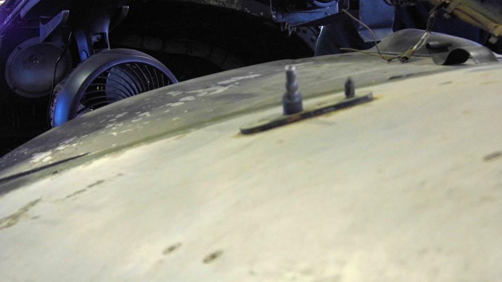

A26 Special K wrote:
Ok, so here is the stumper of the week. What does the taller of the two projections do in this shot? It's easy once you figure out where it is. Even the Duck Driving Lady could get it, I bet. :-) So how about this one? JR
It's the attachment post for a windshield wiper arm. From BUBBA'S Team-Winchester
PostPosted: Thu Nov 07, 2013 5:57 pm
Posts: 2559
Yup, attachment post for windshield wiper arm is correct. Oddly enough, the wipers are hydraulically actuated. We have the blades new out of the box... dated 1965! Not very many airplanes have that hydraulic arrangement. JR
PostPosted: Thu Nov 07, 2013 6:09 pm
Posts: 2559
As can be seen, most of the hydraulic lines and electrical wiring runs back on the left side of the fuselage. This area is covered by armor plate, but it is relatively easy to remove....if you remember it is heavy before undoing the last fastener! :-) It is still quite a chore to pull new wire thru and out to the wing. But we have been mulling over the installation of an angle of attack indicator on the wing since there is no stall warning system on the airplane other than "WHAM", "Awwwwk, here we go....grunt.. oh @$#!# hang on... what was that? Ewww, owww!" Typical remarks from the pilot and copilot during and after the event. :-) Any recommendations for AOA systems? JR
