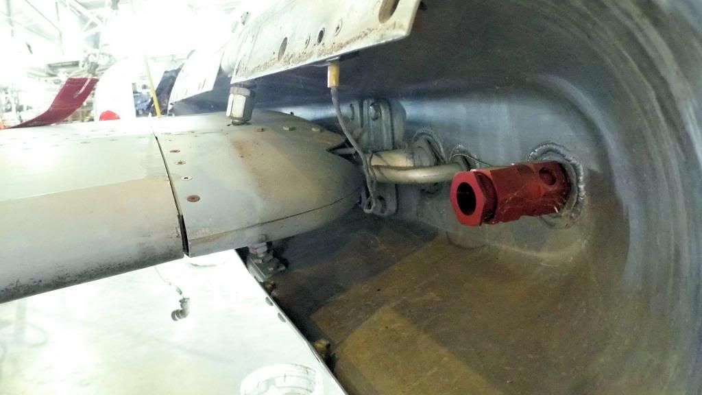

Mystery photo of the week. What is going on here and how does it work?? JR
PostPosted: Sun Nov 03, 2013 9:31 pm
Posts: 2673
Wingtip fuel tank attachment?

PostPosted: Mon Nov 04, 2013 4:23 am
Posts: 1635
Location: Belgium
Yup, tiptank

PostPosted: Mon Nov 04, 2013 6:21 pm
Posts: 2563
Dean.. Fouga.... yall were on the right track, but you didn't answer all the questions. Yes, it is a tip tank. But what kind? And how does it work..... you see, we noticed that our neighbor's T-33 has 230 gal tanks which coincidentally is the same amount for the K's drop tanks. If yall had told us how they can be detached, we might have been able to "borrow" them. Unfortunately, the window has closed as our neighbor is working really hard on it getting ready for an annual inspection and a return to flight. Oh well. :-( Disappointed in Texas, JR (will just have to work harder to stump yall)

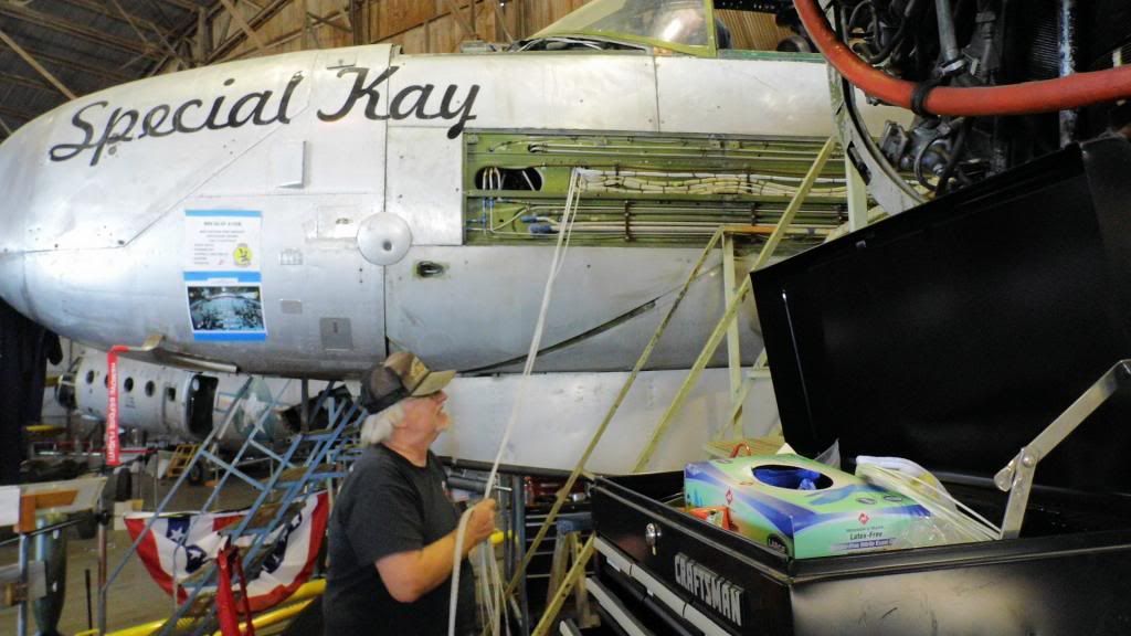

The avionics guys are going wild with new wiring all over the place. Larry is seen here pulling the wires in for the new intercom system and pushing them out the left side for Stan to pick up and pull out so they can be routed to the aft compartment, ie, the doghouse. We plan to put outlets for the cockpit, doghouse and the avionics bay so that the crew chief can get comm from the outside during engine starts. Fancy, huh?

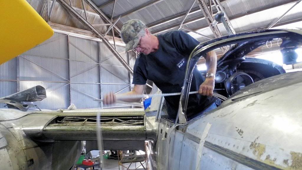

Posts: 2563
Stan is pulling wires out from the cockpit as Larry feeds them in this shot so they can be run thru the regular wiring bundles under the armor plate. These again are for the intercom to the back compartment. JR

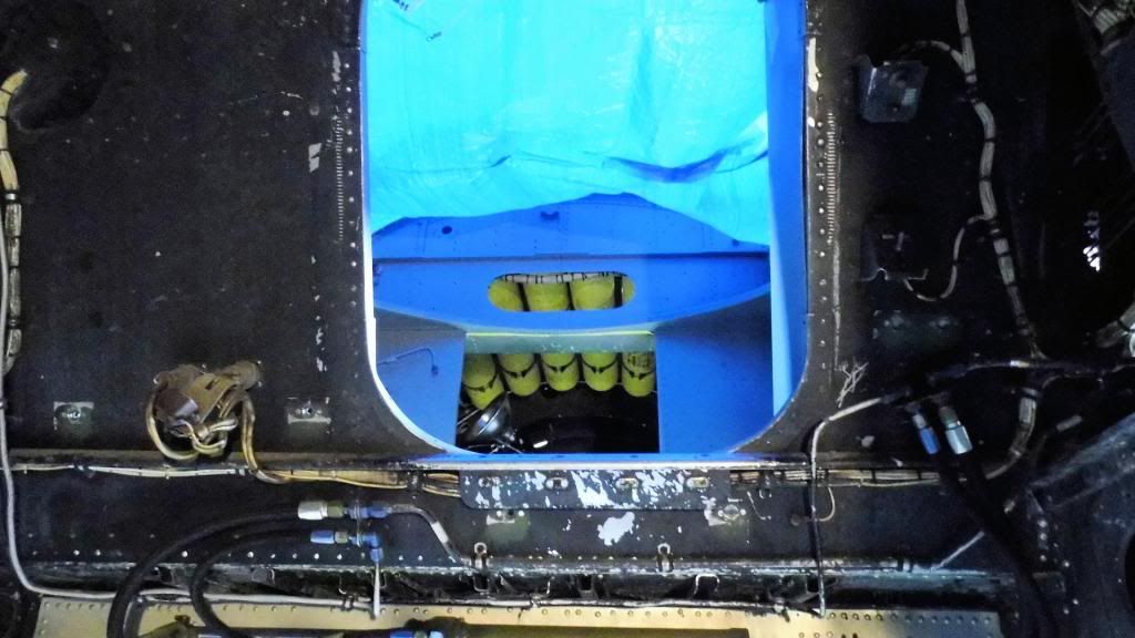

Posts: 2563
With the new gray paint in the doghouse and a blue tarp over it, it lends an eerie color to the doghouse. The oxygen tanks are located in the top of the fuselage and almost seem to be glowing green. Wonder if this was an effect left over from Halloween? Could it be Broomrider One's work? :-) JR

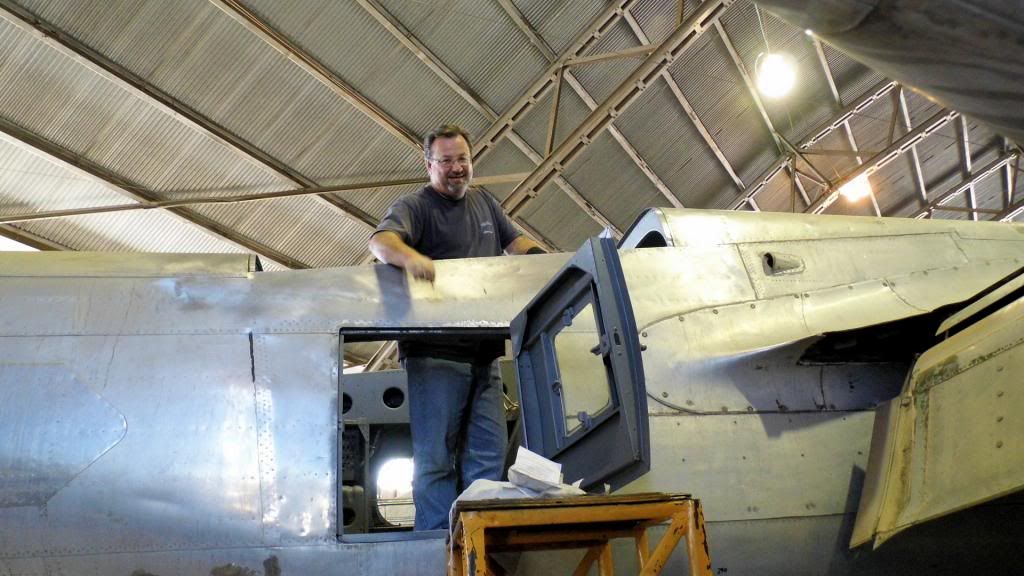

Posts: 2563
Jamie, David B, JR, and Scott have all put in a tremendous amount of time in the doghouse, the real one, not the one that wives and others with evil intentions seem to put us in quite often :-) ..... now, where was I? Oh yes... They cleaned and stripped all of the masking tape from the paint job which was no easy task after it had been on there so long. Then the existing wiring was cleaned and basically made to look new again. This included all the cannon plugs, etc. We have all the old radio gear to re-install and then we can put the gun charger compressor and tank with plumbing in. Along with this, the oxygen blinker and plumbing was cleaned up and made ready to go back in. The fuselage door was painted and re-installed as well. Who knows maybe we will be able to install the top canopy toward the end of the day this coming Saturday. Yall drop by and see. The other JR

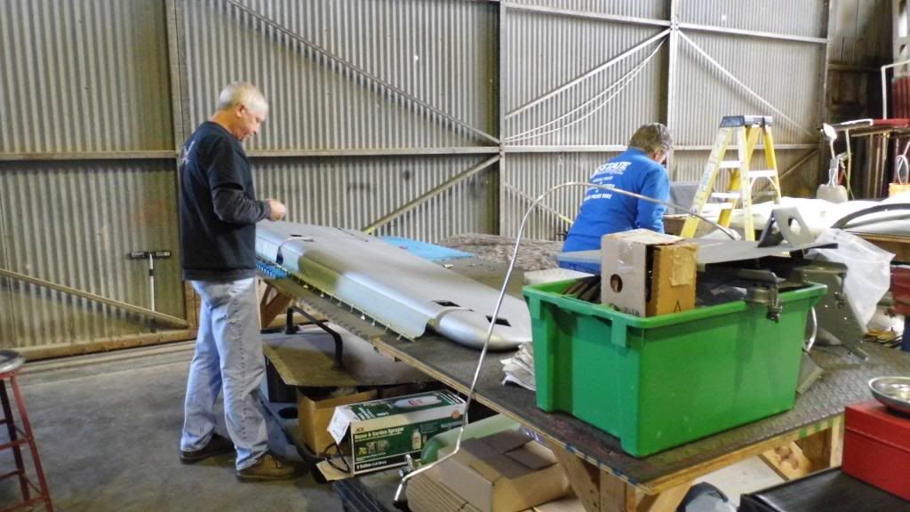

Posts: 2563
On the other end of the airplane, Big Tim and JR worked on the elevators getting them ready to hang on the stabilizers. This sure will start making the airplane looking... well, like an airplane again with the tail feathers in place. Part of the hold up has been the building of the gap seals for these. The other JR
