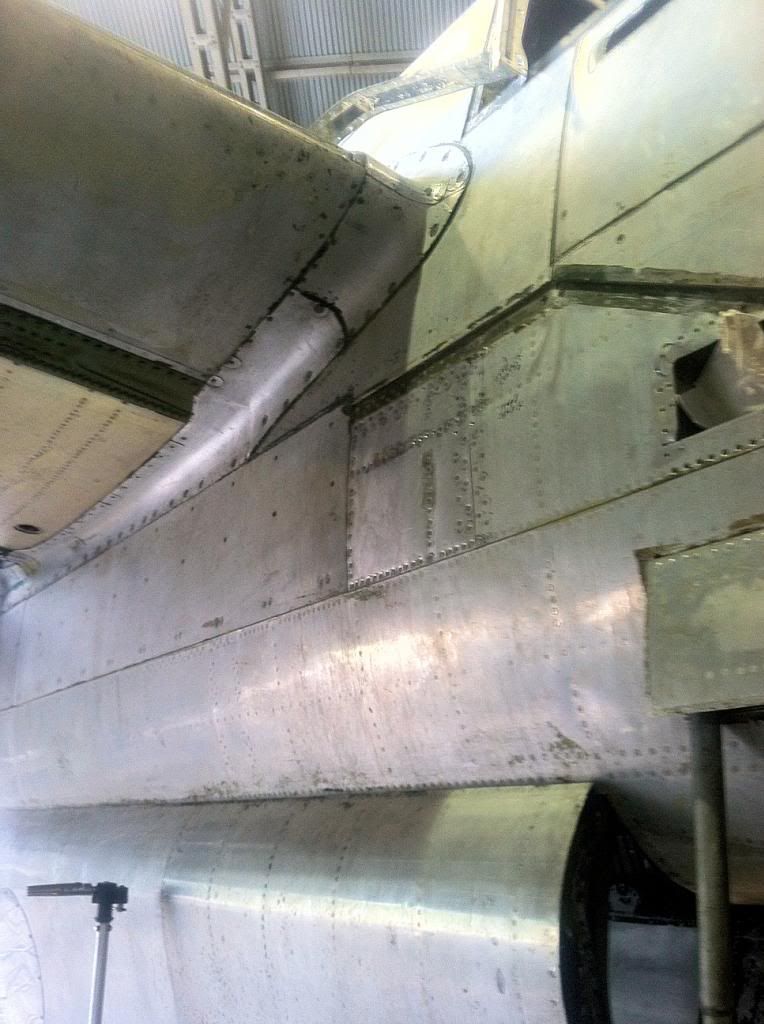

Lou and friends made the repair to the side of the fuselage where the FOD went thru during the crash landing back in the Georgia days. It nicked an underlying fuel pressure line and we were just lucky it never started leaking. So this repair is close to being finished. One less hole to patch. This may be compared to eating an elephant. Just have to do it one bite at a time or it would be overwhelming. :-) JR
Last edited by A26 Special K on Sun Sep 29, 2013 10:22 pm, edited 1 time in total.

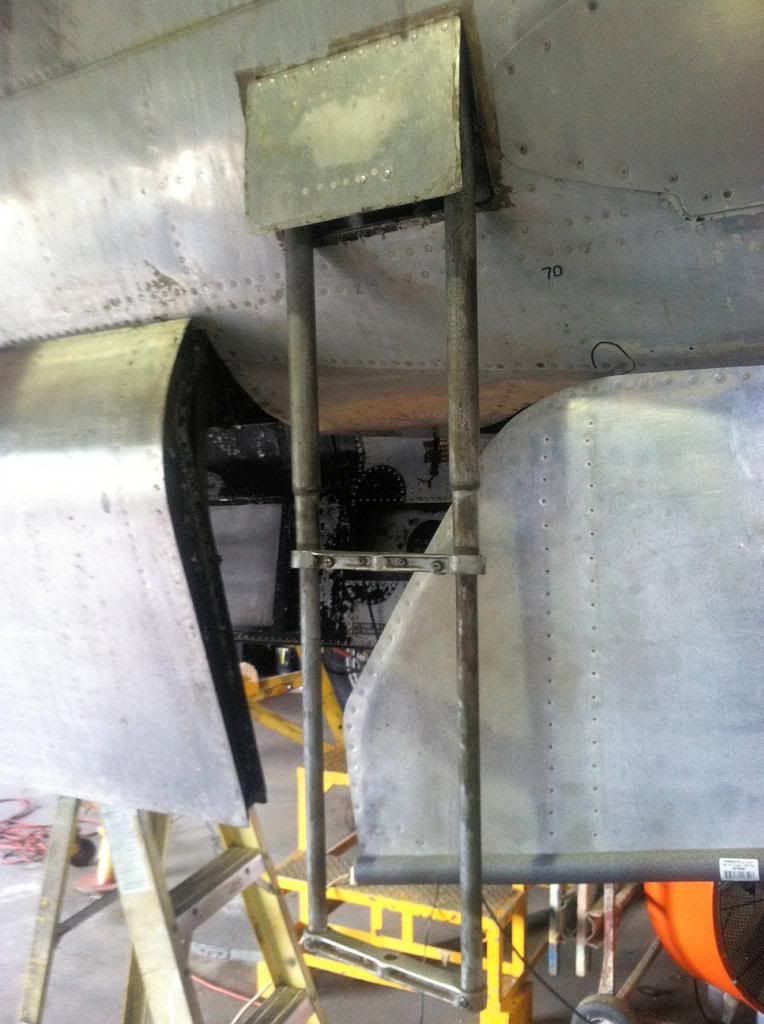

Here is the crew entry ladder that we talked about earlier. It appears to have been painted red at one time. Do any of our Nimrod guys remember what color it was back in the day? Be nice to go back original. Thanks, JR
