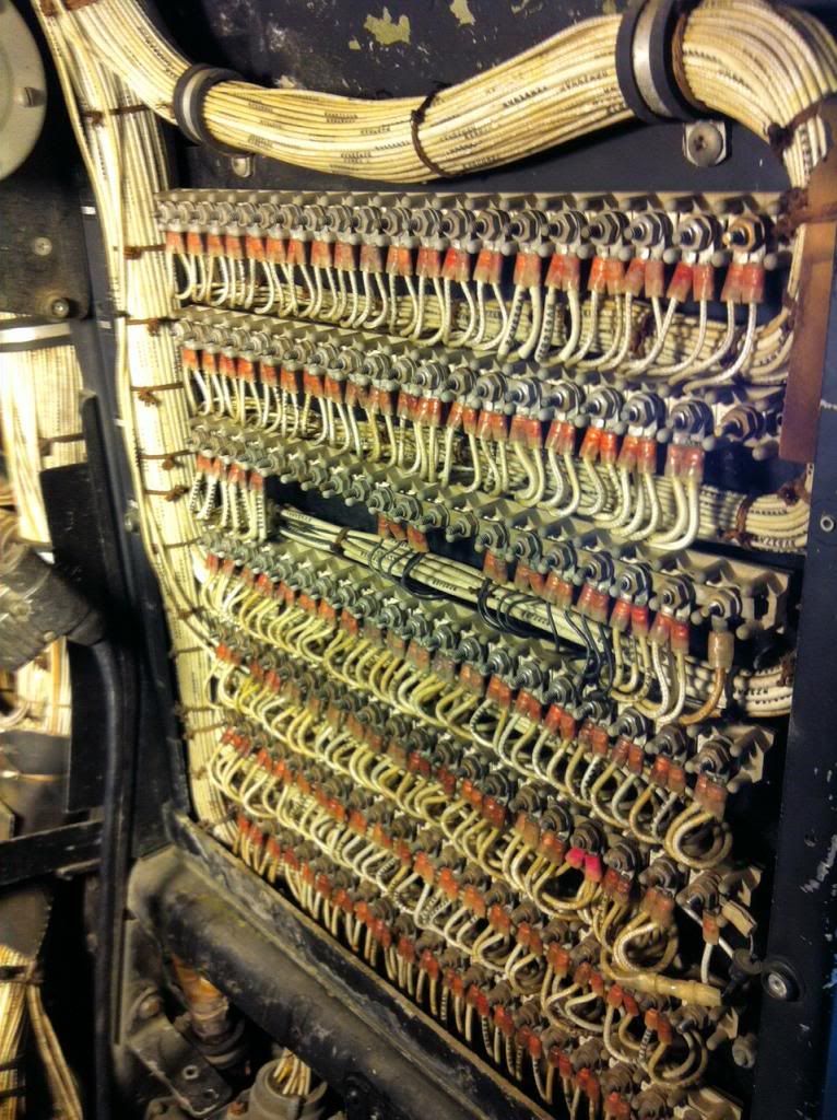

While our avionics guys are waiting for the wiring harness to come back from the shop, they have been chasing down the existing wiring and cleaning up the CB panel. Rand has put in a lot of effort to clean up the wiring while Larry and Stan are engineering the instrument panel installation and trying to get the engines instruments to talk to the engines. Our latest overhauled instrument, the OAT gauge, came back from Century looking brand new. Those folks have done some nice work for us. It appears though that we will have to find another vac powered turn and bank indicator for the co-pilot's side. The ball works but the needle does not. Also need a new vac gauge. It's always something, huh?? :-) Jr

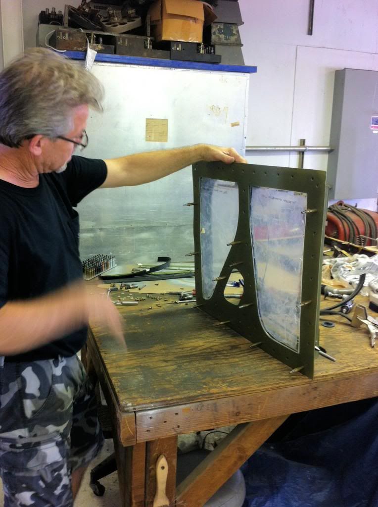

Ray was putting some of the finishing touches on the escape hatch for the doghouse canopy today. The glass is installed now in the hatch. He left the protective covers on so they wouldn't get scratched for those with keen eyes who are wondering why the glass looks opaque. He cut the seals out for the long glass installation in the canopy as well. Looks like these glass panels will be ready to go in place next weekend. There are a few blemishes that need to be polished out so maybe somebody will get a chance to do that soon as well. Moving right along now that Jaime has removed the radios from the doghouse area and just about has it ready for the gray paint we talked about last week. That will be good to finish out an area so that it looks new. Just need to come up with seats for back there now. Pipe in some stereo tunes and it could make for a very nice, comfortable ride. I think Larry is working that in as part of the intercom system!! :-) Ok, so maybe that isn't period. We promise not to play it while on the ground at a display!! OK? JR
