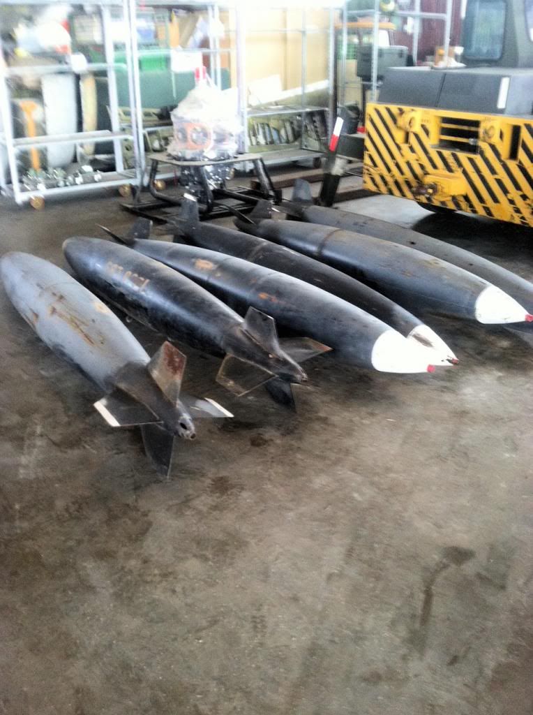

Posts: 2563
Just received these in the hangar. Need some TLC, but should be easy to get all spiffy and a good coat of paint applied. Randy... Bob D... what colors should we use?? :-) How about Easter eggs?? :-) JR

Location: Florida/California
Paint the bombs medium OD. Paint a 3" blue band around the nose to indicate that they are inert. (A three inch yellow band indicates High Explosive (HE). Here's a link to a pic of the way we got them. By the way... since they were already OD, we did not paint the bottoms for night missions.
http://www.nationalmuseum.af.mil/shared ... 4O-009.jpg
Bob
P.S. The ones we got were not always as "spiffy" as the ones in the pic. Ours were kinda grungy, but the pic does show the correct color.
Bob
Bob
Thanks Bob, good shots. Now we need to investigate proper placards, etc. Would like to make some replica fuses for the noses. About painting blue on the nose... well, to be technically correct, we should do that, howsumever, we think yellow is a prettier color!! I don't think it would upset anybody. Very few would know what it meant anyway except you guys. It just looks cooler. It would be great if we had replica fuses and all the wires so that you and Randy could show how it was done to load one of these hummers. Make a great video for Hawkeye to shoot. I found some old footage from back in the day. Fascinating! Did you ever think about things not going like they were supposed to go? These weren't firecrackers yall were playing with. JR

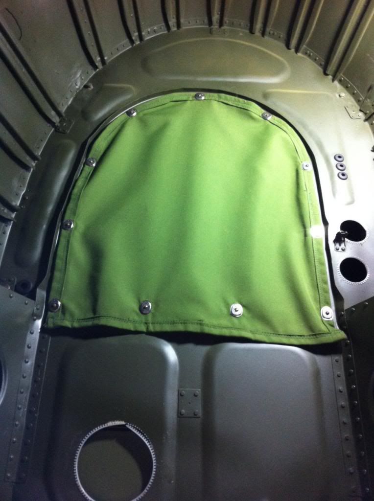

Posts: 2563
We put the ends of the nacelles back on in preparation for moving outside for the upcoming hangar dances and AOPA Summit at Meacham in October. Thought we would try out our pattern for the canvas curtain that separates the wheel well from the back of the nacelle. Needs just a little bit of adjustment, but that will part of the detail work we will have to do later. Should keep the birds out for a little while. Besides, I just like the picture!! JR
