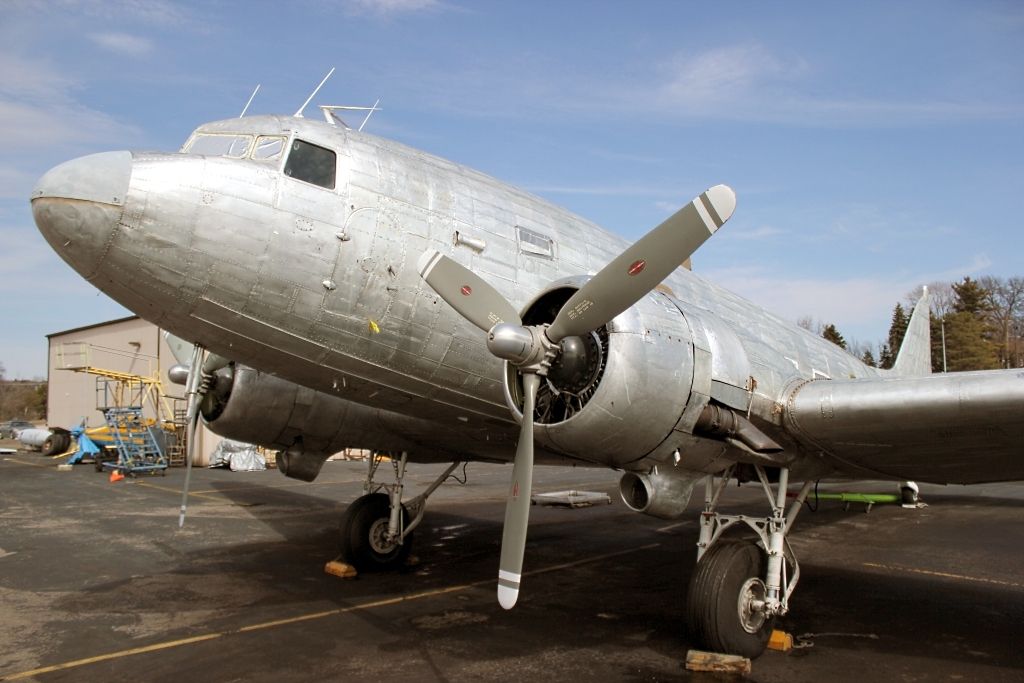

I personally can not wait to retake these shots from the same angle and see the nose art on the plane once again!

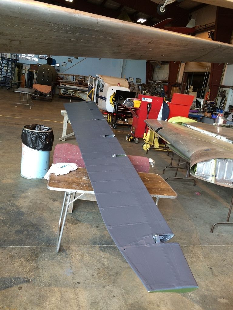

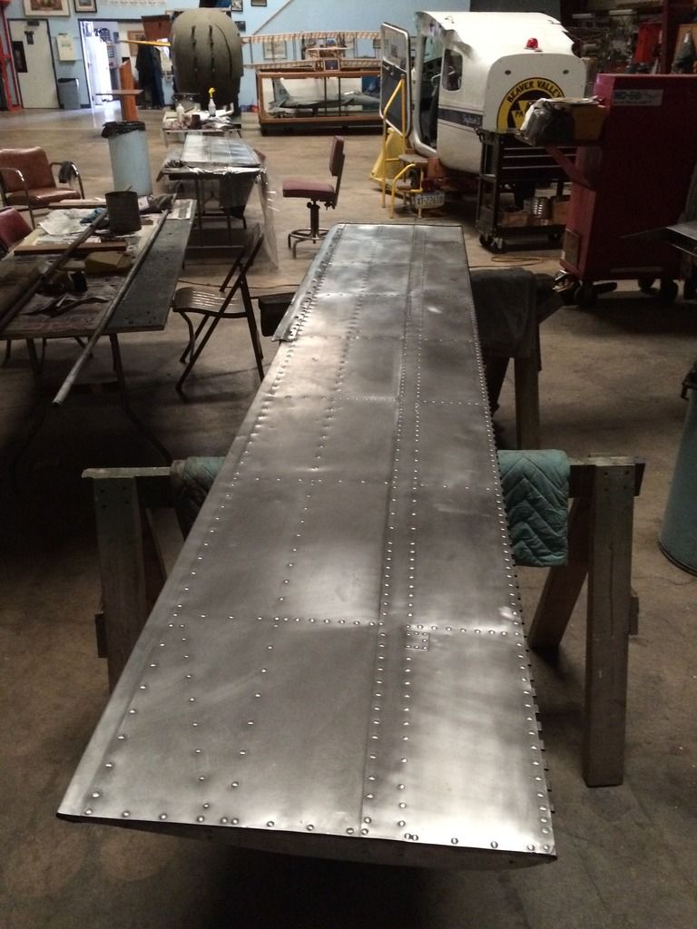

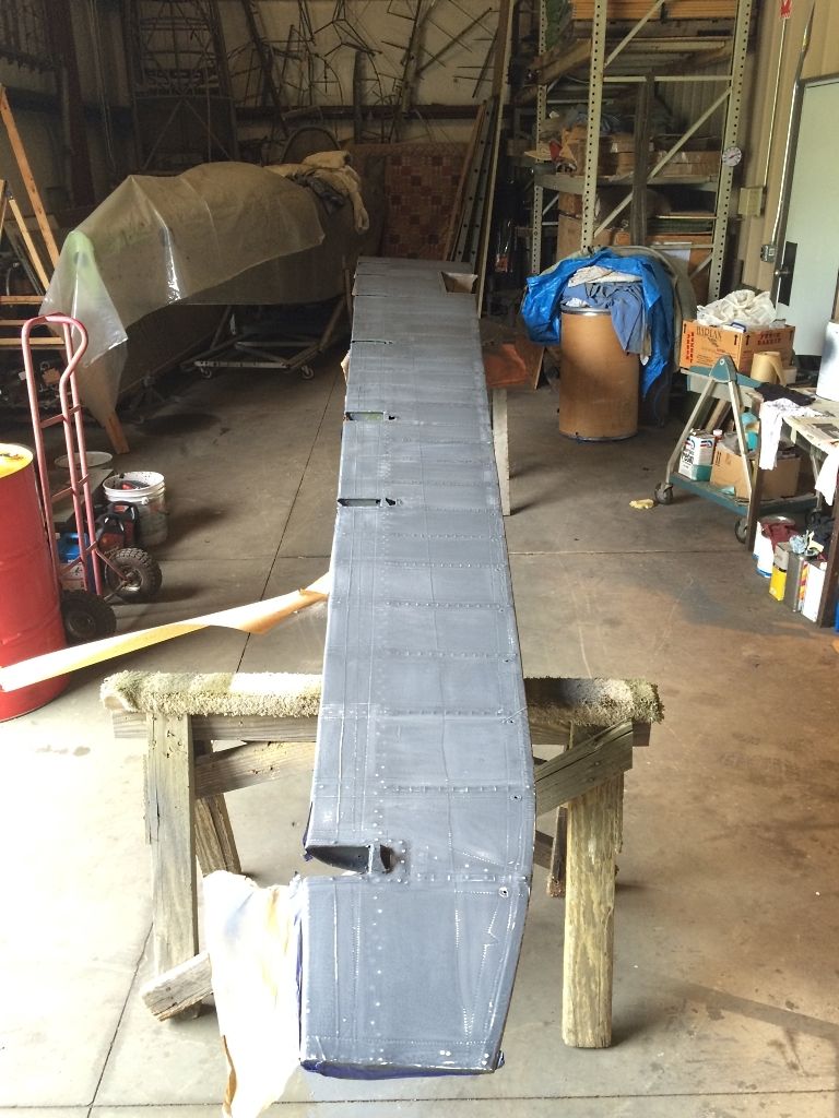

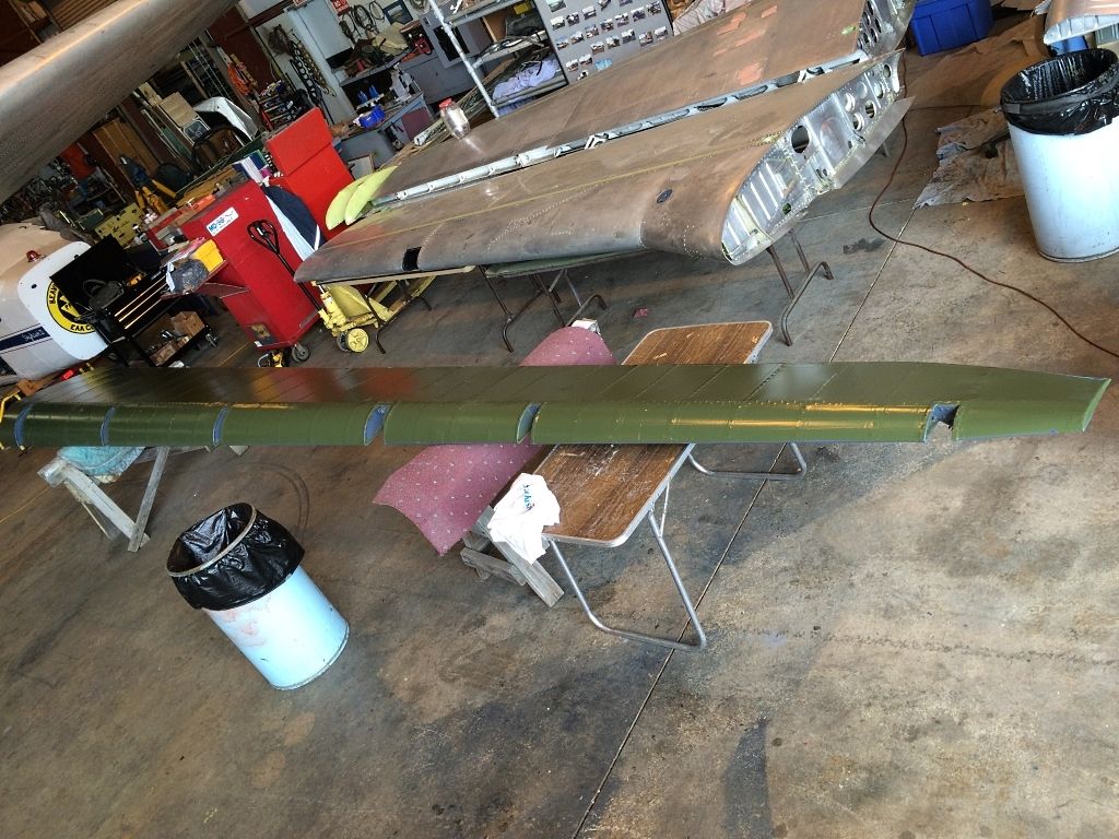

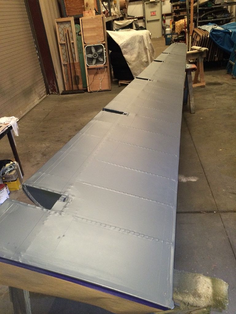

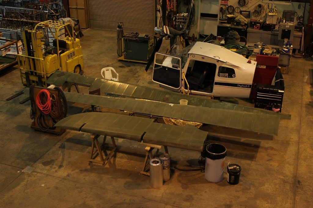

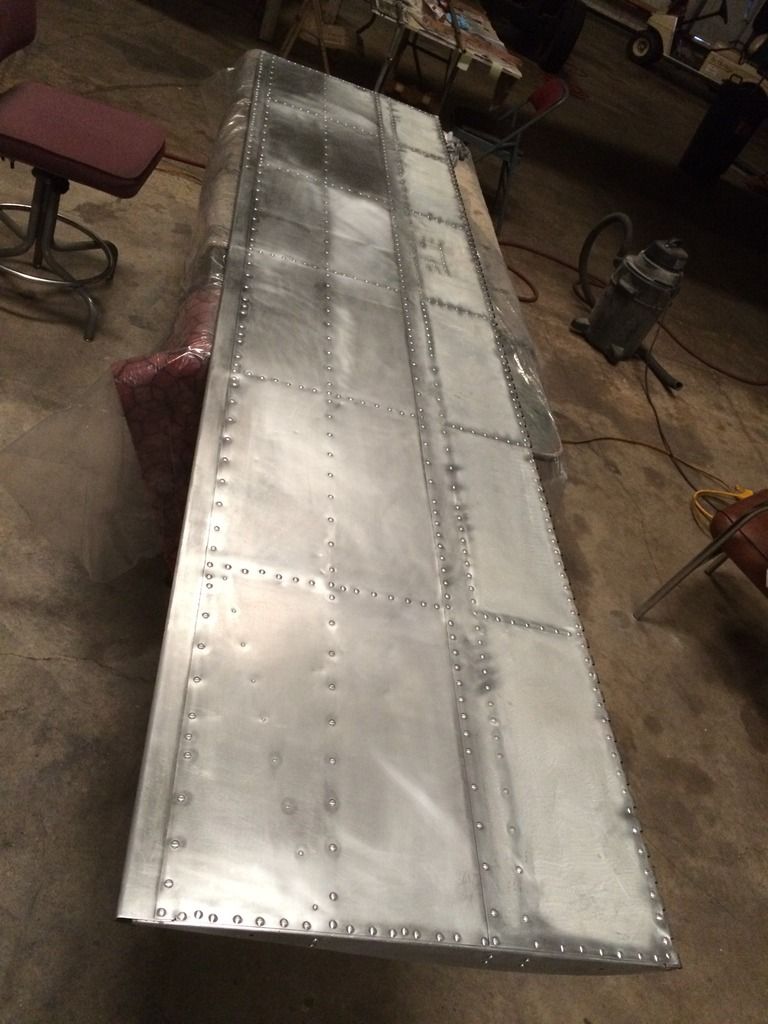

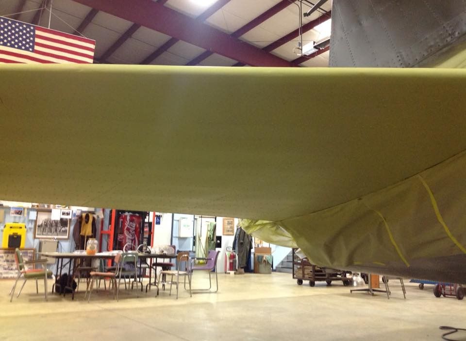

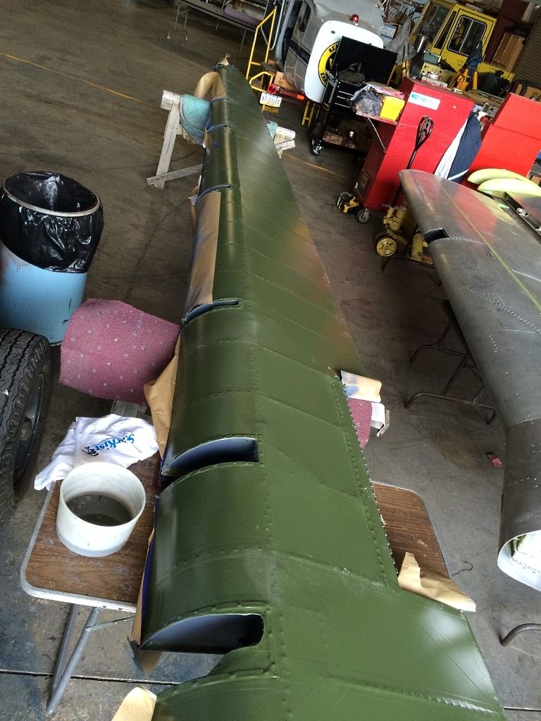

Work on the controls continued over the winter. The Ailerons and the completed elevator kicked off the painting process for the plane. Here is a shot of them in the first coat of Olive Drab, however it was lightly sanded in preparation for the next coat.
Here are the controls as of this weekend. Both Ailerons are finished and have been wrapped up awaiting installation. The completed right elevator just needs one more coat of grey and then it will join the two ailerons in waiting to be re-installed. The paint looks really good. The Semi-Gloss finish is perfect, not too shiny but just shiny enough that it will look really sharp once finished.

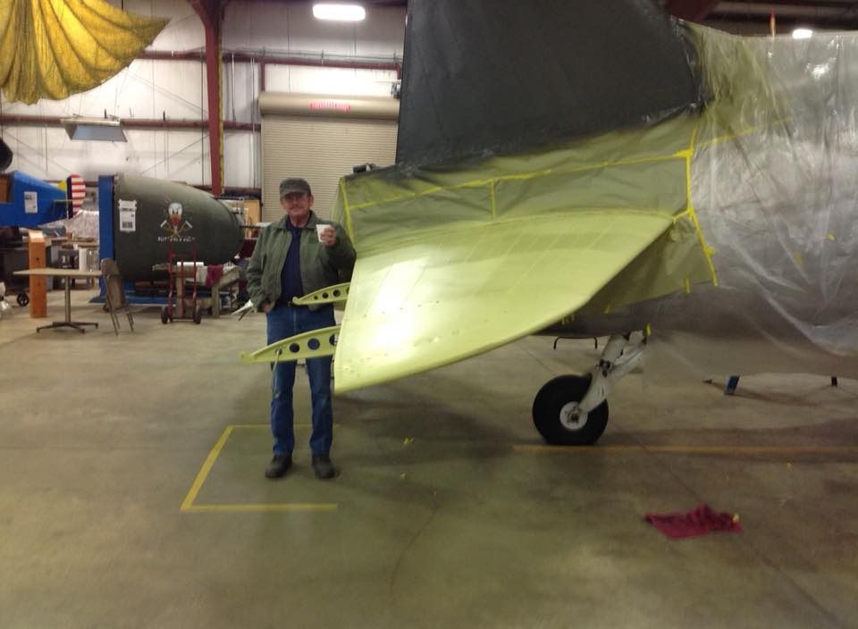

just to give an appreciation on how long these controls are, our T-34 wings in the background
It is really hard to show the color of the olive drab as it changes a lot in different lighting. However, it very closely resemble's Kermit Week's C-47 if you look at pictures of it. Very green in direct sunlight, but in non-direct or overcast very dark. Same with the Grey...

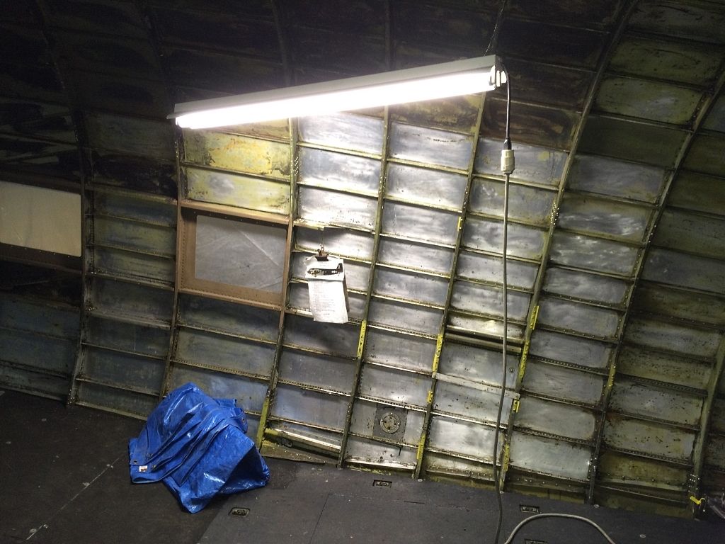

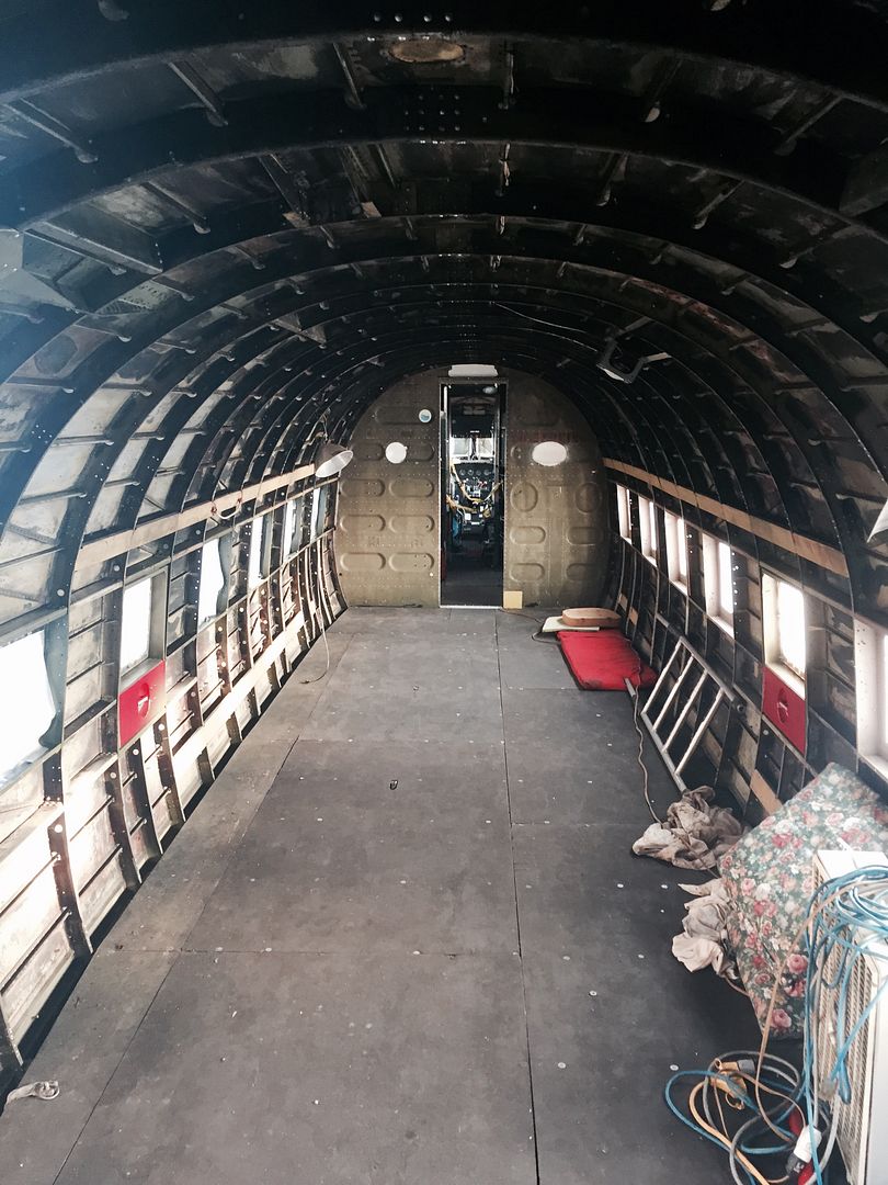

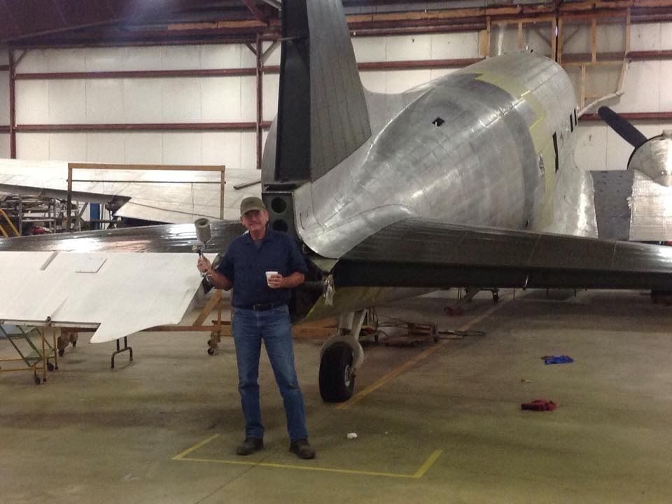

Volunteers are continuing to work inside the cabin to clean it and remove the adhesive left behind from when it was converted into a VC-47. Its a slow process, but they are making ground. We still have not found anything that will easily take it off, but I still would like to try either Steam blasting or soda blasting on it.

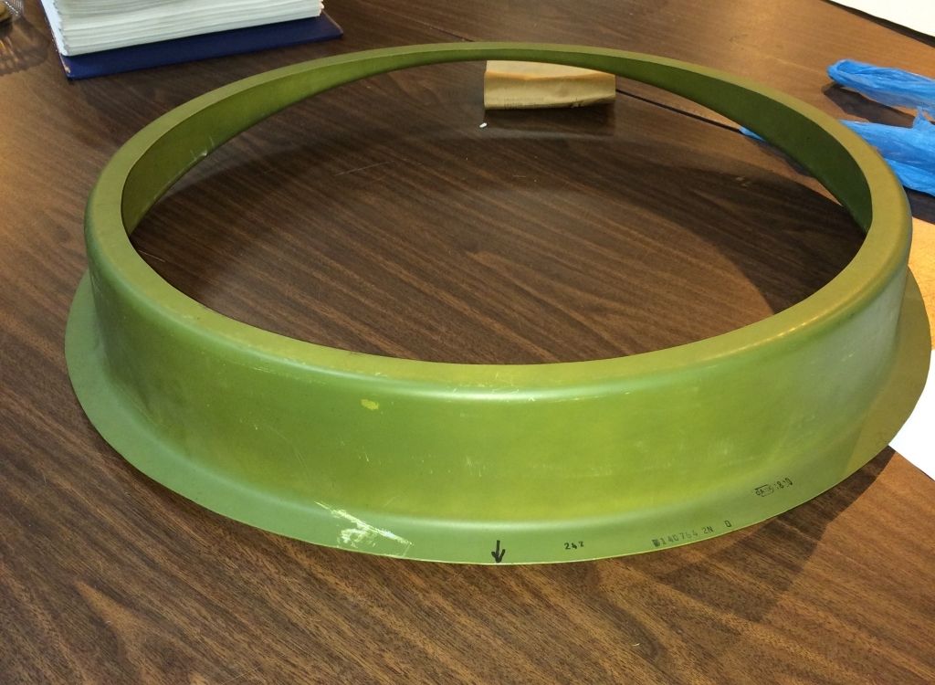

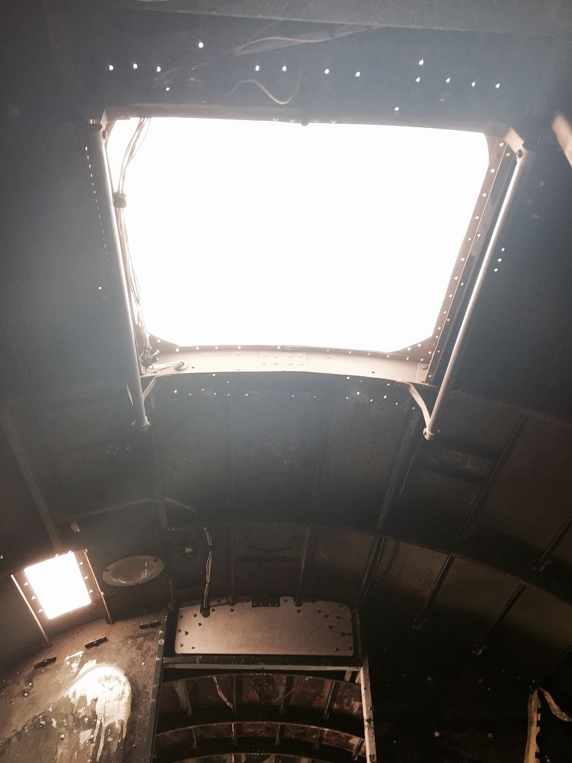

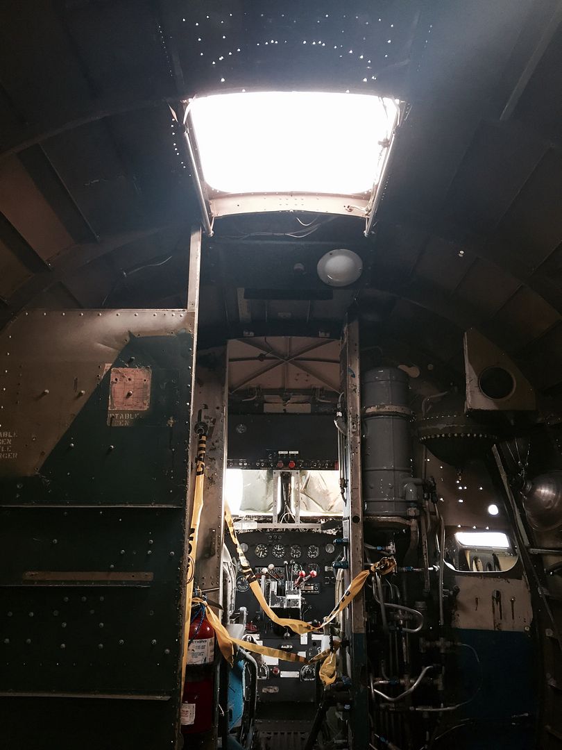

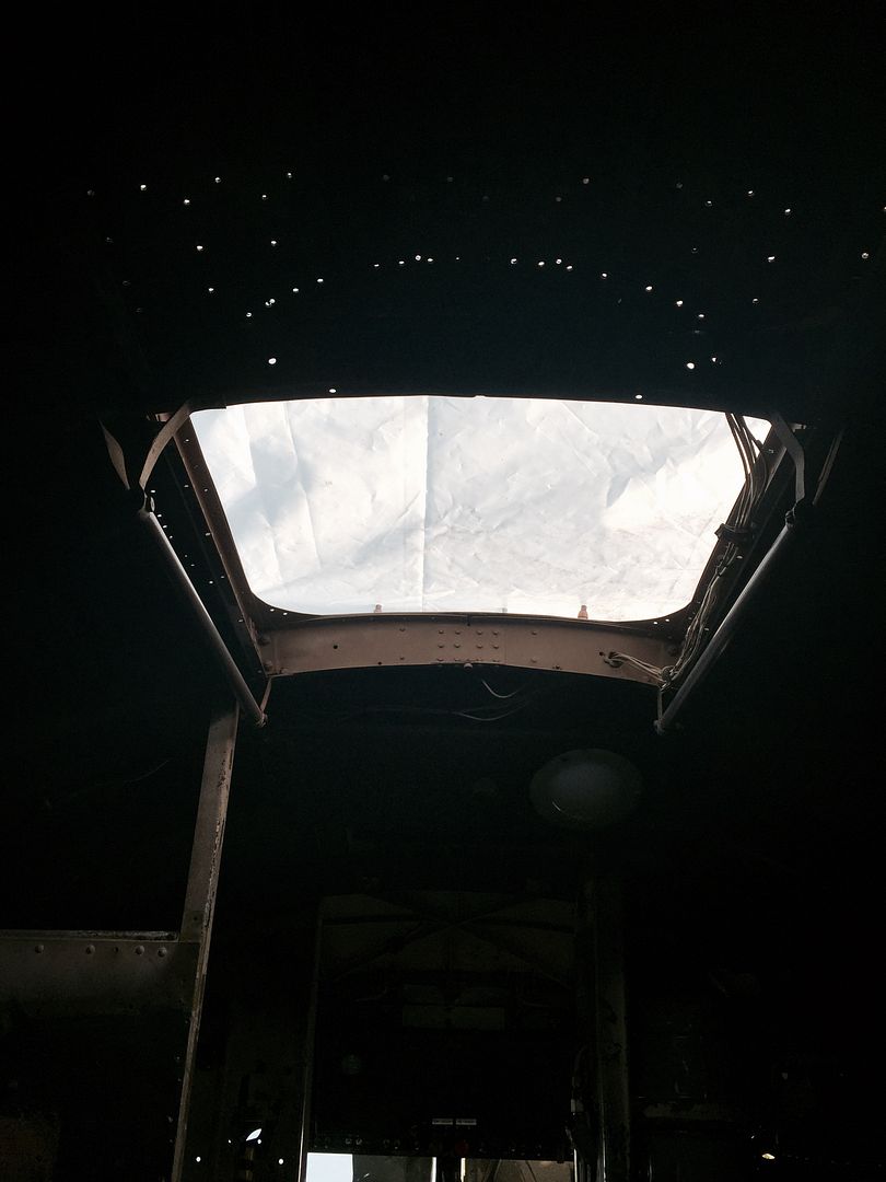

FINALLY WE HAVE A DOME!
We could not find a complete unit and people who did have them were unwilling to help us. We had bought a dome back in the fall, however, it was not what I was expecting and I knew it was not right coming out of the box. However, the dome itself is the correct dome, it was just the mounting system was wrong. We were able to find a part supplier who had at least one NOS dome mount in stock and we were able to get it. Once we removed the metal ring off of the dome we previously bought, it fits perfectly into the new mount. Right now we are just waiting on the gasket that goes in between the mount and the dome to seal it and then we will begin drilling off the plate from the top of the fuselage and build up the dome assembly and then install it! This was one of the last hurdles we had that was going to keep us from painting the plane. Now, once the plane itself is finished being prepped, painting on the plane will begin.

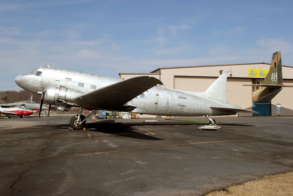

We should be painting the plane sometime this summer. It is getting really close and the tail will be the first part that is done. Hopefully, it will be completed prior to August 15th, as that is our Aviation Appreciation Day. It does not look like we will be flying anytime before the fall however.

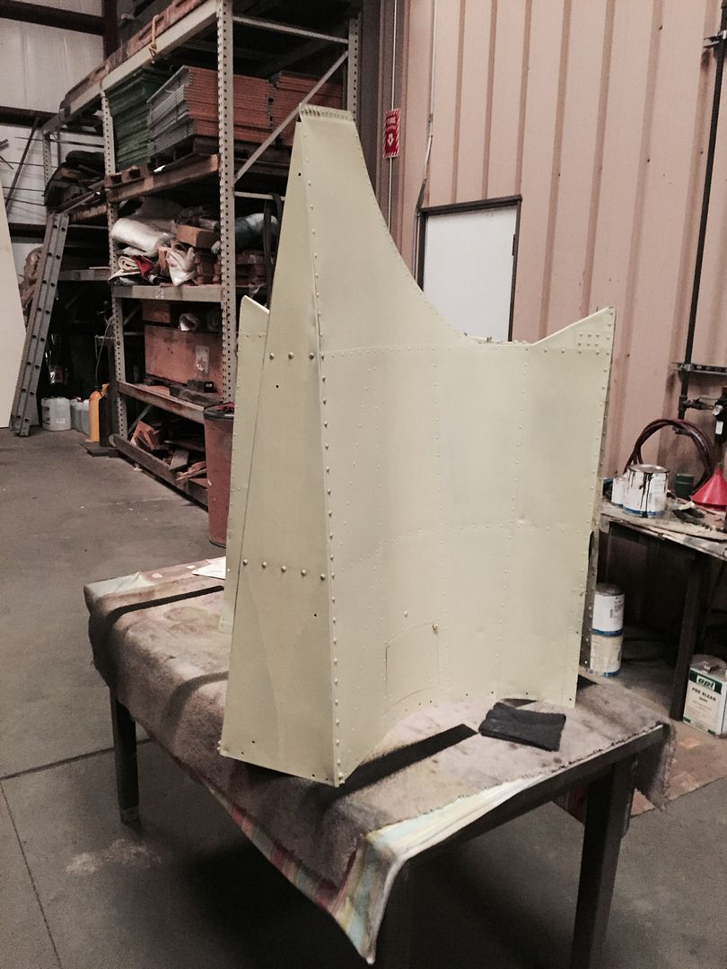

As I posted in my last update, the Primary Flight Controls have been painted, though they still have to have the Forest Green accent trailing edges painted; though we will do that once they are back on the plane.
The rudder is almost done with its recovering process. I am not really sure what is holding it up other than the fact that the person who has been working on it has had health issues and has not been around much. As soon as it is done, it will be painted. We still have one Elevator that still has yet to start the process.
The plane itself will be painted in sections, starting with the tail and working forward on the fuselage then the wings. The first section itself will the empennage forward to the lap joint of the mid/rear fuselage (so about 3-4ft in front of the horizontal). The tail is currently being prepped for paint now by scrubbing it with micron pads and paint thinner.

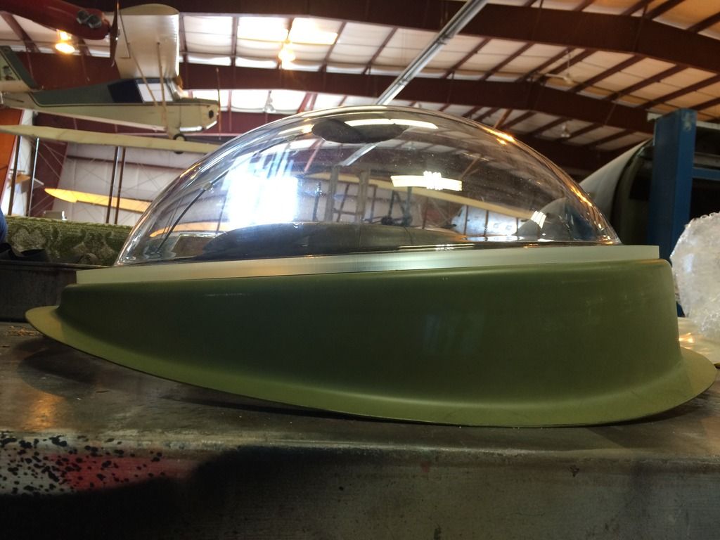

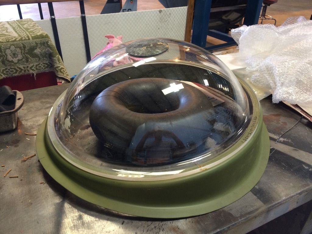

We also have sourced parts to put together a brand new Astrodome. We are just waiting on the seal and then we will be drilling off the current patch and installing our new dome.

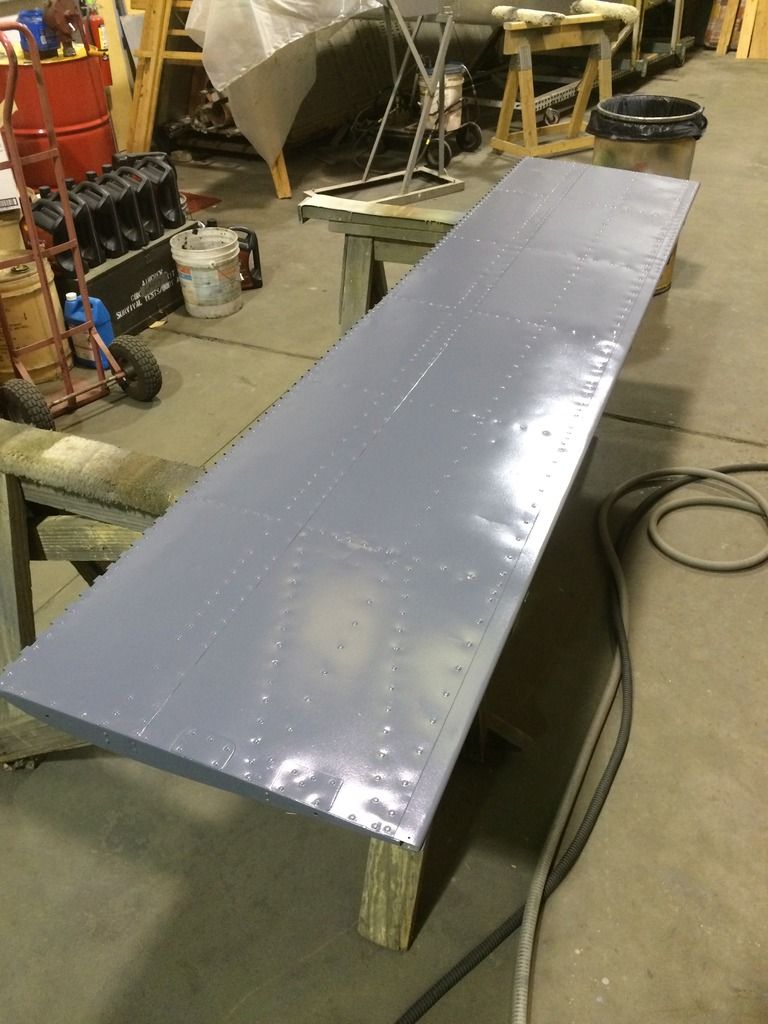

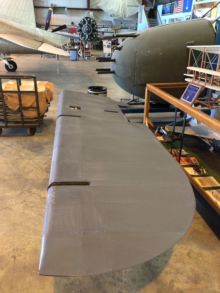

Here are the update shots...
Outter flap being painted

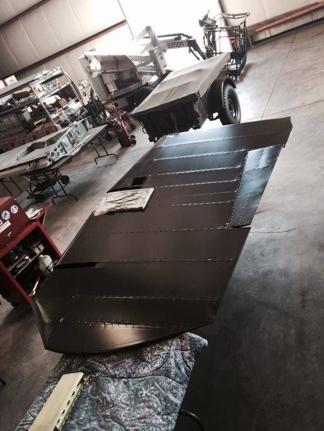

Trim Tabs being painted
Main flap being prepped for paint
Outter flap being prepped
Our Astrodome (just sitting together)

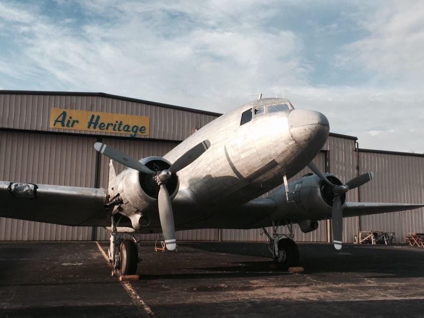

How she more or less looks now sitting in the Hangar

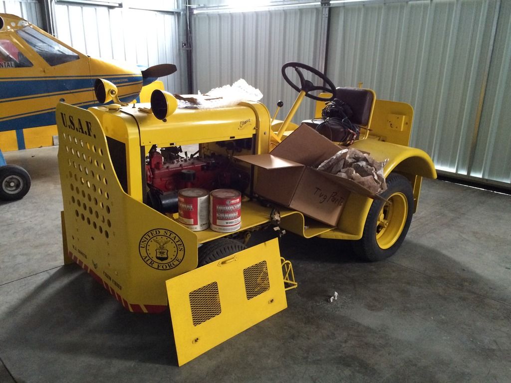

Plus we were donated this 1950's era Clark Tug. Everything is there except for the entire electrical system, so it will take a little bit of work before its running and ready again. Though it will be a blessing once it is as our current tug seems to be on its last leg.

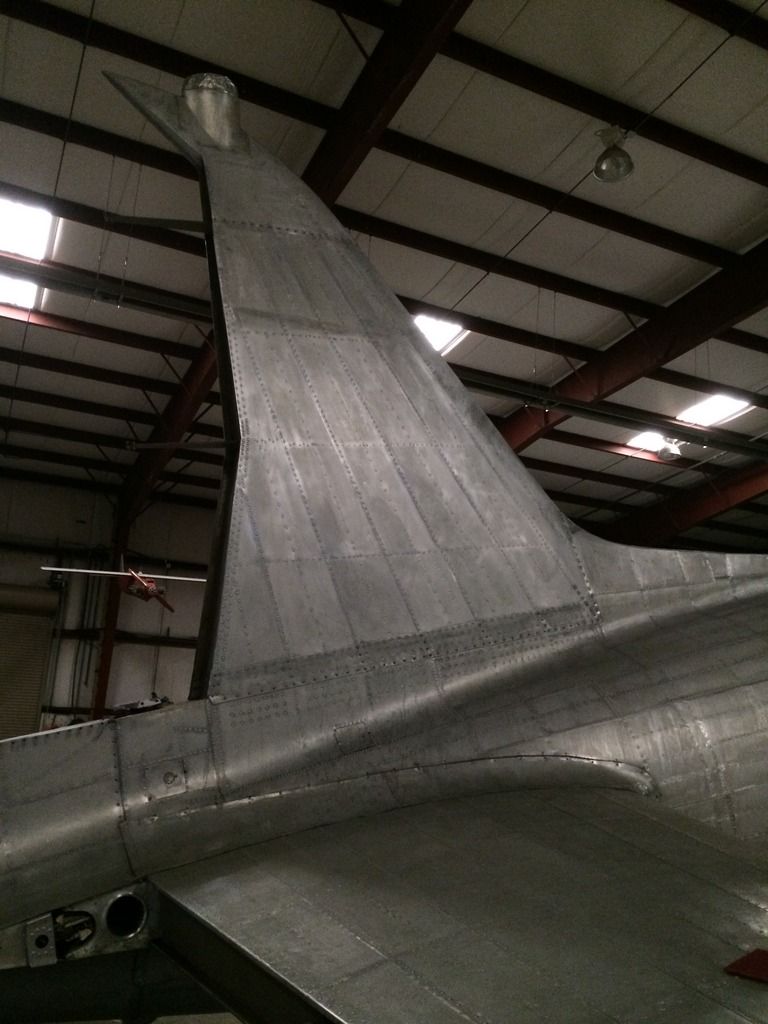

Quite a lot has happened since my last update on the C-47. I am once again reporting remotely, so some things may be a little outdated as these photos span from today back to mid/late August.
** Side note, we have installed new White florescent lights in the entire hangar and my iphone has been a little screwy lately with colors, so the OD appears a lot darker now and the primer looks tan in some photos.**
Just two random photos to start...

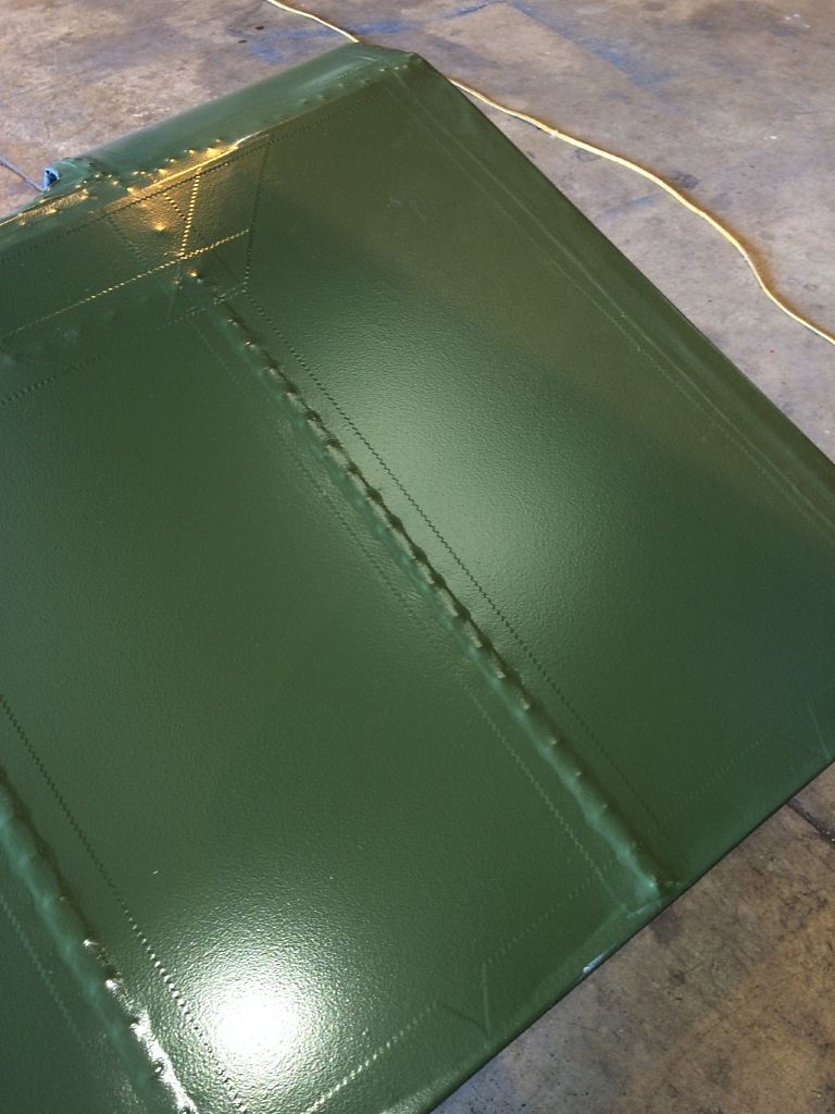

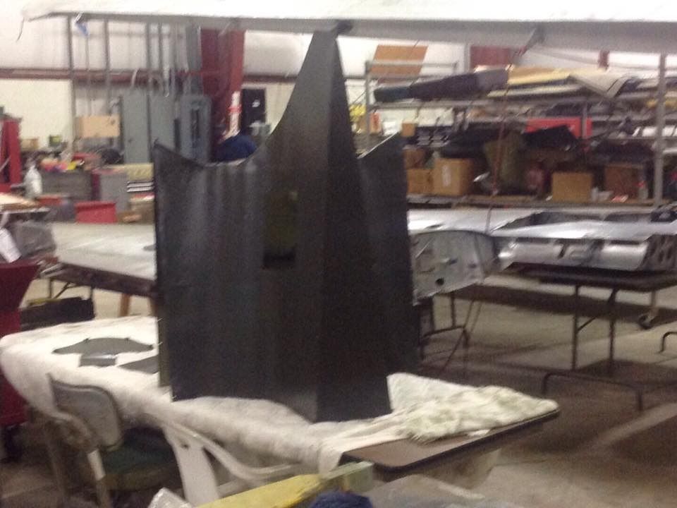

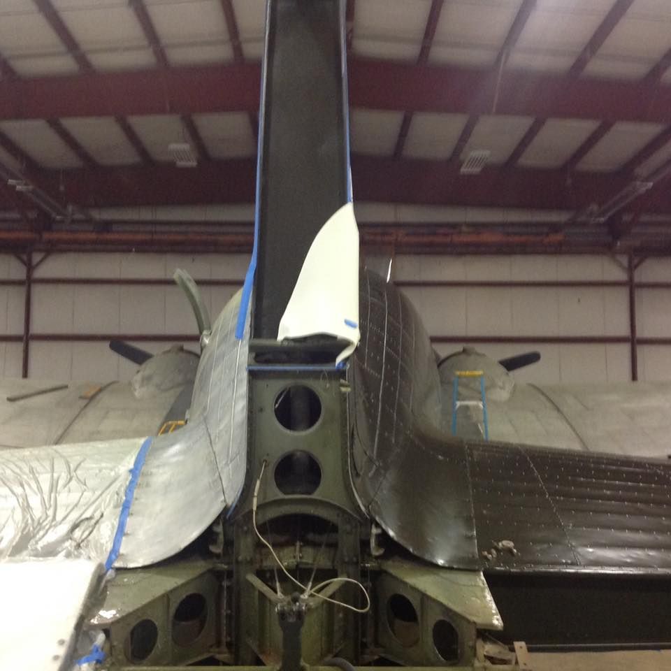

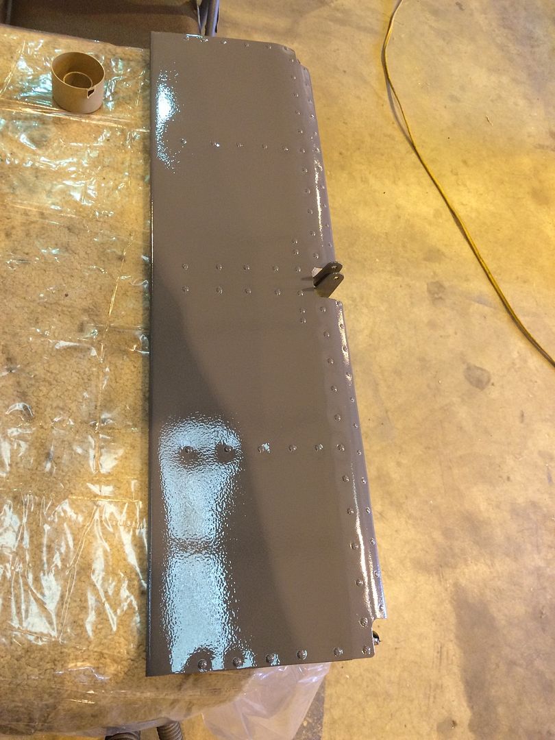

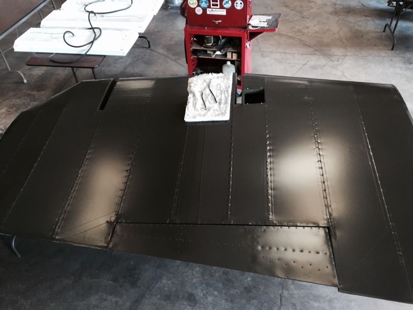

The Rudder was finally finished up in its recovering process and has since been painted. The trim tabs have been installed and it more or less is ready to be hung.

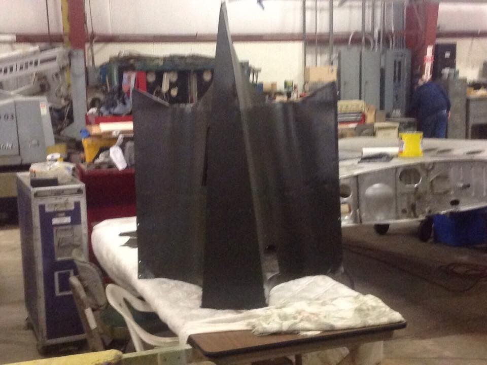

The tail cone was removed from the plane and has at least been primed if not top coated.
The plate that was installed where the astrodome would have been located has been removed from the plane and the dome/plane was being prepped for installation.
AND THE BIG NEWS!!!!!!!

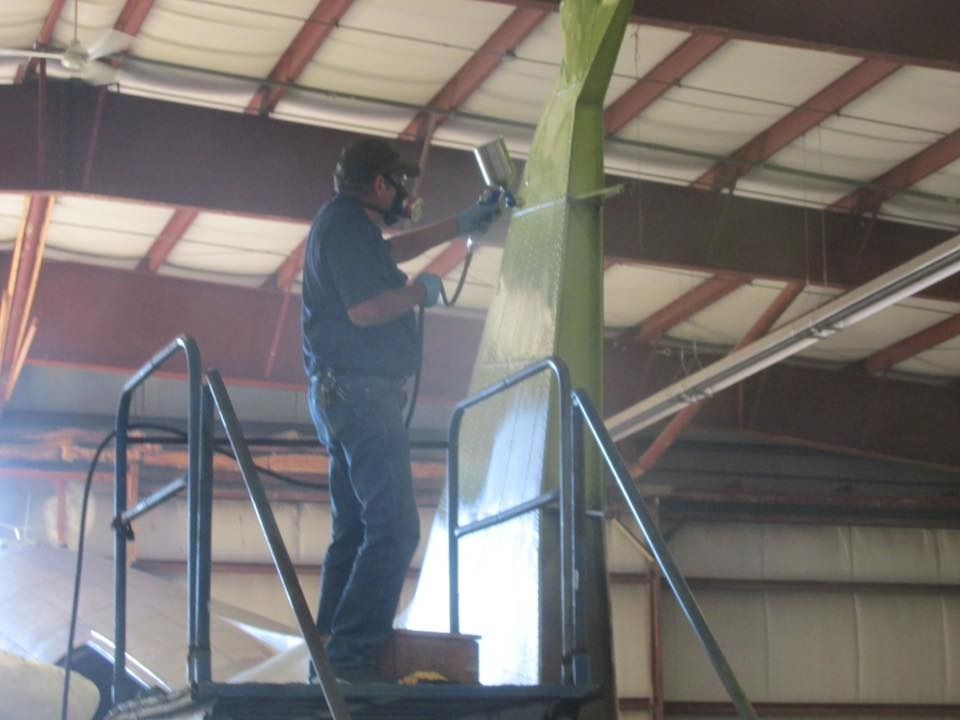

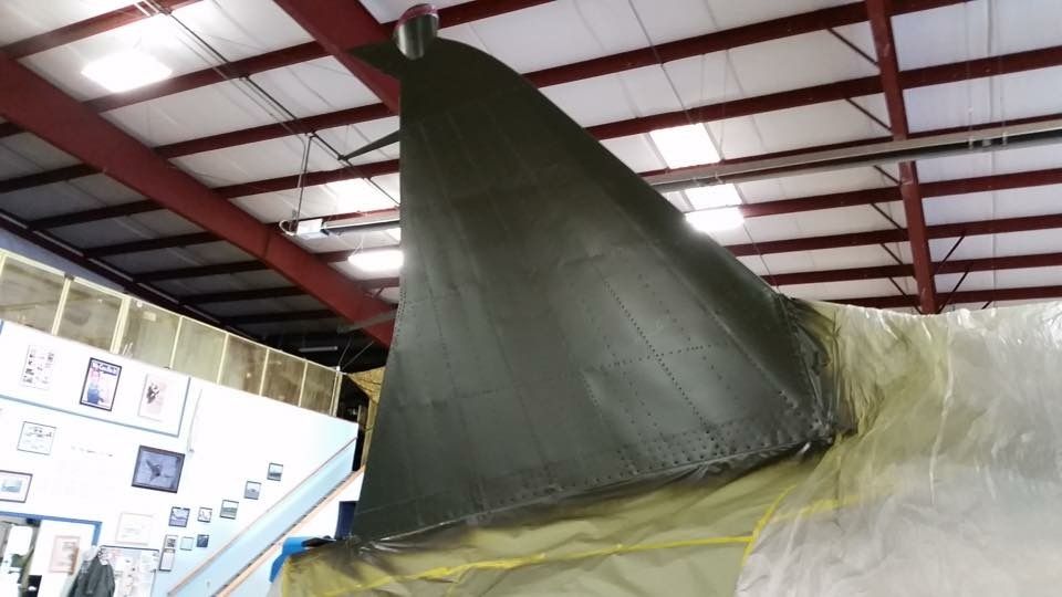

WE HAVE FINALLY BEGUN PAINTING THE PLANE ITSELF!!!

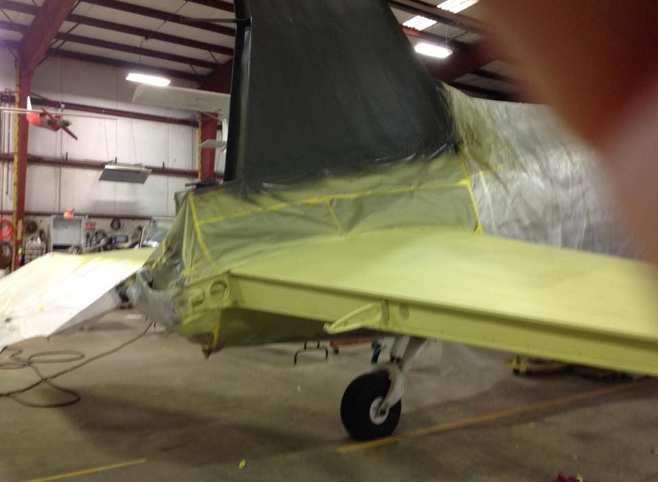

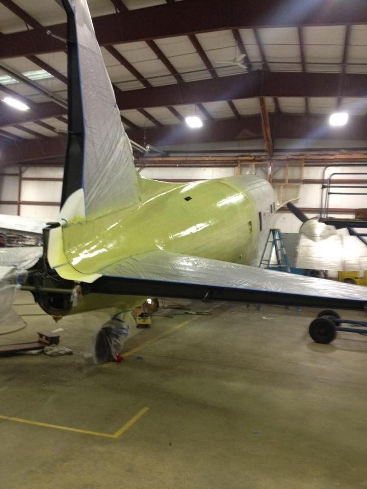

Again, we are painting the plane in sections, starting with the tail and working forward. Yesterday, we began by priming the vertical stabilizer. Today, we were able to shoot the top coat of Olive Drab. Its taken a lot of work to get to this point, but we are finally making progress.
In this photo, you can see the difference between the prepped aluminum and the non-prepped metal. To prep it, the plane was dry sanded with Mirlon Total pads and then wiped down with Paint thinner. After that, the "acid wash" was applied.
I also have received the extended aircraft history from Maxwell AFB's historical department. I will post its post-war history next.

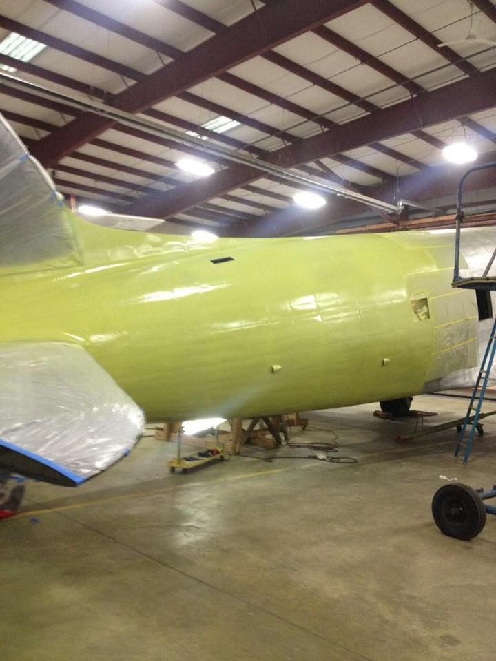

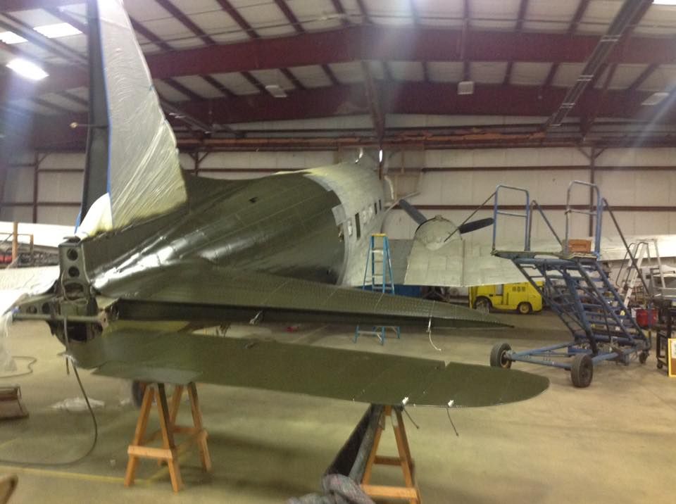

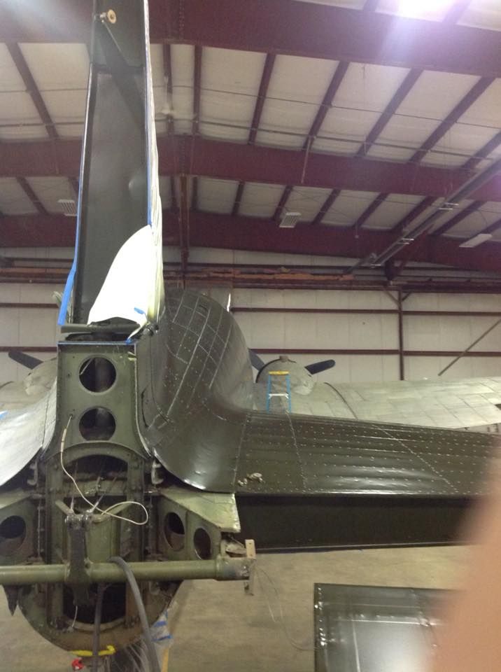

But painting has continued since last week's update. They have primed and shot the olive drab over all the stabilizers and as of today have primed the rear fuselage in its entirety. The tail cone has also been finished with olive drab at least (not sure from the pics if the grey has been sprayed or not).
Horizontals Primed
Tail Cone OD
Fuselage being prepped
Fuselage Primed
