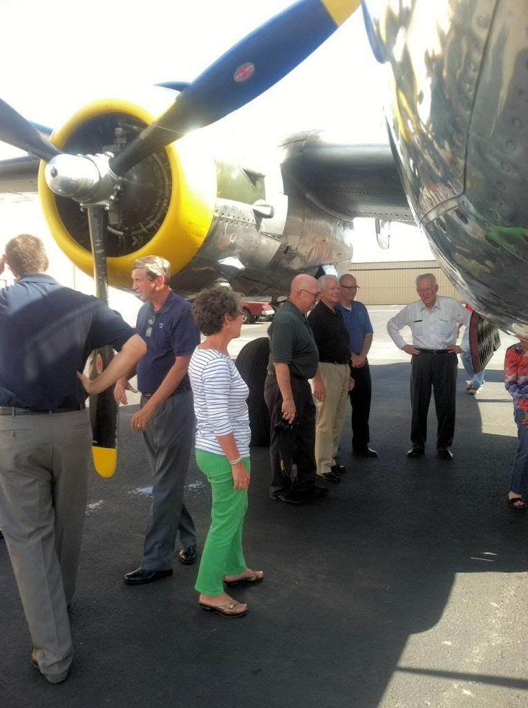

Reception committee in Mt Pleasant for the Prowler. Looks like she has a great new home. She will get a lot of TLC and be out to airshows again soon. JR

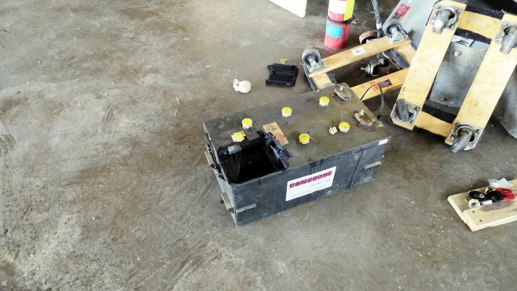

This battery came out of our start cart. There are four of these big hummers in the electric truck and we can use it to start the airplane or drive tools around to the ramp. Well, some of our neighbors borrowed it and apparently there was this big bang when they stepped on the pedal. This battery blew a section right out of the top. It may have been a little too dry in all of this heat and an internal short or something ignited the hydrogen gas that normally is vented. I know how it feels. I am too hot, too dry and too ready for a nap. More good stuff tomorrow!! JR

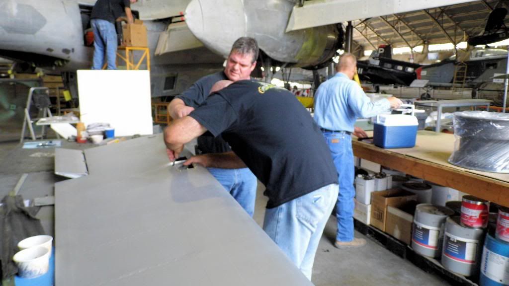

Work continues on the elevator in prepping it to be hung on the stabilizer soon. The trim tab was mounted and the gap seal installed. David B, Tim and Bryan are taking care of the details. The trunnions that hold the attach bolts were apparently installed during the original manufacture process and then drilled out so there is only one way that the trunnions go. Anything else binds up the bolts. Not knowing this, the trunnion positions were not marked during the removal so it has been a lot of trial and error to find the right spots. Thankfully, the code was broken and now all is well. Meanwhile, the doghouse is getting a lot of attention in preparation for new paint and the hatch cover is nearing completion so that the glass can be installed. We would like to have this done in time to be outside for the VFM Hangar dance on 5 Oct and the AOPA Summit display the following weekend. JR

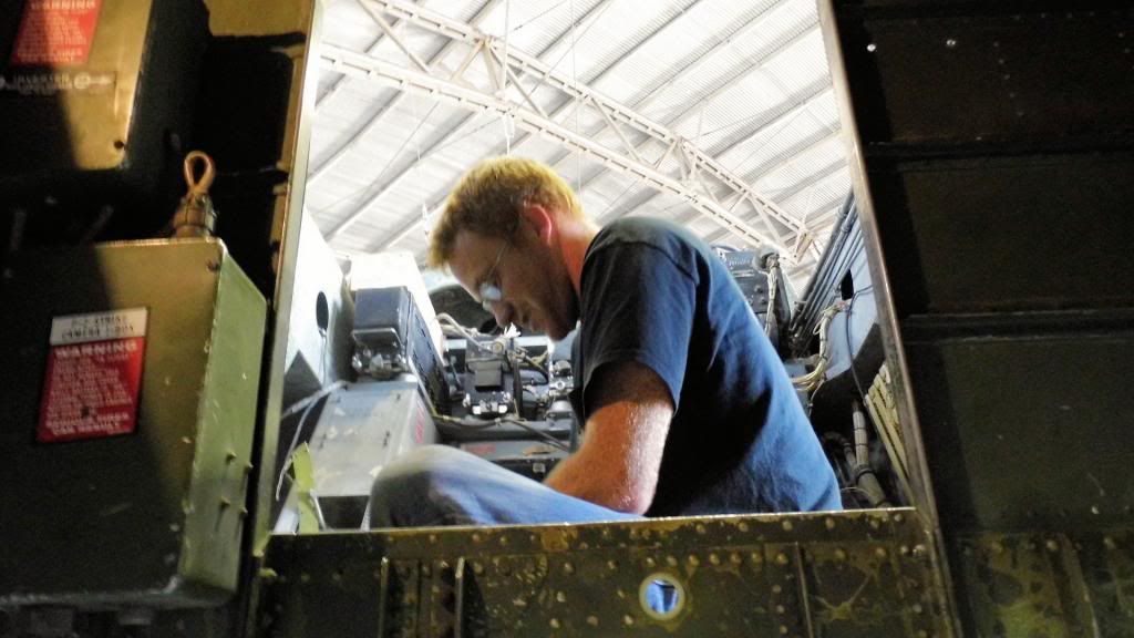

Speaking of the doghouse or more appropriately, the rear gunner's compartment, as Jaime is prepping the area for a coat of new gray paint, it is remarkable just how little room there is back there. Imagine a periscope in the middle of it with a small bicycle style seat and just barely enough room to spin around 360 degrees. By the VN era, this area was converted to mainly recon camera controls and a space for the camera operator. There were a few experiments with early night vision scopes to have a crew member lean out of the compartment with the bomb bay doors open while cruising over the HCM Trail in Laos at night and try out the new technology. High humidity and jungle triple canopy hindered most of the attempts so it was not very effective. We hope to put two seats back there for our crew, but they better be non claustrophobic and hope ventilation is good.... especially after working all day at a hot airshow. :-) JR
