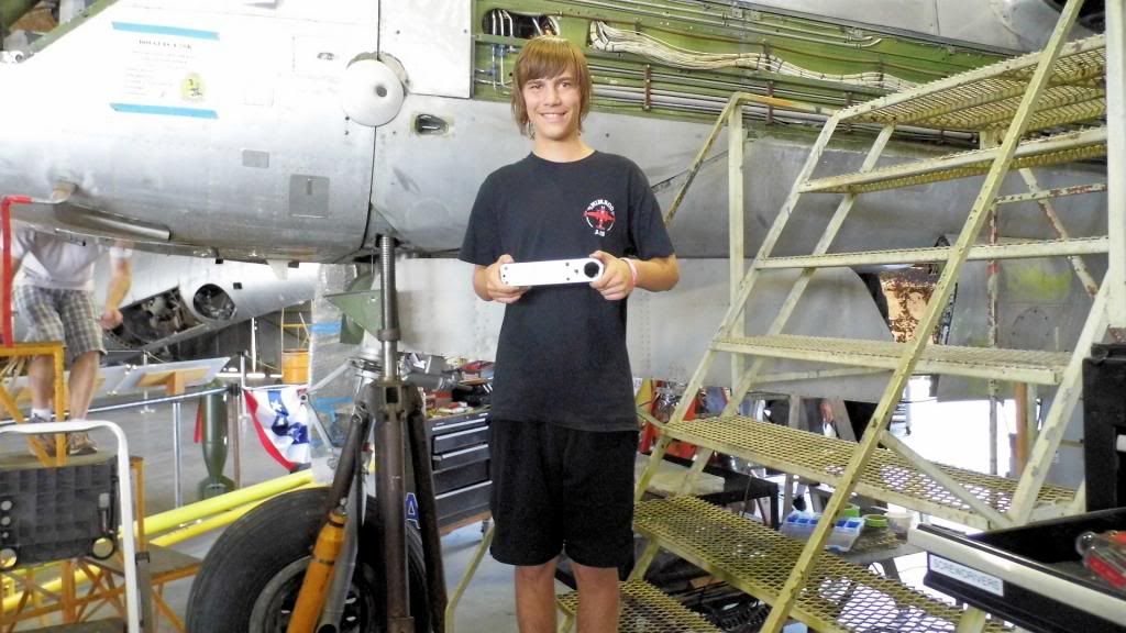

Here is the famous wrench that Rob S found in the nose back in 1978 after the Macon, Ga, crash with Ethan holding it for size comparison. It is steel and quite heavy. Can't imagine somebody dropping this and not noticing. :-) Had to have just laid it down and forgotten about it, then maybe slid around someplace to hide for 9 or 10 years. Stranger things have happened. JR

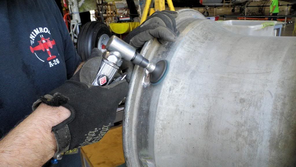

Here the real JR is blending out some tool marks in the nosewheel before it gets shipped off to the overhaul shop. Overall, it looks fairly decent, but we want to have it cleaned and inspected, painted and new bearing races installed. Should be good as new when it comes back.... if the way the shop worked over the main wheels is any indication. :-) The other JR

Wow, that wrench is a lot bigger than I thought it was from the previous picture. Definitely not anything I remember seeing or using.

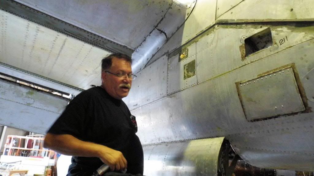

Lou worked on this area of two scab patches that covered up shrapnel wounds by cutting it out and prepping it for new skin. Ray repaired some of the underlying structure and got it finished up underneath so it can be covered next weekend. He also cleaned out the kick in step on the side of the fuselage. The spring that holds the lid closed was broken and the piano hinge looked kinda rough. Ray is our perfection metal magician and puts in a lot of overtime to make it look right. Lots more little dents and bumps to do before her makeover is complete and she is ready for the coming out dance. :-) JR

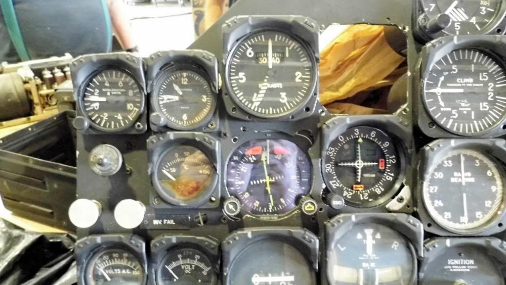

Got the G Meter back from a Century overhaul. Looks purty nice in the panel. The A26 handles more like a fighter than a bomber so one has to be a little careful just how many G's are pulled. A little over 3 g's was the military limit. From the stories we have from the Nimrods, a limitation was a goal not a restriction. Probably pushed it around over the limits many times. That tends to happen when people are shooting back at you, I'm told. :-) K is not as young as she used to be so we are going to take it easy with her. JR

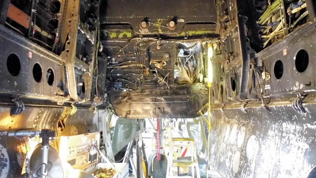

Ray finished up the bomb bay repair and reinstalled the bomb bay door forward actuator. Just in time as we have a rumor that Amy is coming to visit next weekend. She overhauled those actuators and redid many of the door hinges and arms back last year. We have missed her since she moved off to greener pastures in Tuscon. JR

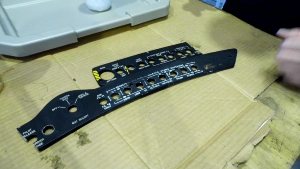

Rand has been busy renewing and cleaning up the armament selector panel. More fine sandpaper and water he says. Well, it appeared to be clear liquid anyway. He was drinking most of it.... but it was warm in the hangar. :-) Looking purty good there, Rand. Thanks! JR

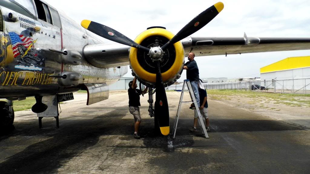

In other museum news, the B-25 was pulled out of the hangar and test run today. An engine driven fuel pump was leaking a bit so that was changed out by Pat. It popped and belched so it appears some plugs may have fouled. The guys will change those out tomorrow and run it again. If all goes well, they may test fly it and if that goes ok, take it down to Cleburne for more time on it before it goes to Topeka on Thurs assuming everything is working properly. The Gathering of Warbirds there should be spectacular. Ck out the website: http://www.warbirdsand legends.org See ya there! JR
