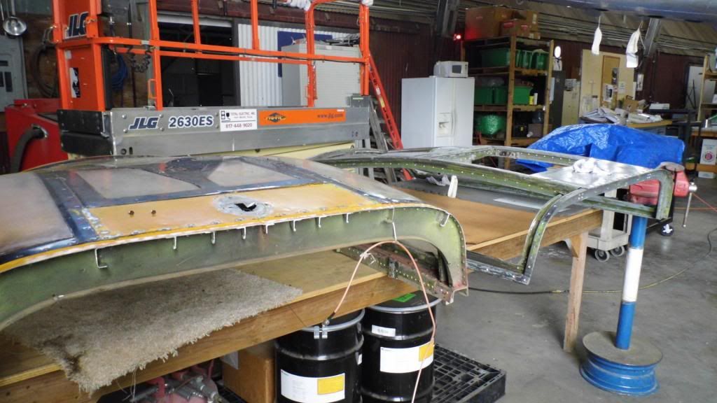

Randy, I think the jettison switch is still in the "doghouse", but I honestly haven't looked recently. Work has begun on that area though so I will check it out. The picture shows the two doghouse covers that we have. In looking at the one we traded for and the original fitted to the airplane, it appears that we could take a few parts off the traded one and make our original whole again without having to trim and adjust the other one to fit the airplane. We had some long curved stringers that were badly corroded and were not going to be easy to fabricate. Looks like the problem is solved though with the swap. Then the new glass can be installed and the escape hatch made operational. Meanwhile back at the ranch, the nosewheel was removed and the spare was installed. The nosewheel is going to the shop this week for overhaul and a check out of the tire. We think it is probably good but want to have a look inside. A new tube would be in order as well. A flat tire could be bad news as low as the props are to the ground. Any excursion off the runway with a flat will most likely result in some sort of prop strike so we have to take all precautions with it. In all, we had a very successful day. JR

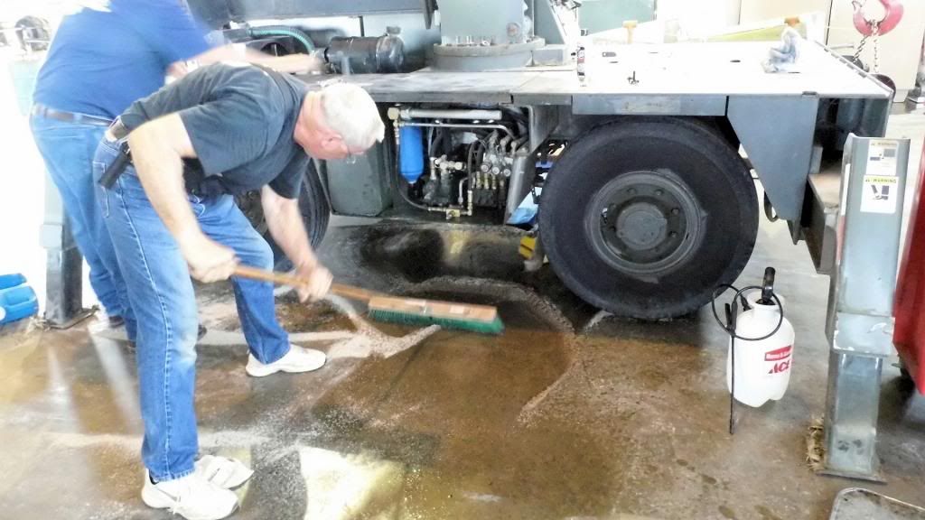

Another project we have going on. Arnold and Ed started work on the new crane GGA obtained from the surplus yard. Needed some exhaust pipe repair and a general clean up. The fuel tank was found to be rusted out at the bottom .. probably from sitting too long empty and water getting in. This will have to be repaired or replaced. BUT, the Diesel engine is still good and the hydraulic system checked out fine. Arnold used some solvent to clean things up so they are sweeping it up in the picture. It is rated at 17,000 lbs so should be more than enough to lift our engines off the airframe for overhaul and repair work behind one of them on the nacelle. It was very hot and humid in the hangar yesterday, but the guys kept right on going. Inu, our floor manager was there to supervise! He kept doing belly flops on the concrete to try and keep cool what time he wasn't spending at the water cooler. Everybody was ready by noon to head to the mancave for lunch and a cool down. Inu had a good time mooching little yummies from the guys. JR

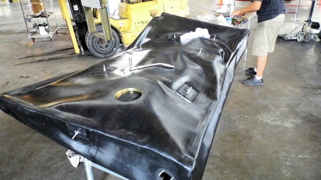

PostPosted: Sun Jul 21, 2013 6:45 am

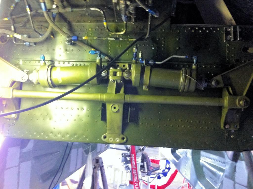

Today, Ray and the real JR pounded rivets to finish up the bomb bay area repair and install the forward door actuator. With both actuators now ready, the guys should be able to run the bomb bay doors and complete the rigging next weekend. Accolades to Ray Schechter for now the bomb bay forward bulkhead structural restoration is substantially complete. This area was damaged during the Macon accident in 1978. It was cosmetically repaired but some structural deficiencies remained. Ray has essentially rebuilt the entire area piece by piece. His craftsmanship, quality and attention to detail are superb. The actuator assemblies were fitted this afternoon thanks to JR. There remains final painting, switch installation rig & ops check. Meanwhile, Larry made a lot of headway in checking out the attitude gyro instrument and the gyro control in the avionics bay. There is some work left to do there. The planning for the wiring harnesses for all of the avionics continues. Thanks Larry for the extra effort today. This restoration will be something all of us can be proud of and can feel the great satisfaction of returning 679 to flight. OOOOOOhRah! The other JR

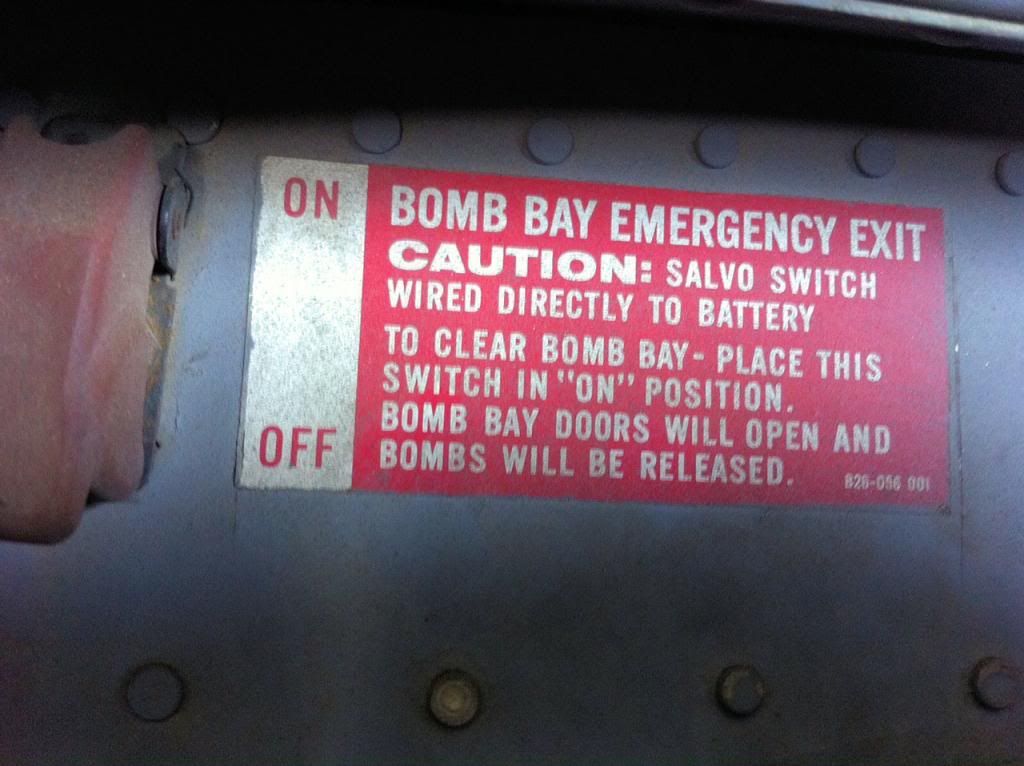

NImrodA26 wrote:
Is the bomb bay jettison switch still in the aft compartment as well?
While I have been gone to Canada for a few days, the real JR got this shot of the switch you asked about, Randy. Guess this answers the question. Still there!! Lucky us. We will have Rand work his magic on the switch and guard while preserving the placard. There are a good number of placards in the bomb bay concerning ordnance, camera mounts, fuel tanks that we will have to be very careful about painting around. So far the guys seem to have that issue figured out, but we sure miss our most excellent painter, Big Mike. He is having a good time up in Alaska sounds like. Should we check back with him, oh say long about November or December?? :-) The other JR

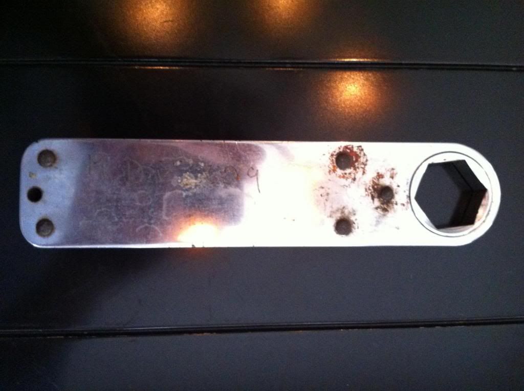

This tool was found inside K after the Macon accident in the 70's by Rob S. during the rebuild to ferry it to Billings, MT. Maybe it was left by some OnMark guy during the 1965 rebuild or perhaps a mechanic from the State of Georgia Forestry Service that owned the plane at the time. It is just amazing what can be found leftover whether it might be tools or penciled instructions/signatures. All cool. Good ad for Snap-On Tools, eh? JR

You mean like this? Thanks Rob! Appreciate your input! So hey Randy... Bob... or any of you guys who "loaded" the airplane for bear back in the day, would this have been a type of tool you might have used? If so, was there anything specific that it did? Curious in the Republic... JR
