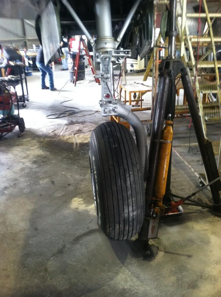

Another big milestone this past weekend. All three gear were swung at the same time and waa laa... it worked as advertised!!! We obtained the overhaul manual for the nosewheel so off it goes to the shop now. Also got a hubcap for it with retainer ring. They are rather scarce so we picked up a few extra as trading material. Took video of the gear swing so hoping Hawkeye will post a link here soon. Check back!! JR

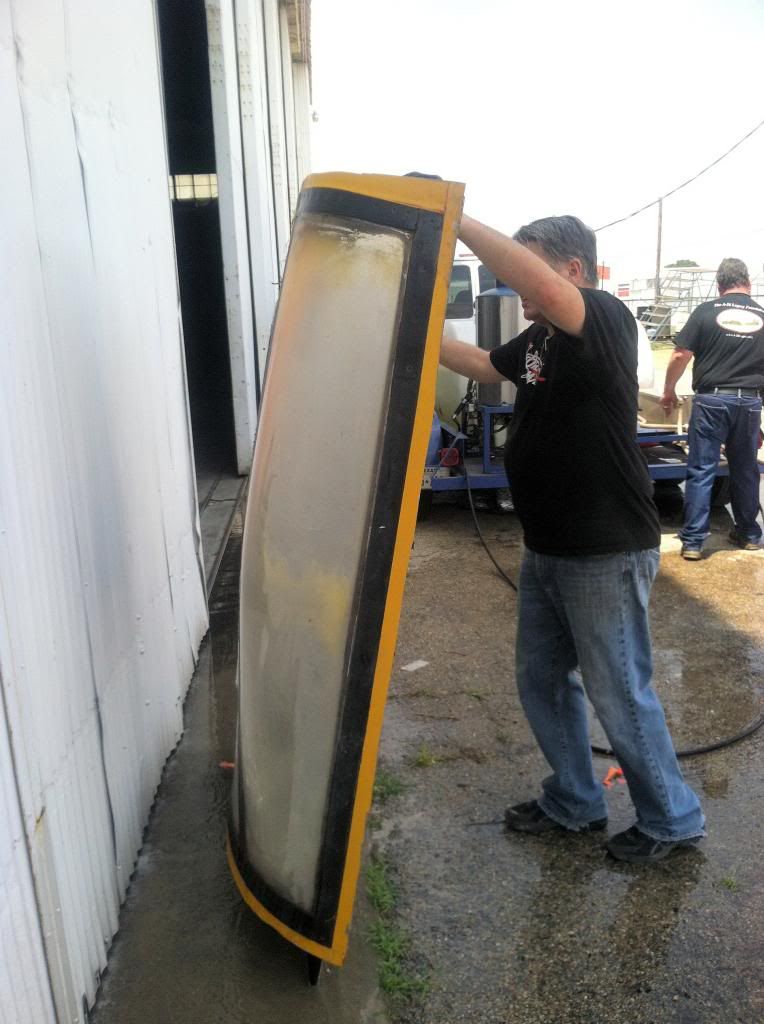

Another item that we have been pondering for quite some time... the cover and escape hatch for the doghouse area. Our unit had some corroded members that could have been replaced, but would have consumed much time. So we traded for the unit in the picture and the real JR and Bryan got the power washer on it to see what we have for sure. We have all new replacement glass as the existing was all cracked and clouded over. Otherwise it is in fairly good shape. Be interesting to see how well it fits now over the doghouse. Another very good day!!!! The other JR

Well, Hawkeye sent me the link to the video of the gear swing test last Saturday. Check this out. First time since Jan 2010 that it has moved. Even with all the line and hose changes, there were very few leaks. Very nice!! Thanks to all the guys and gal for their hard work and attention to detail. This was a big milestone for the team. JR

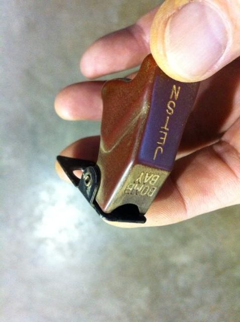

Rand has started cleaning up the armament selector panel. This switch guard was dull red and the letters could barely be made out. With the application of a very fine sandpaper and some alcohol, he was able to get it to look this good so far. Oh, the sandpaper was for the guard and the alcohol was for Rand as the story was related to me??? :-) Thanks Rand.
:drink3: JR PS Everybody drop by tomorrow at the VFM hangar as we will be working on the B-25 and the A-26. We expect to have the B25 back in the air next week sometime. Woo hooooo... Topeka, here we come!!! :-)

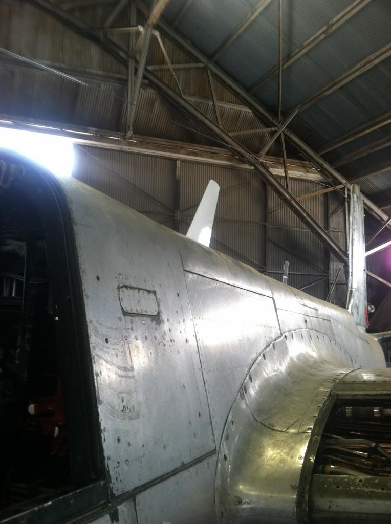

There is a shark in the water!!! No, that white thingee on top of the fuselage is our new shark fin antenna that the real JR acquired for the airplane. It originally had one from the USAF. The mounting spot was located and the antenna slid in place without any other adjustments. Will have to get our "Sparkies" to figure out the rest of the connections to our comm radios. The other JR

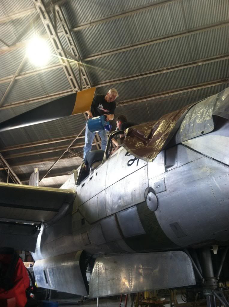

While we were up there, Big Tim and Rand filled the hydraulic system with Mil 5606 fluid as the gear was cycled and air was worked out of the system. This is the first time the entire system was tested since it was made ready for the ferry flight from Billings, MT in late 2009. All three of the alighting gear have been removed, overhauled and reinstalled without very much of a hitch in the whole process. The only thing left to do as far as the gear is concerned is remove the nosewheel and send to the shop for inspection and overhaul. We will put our spare on while it is gone. It's good to have people who are so talented and skilled restoring this national treasure. :-) The other JR
