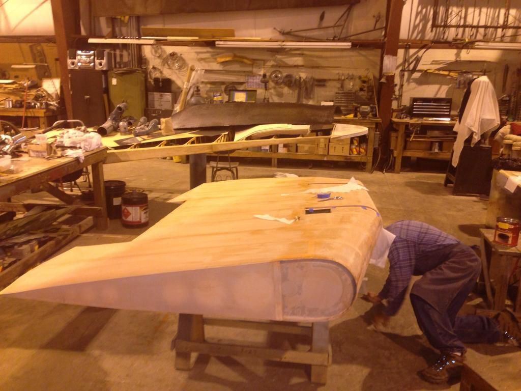

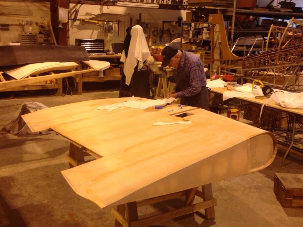

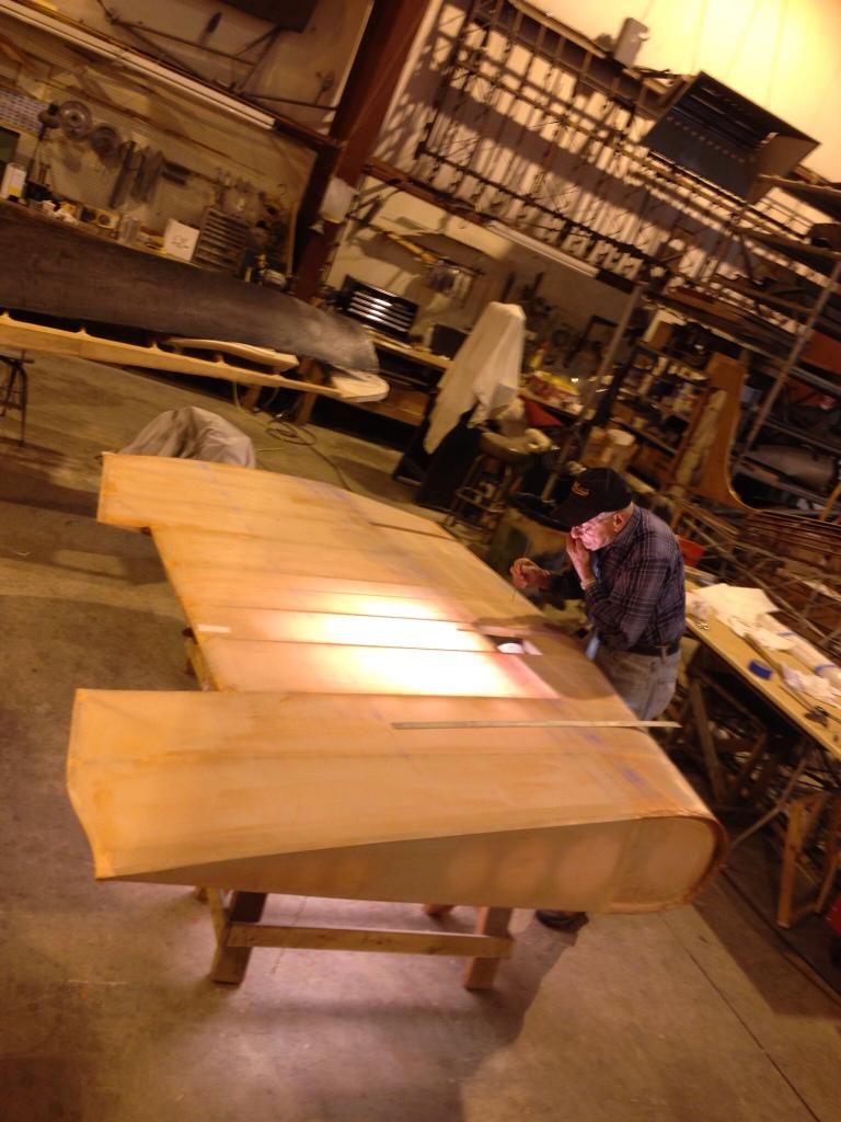

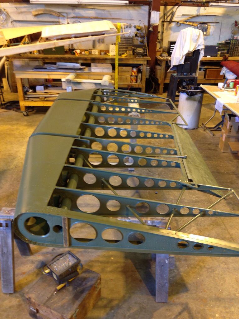

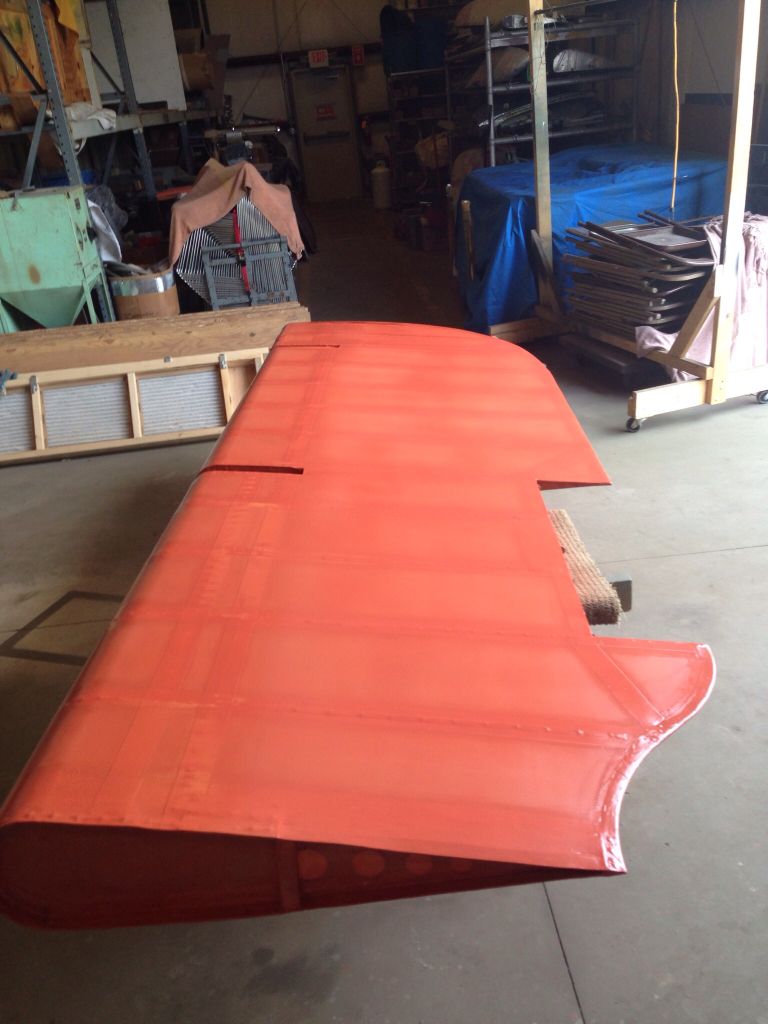

The right elevator is now ready for topcoat. However, we do not have the paint yet, so it's being put aside for the time being. Here it is after spraying the final coat of poly fiber over it and then after the first coat of grey UV protecting paint had been applied.
Prep work on the rudder has begun to recover it.

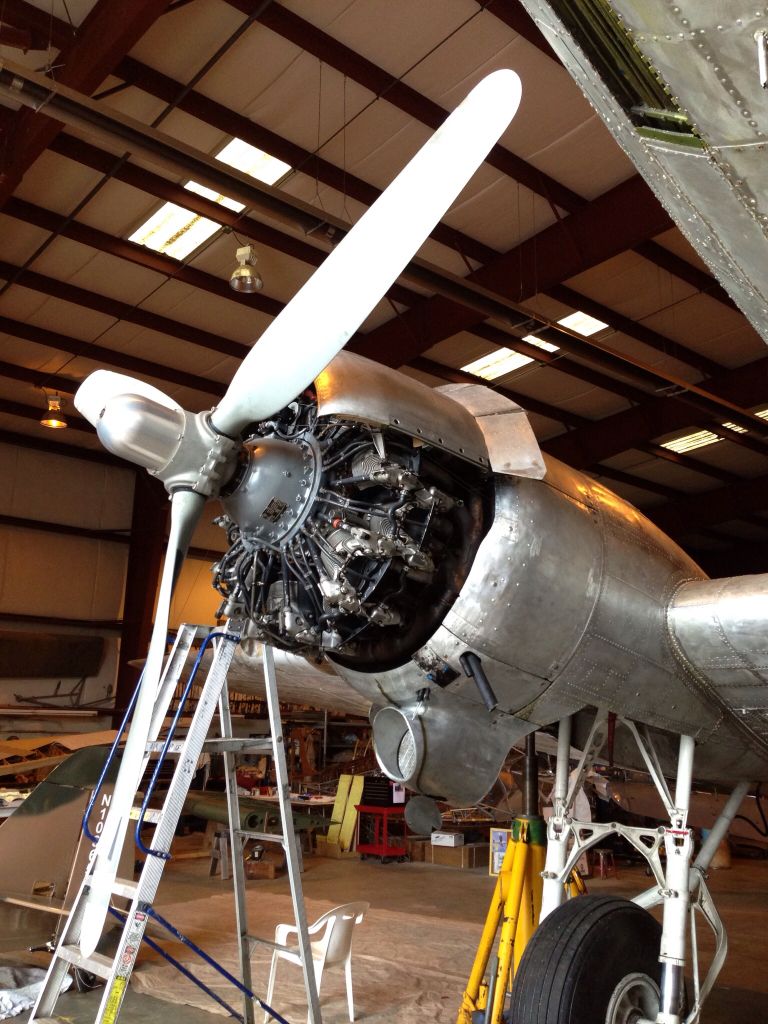

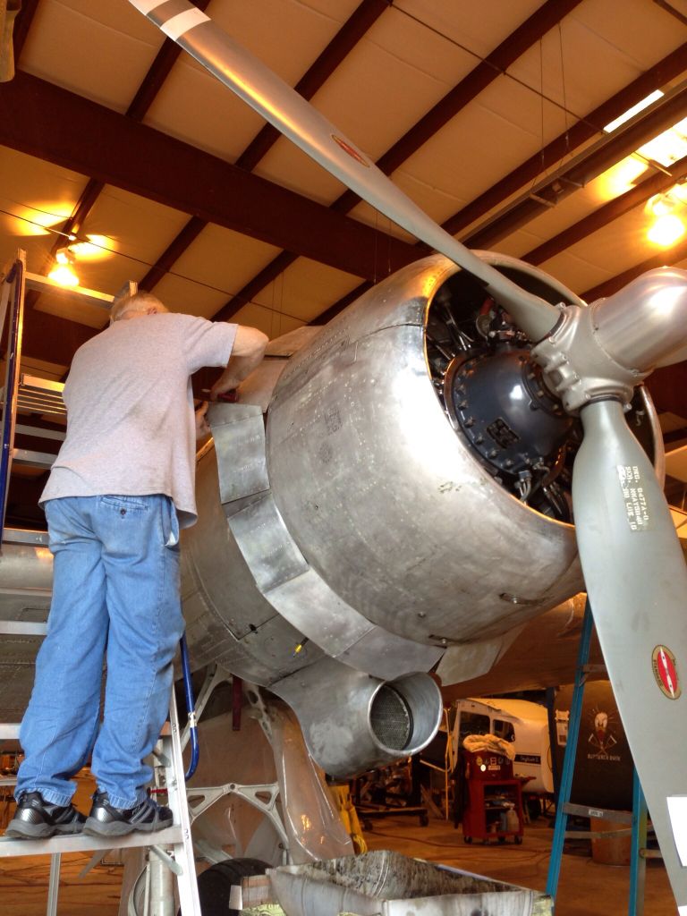

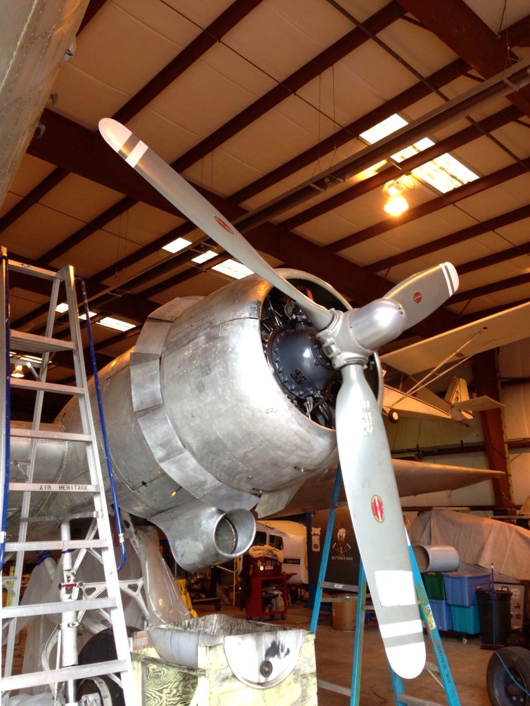

And finally, the cowls have been put back on the aircraft, though they have been taken back off and refitted as some of the cowl flaps were out of place, however I do not have photos from today.

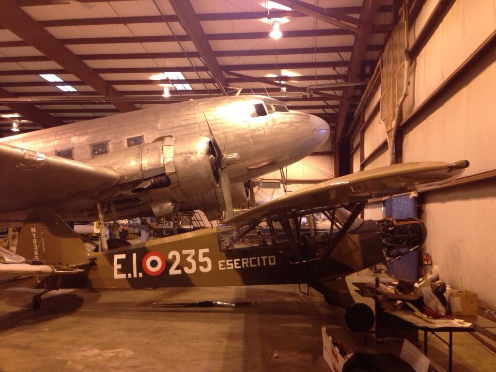

Left side. You can see the flap is over the other flap, when it should be under it.

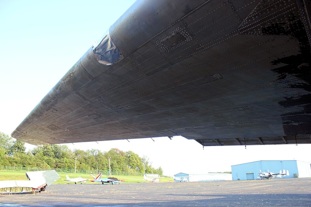

It is time for another update. I had typed this up last week, but I guess I forgot to actually post it... Work has continued along on Luck of the Irish and it is progressing smoothly. If all goes smoothly, we may be flying by the end of the fall, if not then the winter/spring.

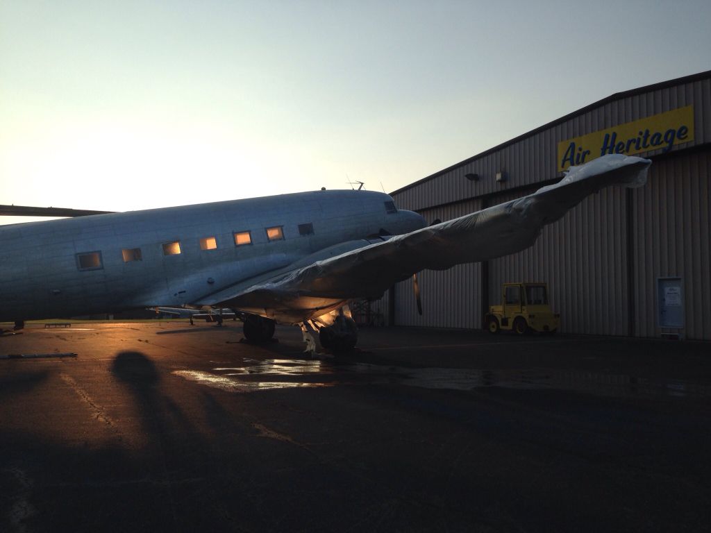

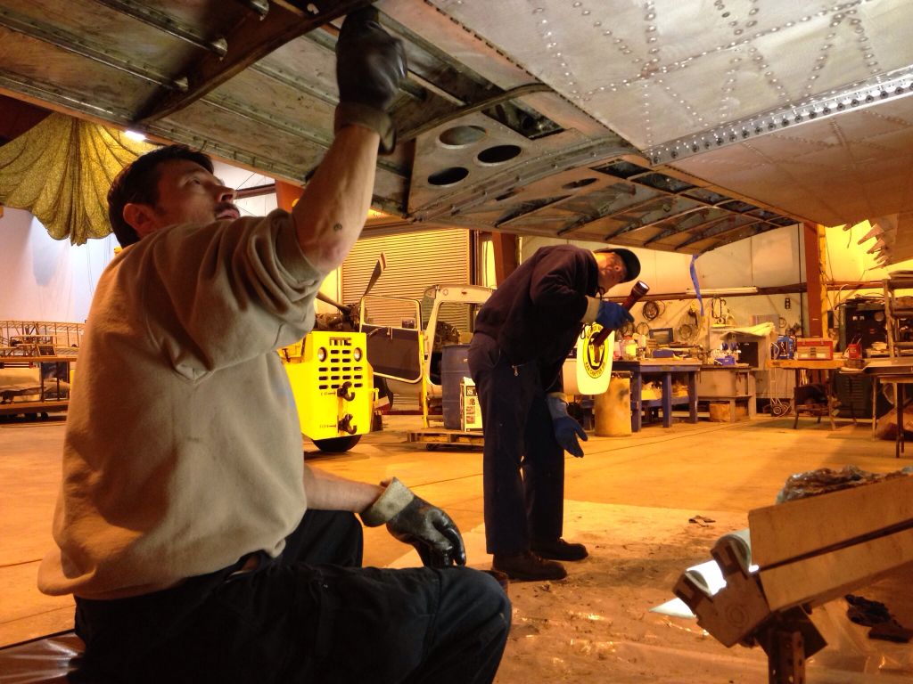

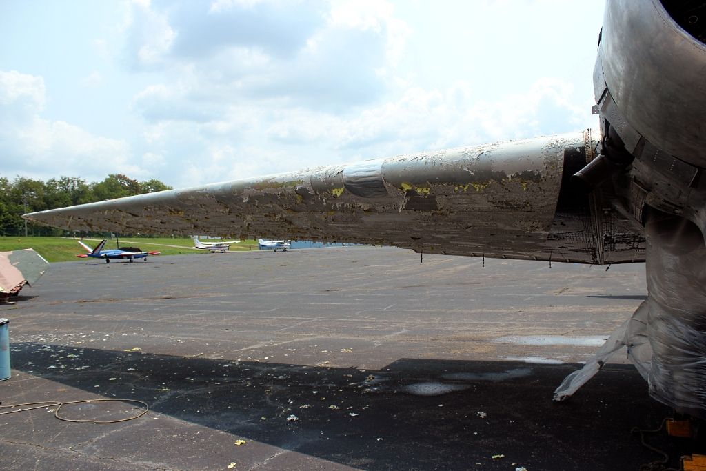

I finally stripped the bottom of the right wing, so the aircraft is now 95% stripped. I for some reason forgot to spray the area above the flaps, so I still have to do that area along with some of the black paint that did not come up, but otherwise the plane is stripped. I will hit the Flaps/Black paint next and then will be applying the stripper over the entire aircraft once more to remove any residual paint (like on the rivet heads). After that I will be time to start prepping the metal for paint.
The next day
After Power Washing

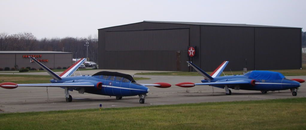

Awesome news about the paint! And great update :) Any chance of getting a close-up of that Fouga that's peeking from under the wing?

Sure fouga, there are two on our ramp (the other is parked in front of it). There is a total of six on field, two as part planes, and four that are fly able with two having been stored outside and two in hangars. The four fly able ones made up a four ship jet team that was based on the field, but none of them have flown in years.

PostPosted: Thu Aug 14, 2014 9:05 pm
Posts: 356

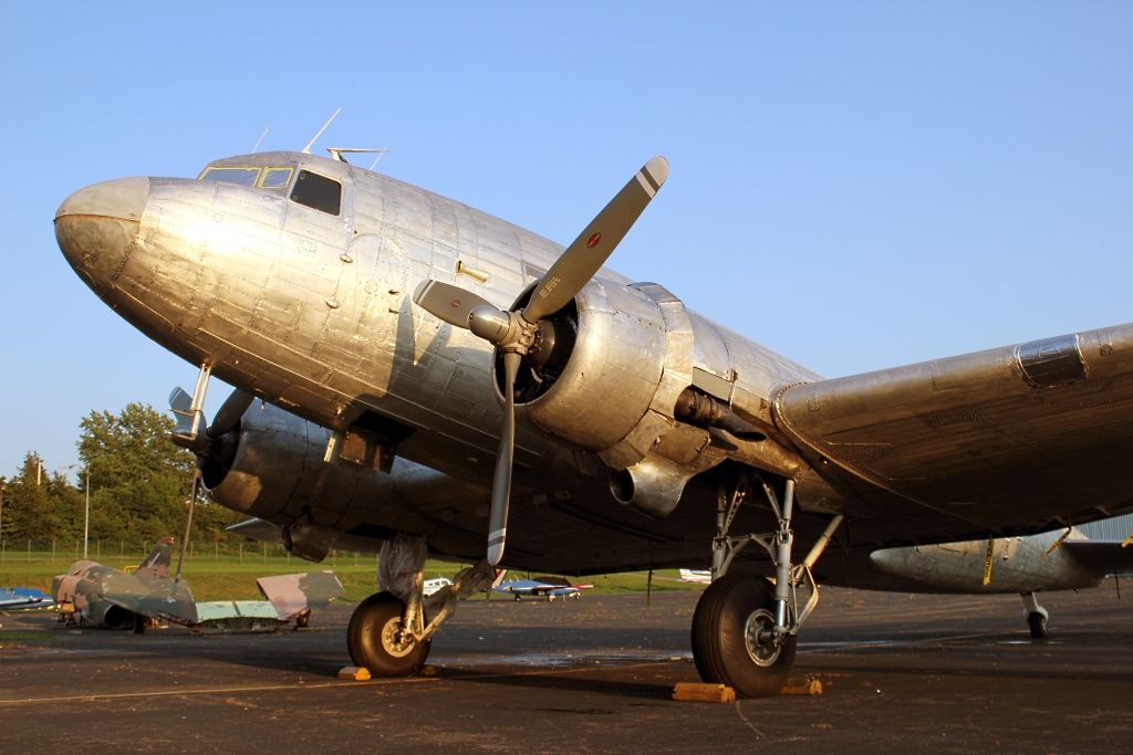

From November of 2013

Yup and there are four more on field, two in hangars and outside that are parts aircraft, along with an L-39 and maybe an L-29 still. Those two are N16FM and N908DM, which fouga told me he was searching for 908DM.
Here is a pic of the two by the F-86 which they sat under until last summer when their parking sports were acquired by the next door FBO who wanted the Tiedowns. So now they are on our ramp, for now...
Where they are sitting in those photos, there used to be two L-29's sitting. The one is now known as Raju Grace which races in the Reno Air Races.

Yup, N908DM, ex Belgian AF :D Thx!

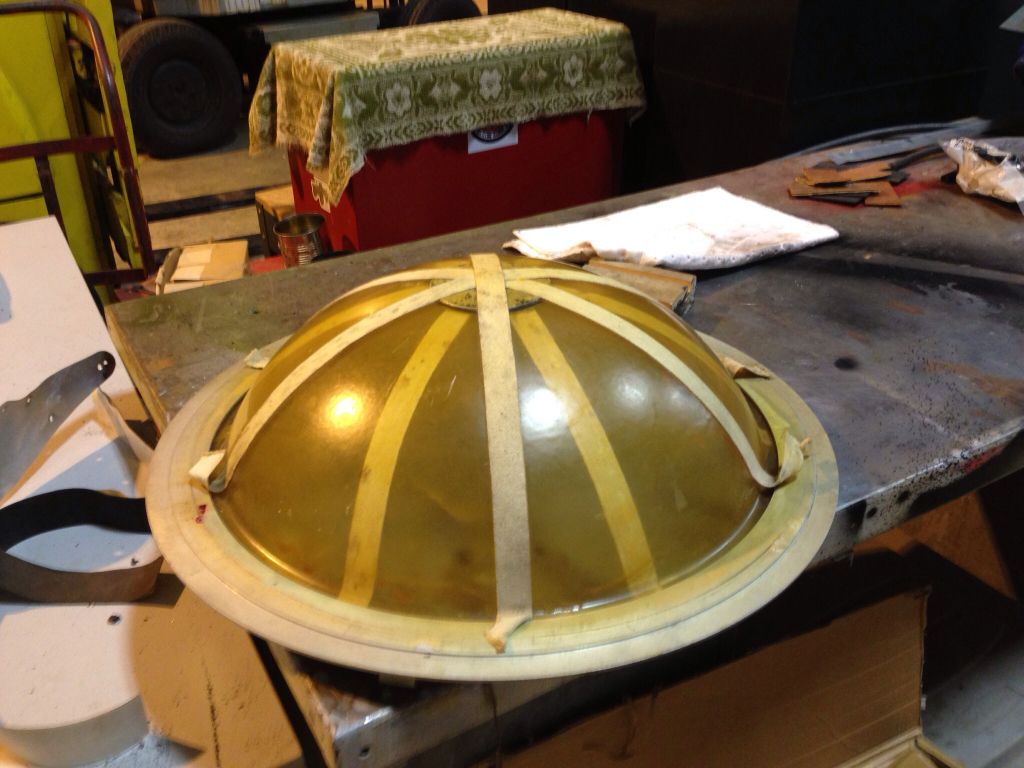

We have finally received our NOS Astrodome, though it is only the plexiglass dome, so we are still in need of the mounting base. If anyone has one available for sale or has one that we could borrow to make a copy, we would greatly appreciate any leads!

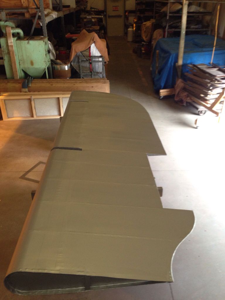

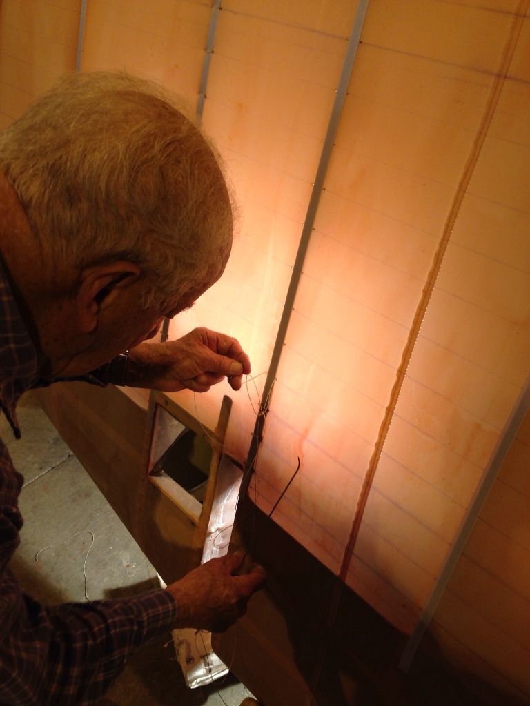

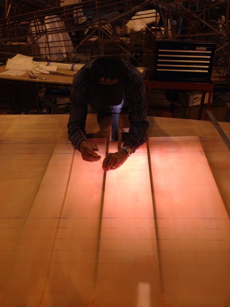

Work has continued on the Rudder. We received the frabric sleeve for covering though it didn't quite fit right, so a little bit of work was needed to correct it. However that has been done and the fabric has been shrunk already. The first bit of polybrush has been applied and dried and then this weekend the holes were poked so that the stitching can be started. Bob Morelli, has been doing all of the fabric work so far on our C-47's controls and is pictured in the photos.
Here is the Rudder after the sleeve was shrunk.

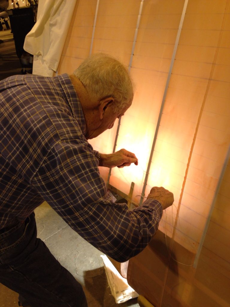

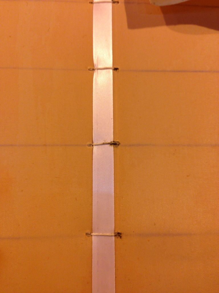

Here is Bob working on gluing the fabric in and around the area where the rudder attaches to the hinges.

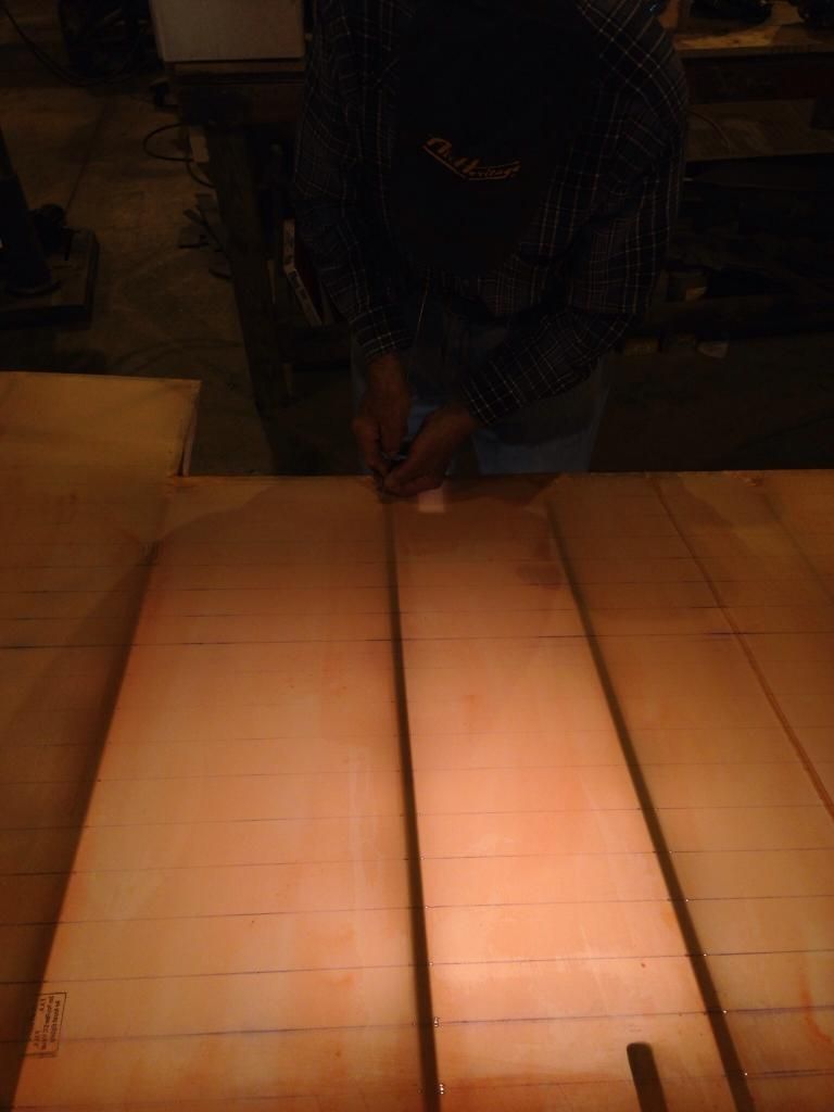

Here is Bob poking the holes so he can begin stiching the fabric sleeve to the ribs of the Rudder. He sets it up by laying out and snapping chalk lines across the rudder. Then he places a light underneath the rudder to backlight it and then he can perfectly place the holes on the lines.

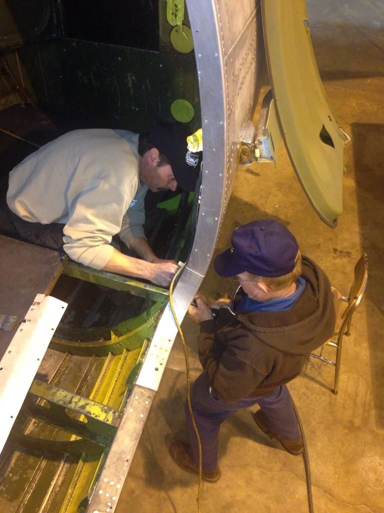

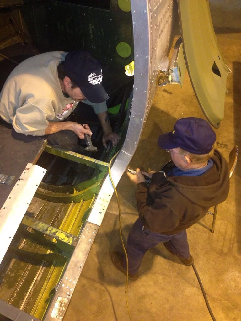

Here are two members drilling out rivets and replacing them after cleaning the sheet metal as there was light corrosion in the area.

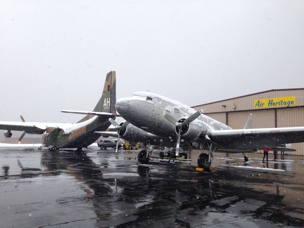

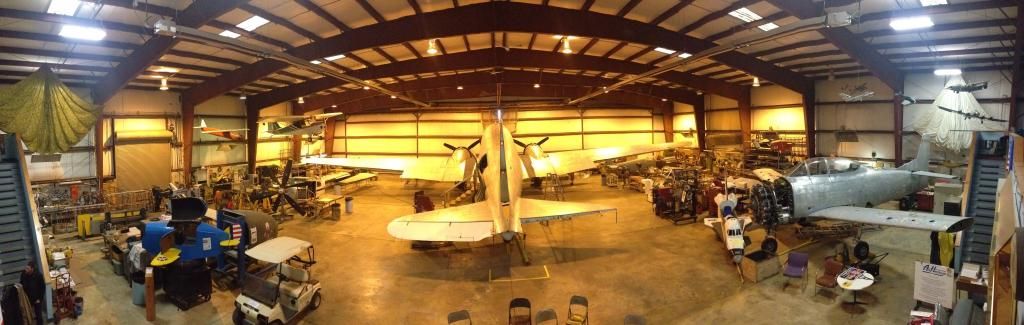

And finally, here is the L-21 sitting under the wing of the C-47 and a panorama of the hangar.

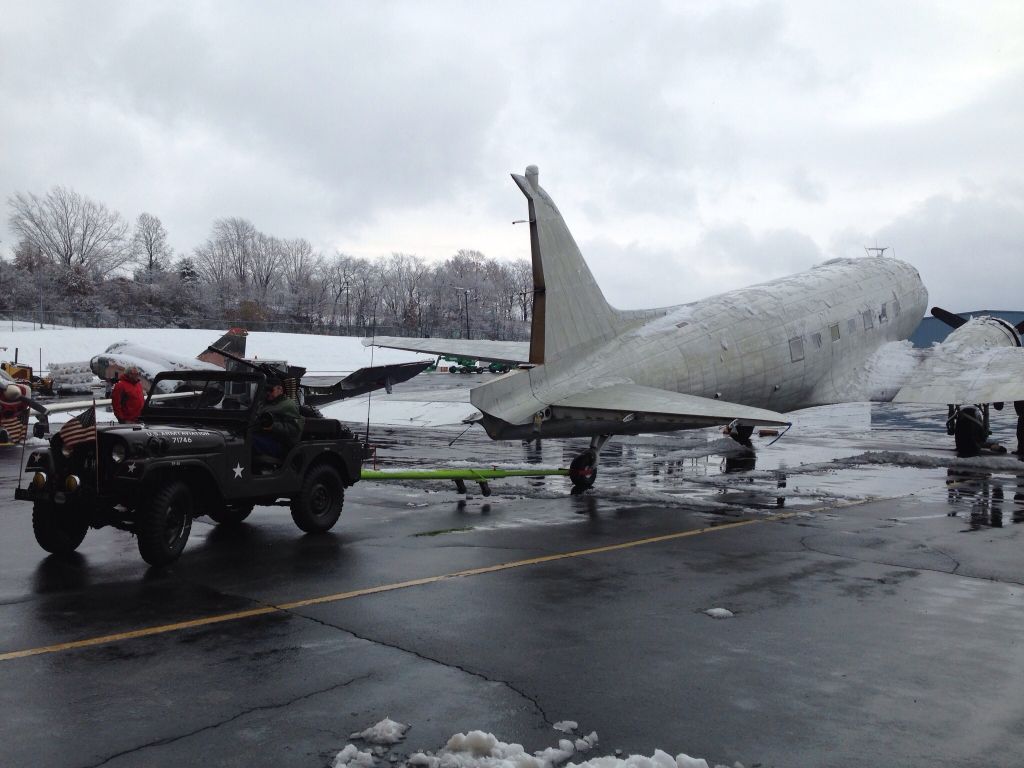

Work is continuing on the C-47, but will be coming to a stop come the beginning of January as we will have to bring the C-123 in for its annual, which means the C-47 will be going out.
Last month we pulled it out for the weekend as we were having our annual hangar dance. However, it slowed the day before which made for some good photos. Our Aircraft Tug also decided it was not going to pull any load without stalling so we broke out the Willys!
Right now, we are focusing on stripping off any remaining paint on the aircraft. The majority of it is still in the flap well, but it is slowly coming off. We are also going back over the entire plane to get anything that was missed before.

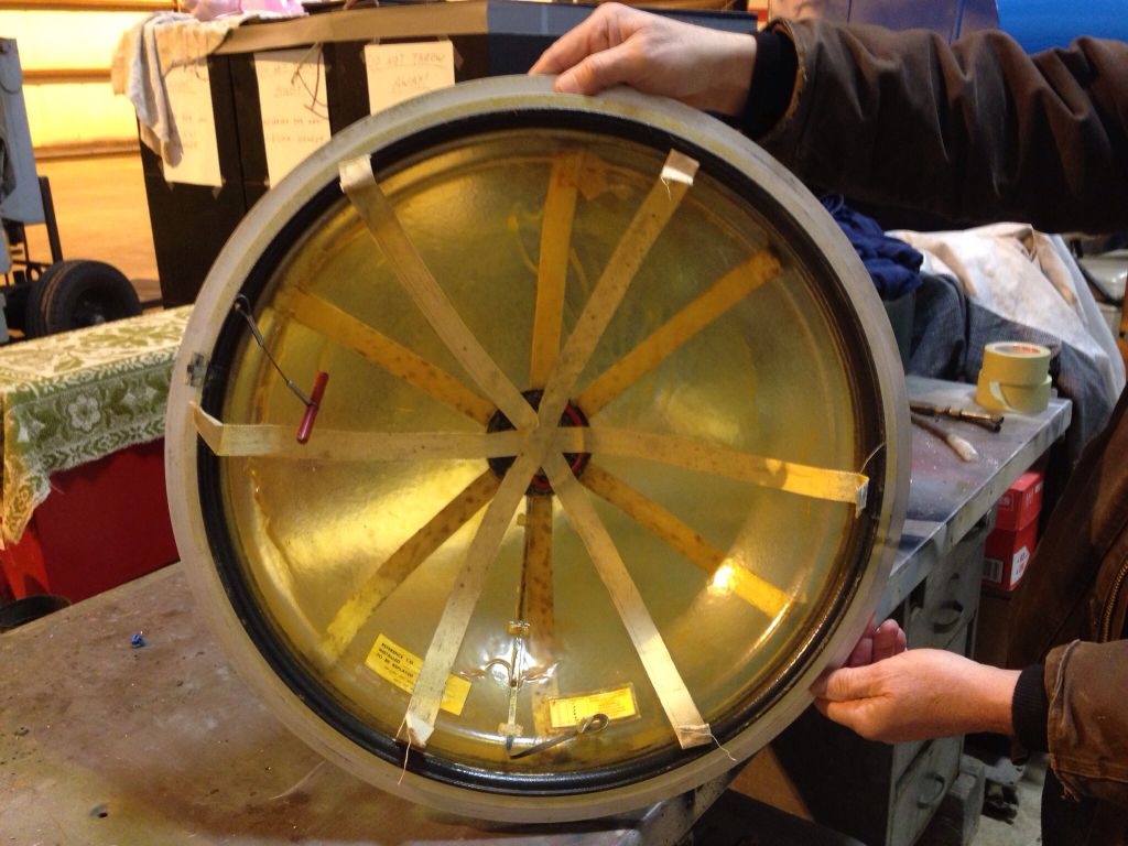

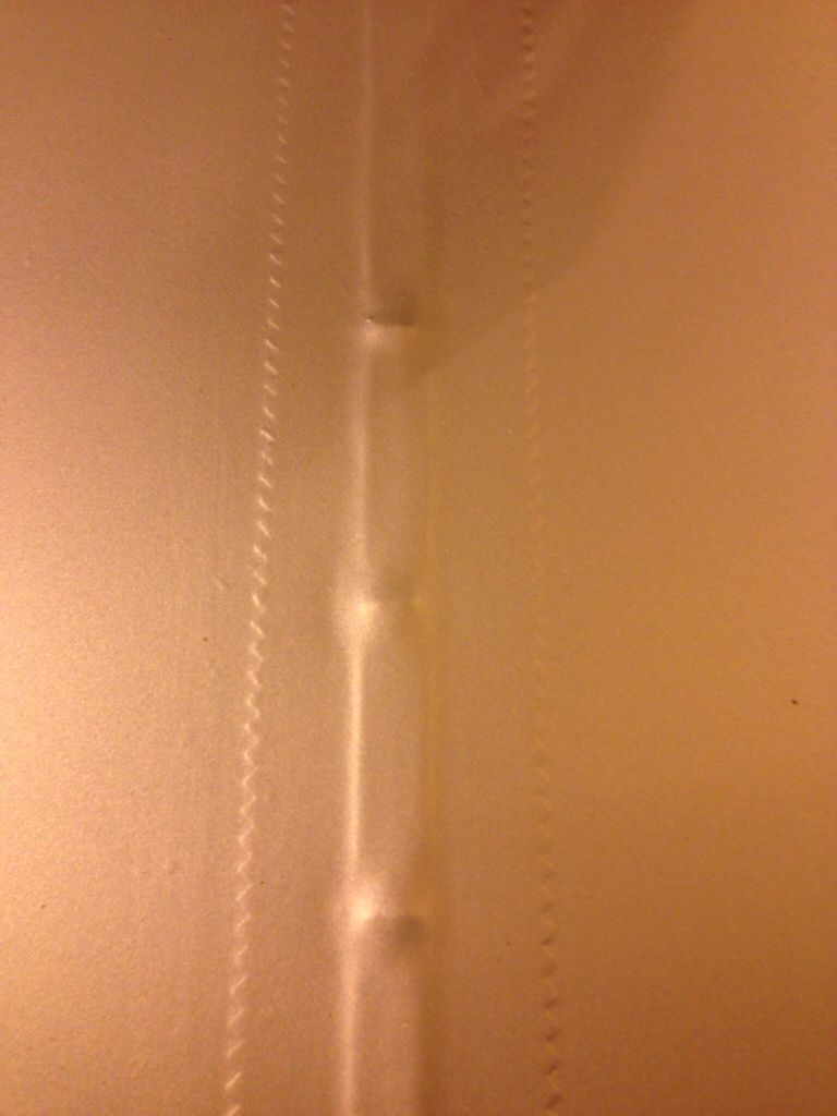

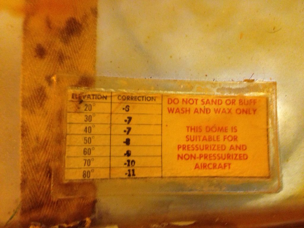

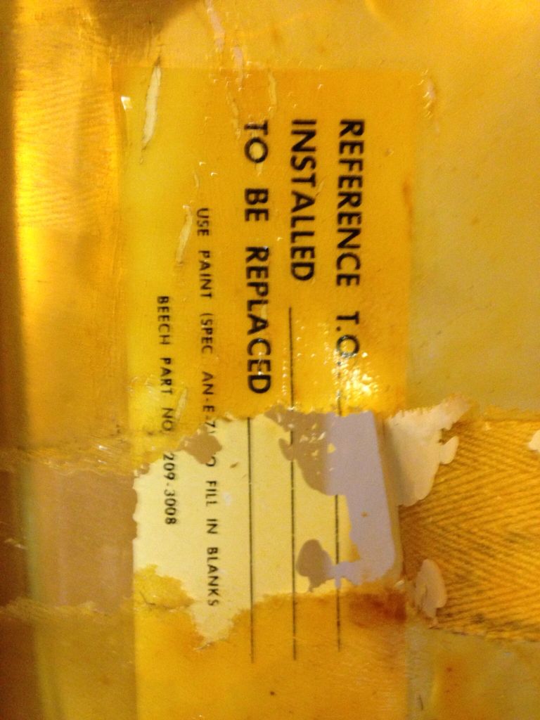

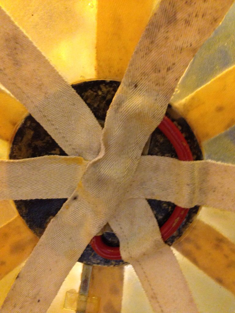

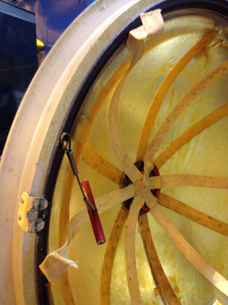

We did get our astro dome in. However, I'm not sure if it is the right one. It has a Beechcraft part Number on it (209-3008), but the parts dealer assured us it was for a C-47.
Markings and details of it

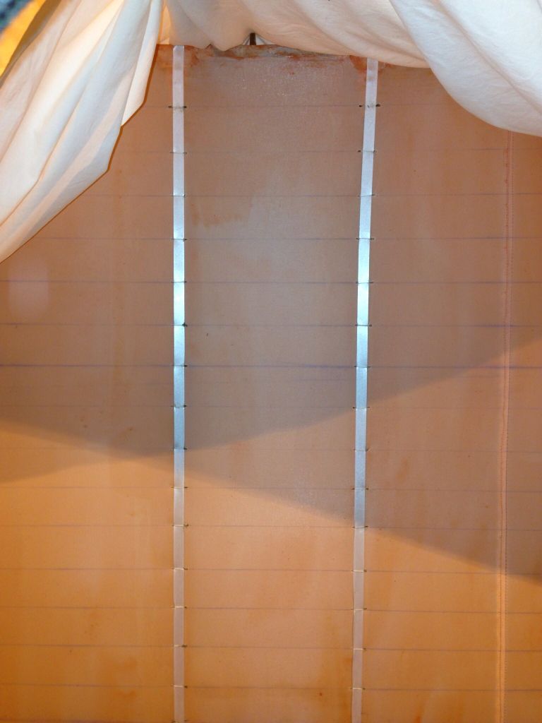

The Rudder is currently being stitched. Not too much longer and it will be finished and ready for paint.
Here is the stitchings.
And what the final surface looks like after being taped and painted. This is from the the elevator.
