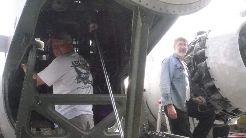

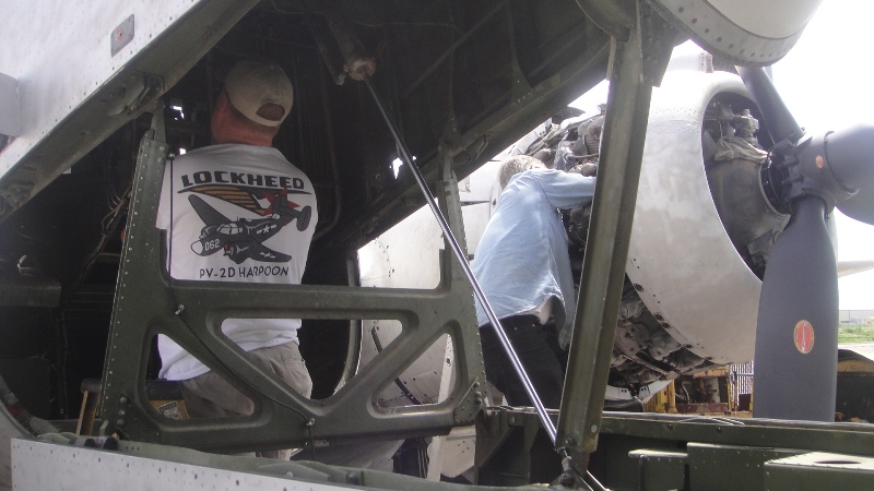

We got some more work done on the Harpoon on Friday and Saturday. Ricky worked hard all Friday on the left engine to finish up the oil leaks and getting everything secure once again.
He continued on Saturday and was joined by Ken and Murray. Here is a shot of Ken working in the nose and Ricky hard at it on the left engine:
Smile for the camera! OKAY NOW STOP SMILING AND GET BACK TO WORK!!

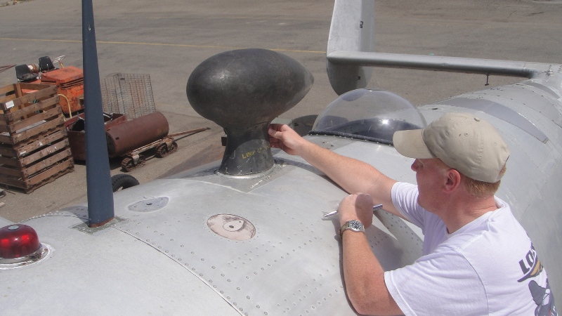

Here is Ken bolting on the ADF loop antenna LP-21-LM on its original location. The AN-104 VHF antenna can be seen in front of it and the navigators astrodome just to the rear. I finally hooked up the AN-104 VHF antenna from WWII to the comm radio and it worked perfectly. Maybe it's my imagination but to me it works better that the more modern antenna we removed and tossed in the trash can.
With all of the modern antennas removed here are three original 'protrusions' that help to restore her authentic profile. Its the first step of many. Antenna wire, IFF antenna, second AN-104, Turret etc. You can see the flare gun port covered over with aluminum tape. The shock mount/flare gun mount was still installed and was never removed. They simply taped over the port to keep the rain out. One of the many cool little original things about this Harpoon.

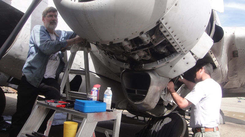

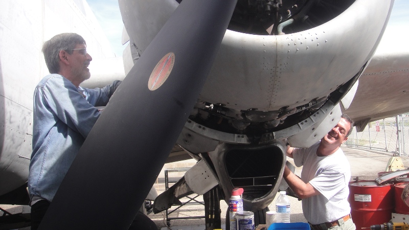

Here is Ricky again up to his elbows in R2800 as he has been for the last two days. Murray was helping out by working on the oil cooler regulator. Freshly overhauled and yet the temperature/sequence adjustment screw is frozen solid. I don't think the overhaul shop even touched it because the adjustment screw was frozen in the housing. Both sides are the same. Even the hardware is starting to rust :?
What is up with that expression on Murray's face? Can he be having that much fun working on the Harpoon? The answer is in the photo... what kind of sick and twisted people are these guys anyway?
