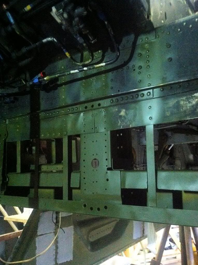

Ray is just about done with this piece of art. Shame to have to cover it up with new skin. This is the last part of the repair between the nose gear wheel well and the bomb bay. Once completed, the forward bomb bay door actuator can be installed. We are hoping to get the gear all swung and tested next weekend. David A got the hoses and connectors for the hydraulic mule to hook into the entire aircraft system all lined out. This will be another big milestone on the way back to flight. JR

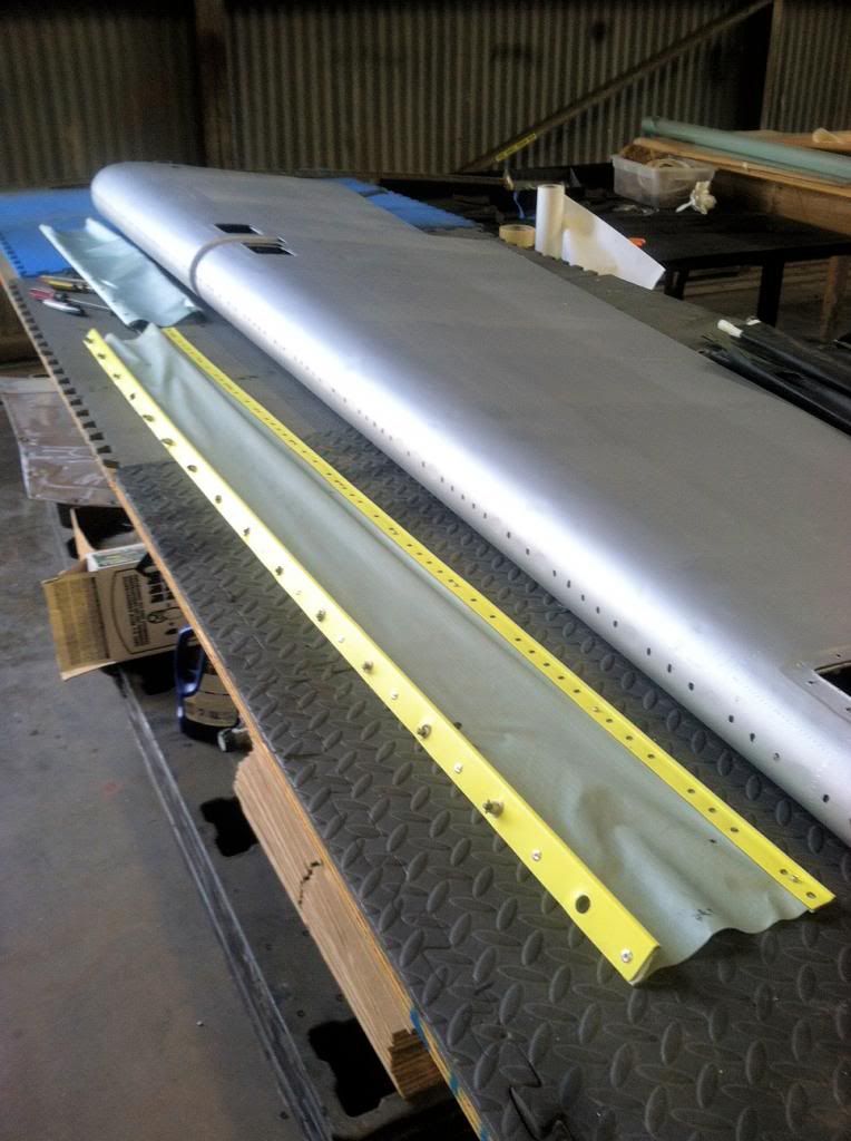

Meanwhile, the guys are building up the gap seals for the elevators. They hope to have these ready soon so the elevators can be mounted. The rudder is done so that will leave the aileron gap seals which will be the most difficult. We found one section of NOS gap seals of the four. Will have to build all of the sections though. These have zippers to join the two halves, unlike the other surfaces. It will be a tight fit to work, but all it takes is time, right! JR

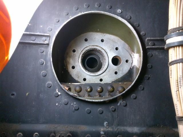

Mystery hole of the week. Where are we and what is this for? :-) The real JR poses this question! The other JR

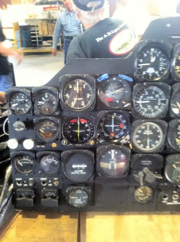

Work continues on the instrument panel. Our new remotely mounted transponder arrived so we can get that mounted and begin thinking about re-installing the panel. We may need to mount an attenna or two depending on whether the original glideslope attenna in the vertical tail is working and compatible with the new avionics. Our Sparkies are hard at work trying to trace out the wires, etc. The transponder can be controlled thru the Garmin 650 and saves some panel space. They also have to fashion a bracket to hold the new flux valve out in the wing. JR

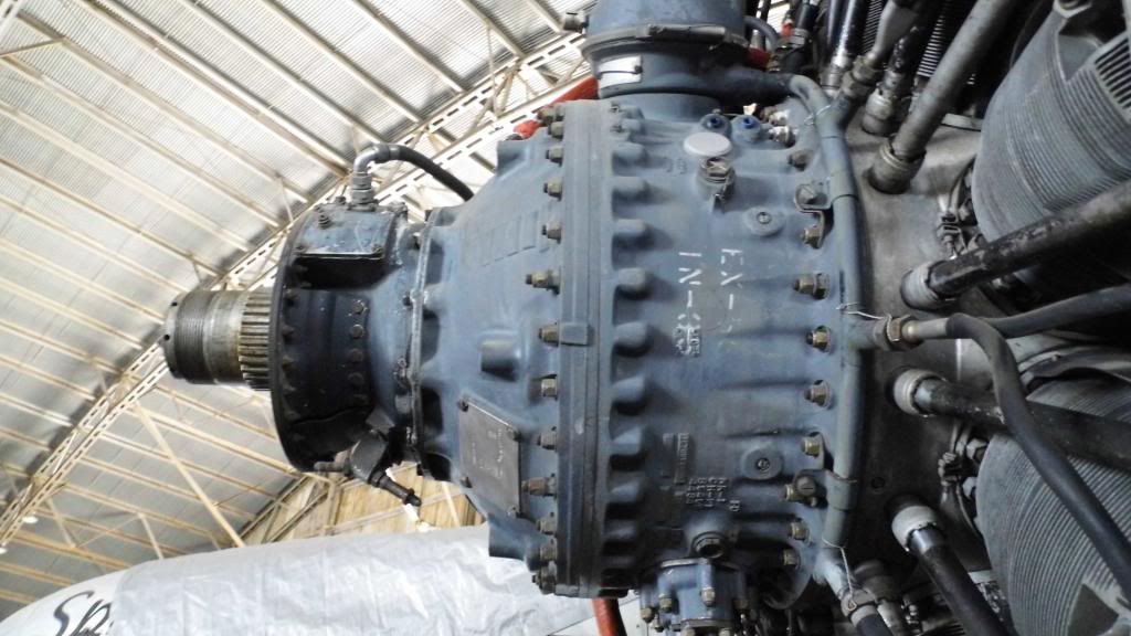

There are two interesting features about the way the prop is mounted to the engine. First one is a notation in the Dash One manual that says NOT to feather the prop if making a gear up landing. The second concerns what to expect if the crank shaft has a sudden stoppage due to loss of lubrication and the prop can't be feathered. Anybody want to venture some answers as to why or how these items came to be noted? What will happen in each scenario? Picture above has a clue for one of them. :-) JR

Having watched a gear up landing at England AFB, in 1967, I remember the rotating props just folding back as the blades made contact with the runway. In looking at the aircraft afterwards no damage was apparent to the engine. I suspect that if the blades had not been rotating the forces involved would tend to wrench the prop off the shaft or probably tear it right off the engine.
