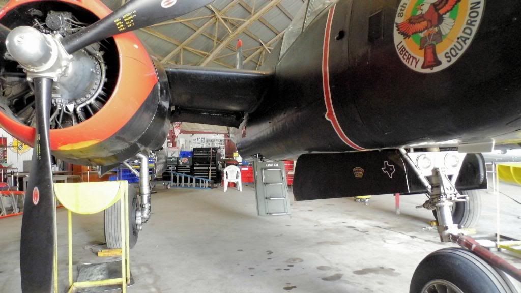

Our neighbors across the hangar have their A-26 "Texas Special" up and flying again. Tom Travis and Al Maxwell flew it down to Temple for the airshow yesterday and today. Joe Maynard, Nimrod pilot, and the real JR helped them get started and on their way. They are expected back to Meacham in the late afternoon depending on what the time the show ends. Congratulations to the CAF maintenance crew for making it happen. The other JR

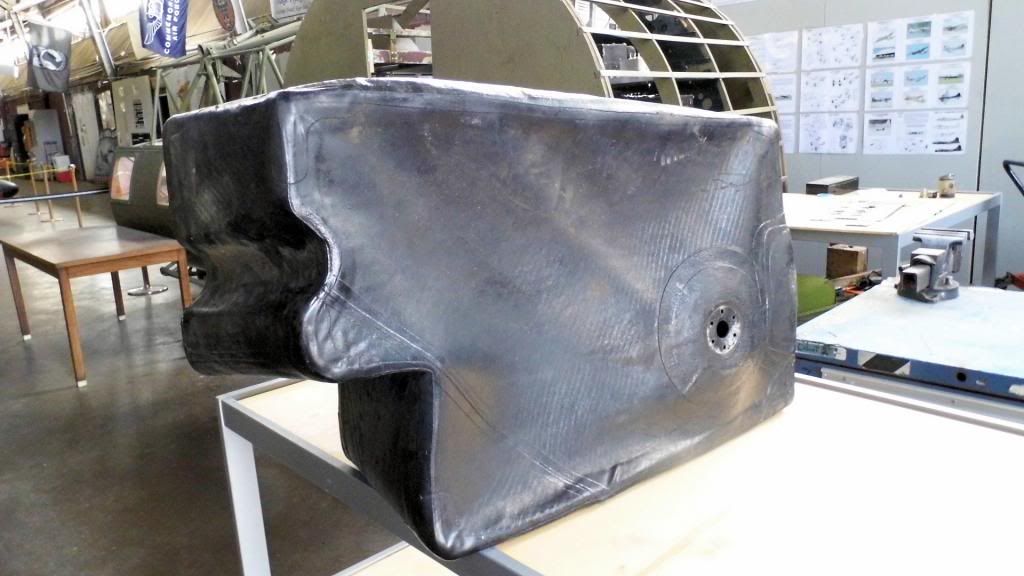

Mystery object of the week!!! The black thingee on the table. What is it and what type aircraft did it come out of... no wait, can't end a sentence in a preposition...... uh... what airplane puked this out? Is that better for all you grammarphiles? :-) JR

Fuel bladder for some plane

Self-sealing fuel tank from an A/B-26. It's about 3/4 of an inch thick. It's made from an inner and outer layer of the thin rubberized fabric that is fuel proof. The thick layer between the inner and outer layer looks like pencil eraser rubber. When a bullet/FLAK went through it, the pencil eraser type rubber swelled up to slow down/stop the leak.

Well, let me look up that word "elaborate" and I'll get back to you on that. For a Duck Drivin Lady, you sure use big words. Now, lessee... oh here it is... hmmmm, if I may "elaborate", you didn't get the pony because you didn't answer the question completely. The B29 guy came real close, his explanation was excellent, but no pony for him either. Awwww...
It is one of 3 outboard aux tanks from the B-25. Now I am done elaborating. Any questions? :-) JR
