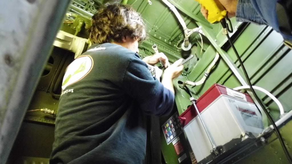

The team got the right gear installation well underway today. Denis and David hung the trapeze. The real JR and Big Mike helped out. Meanwhile Brian and Rand cleaned out the top of the wing area where a lot of media dust had settled when the wheel well was being blasted. Work continued on the instrument panel. Stan got the insides of the armor plate that goes over the inboard wing panel leading edge all primed so they look nice. More progress was made in chasing down the wiring so that the engine gauges will work properly. David B. didn't bring cookies today, but he made progress on chasing down the plumbing for the fire bottles and emergency air brake systems. His gal usually bakes us something special. Guess we got spoiled in only two weeks!! Well, you know pilots and mechanics when it comes to food!! Overall, a very nice day in the hangar. The other JR

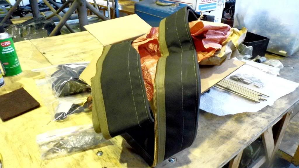

Located some genuwine aileron gap seals in San Antonio at Alamo Aircraft. We had tried to make some ourselves, but they didn't seem to be quite right for some reason. Had the dimensions all wrong since we were working mostly from a picture. Now we have a good template to make the rest. This is a gotta have item on the A-26 so we were very happy to find the originals. JR

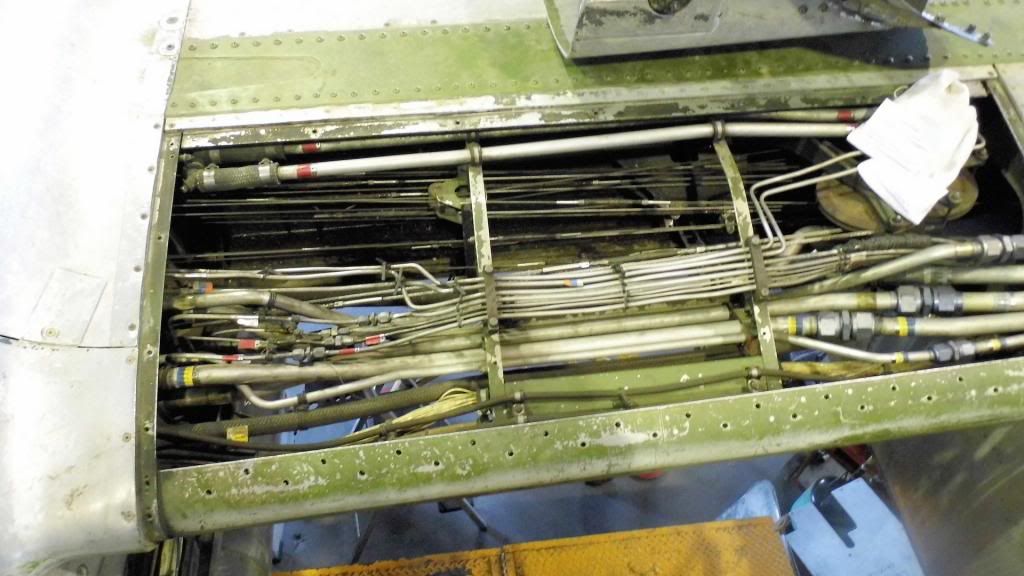

Who knew? Wow, there is a whole bunch of electrical bundles, control cables and hydraulic lines running thru the leading edge of the wing. No wonder the leading edge covers were armored. The guys are running down some of these wires to prove out the cockpit instrumentation still and they are hoping to get the panel back in place soon. We are still needing a 3 in 1 engine gauge that has the oil temp in degrees C and the fuel pressure range goes up to 30 psi. There are several gauges out there that only go to 25 psi which is ok for the stock A26, but we have different engines. It's an AN5773-2 part number, but the ranges can vary even within the part number. We found one pristine example, but the hunt for the other engine's gauge is ongoing. If anybody has such a critter, please PM me. Thanks, JR
