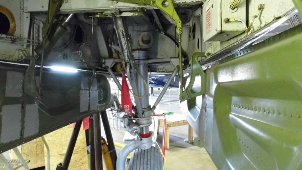

Now, about what else to do besides installation of the right main... well, back to the nose gear. We have already done considerable work in there by overhauling the nose gear, replacing some hydraulic lines and getting it ready for a gear swing test. The nosewheel will be removed and checked... probably overhaul the wheel while we are at it. Anyway, can't wait to crank up the new hydraulic mule and give her a go at swinging all 3 gear at once just like it is supposed to .... sooner or later. :-) Some adjustments may be required! Then we need to decide about how to paint the rest of the nose gear well. It's always something... and NO, Broomrider, we will not paint it pink on your behalf. Save yourself the trouble of suggesting it. OK? This is a manly airplane!! :supz: JR

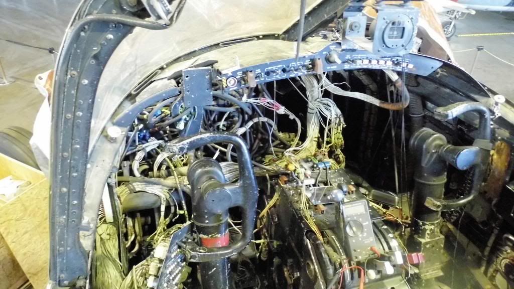

The mission for tomorrow is for our Sparky's to sort thru the rest of this wiring to see if we can install the original gauges that were substituted along the way since 1972. We found new thermocouples for the cylinder head temps in the 3 in 1 gauges so that will be a big step forward. The other business of the day will be to get that right main gear installed. Come on out and watch the team work. K lives at Meacham Field in the Vintage Flying Museum hangar on the SE corner of the airport. We love to have visitors come by and see what we are doing to bring her back to life. Every weekend is like an Easter egg hunt! We always find something else to fix! Cheers, JR
PostPosted: Fri Apr 19, 2013 10:34 pm
Posts: 2559
Here is an easy Mystery of the Week question! What is that silver knob for on the cockpit windshield sill? I will tell you what it is not... the larger silver knob forward of this and not in the picture is a hydraulic control for the windshield wiper which we have discussed before! So how about it? Any guesses?? JR
PostPosted: Sat Apr 20, 2013 3:40 am
Posts: 1635
Location: Belgium
iPod jack? :twisted:
Magister Aviation
It's all in my book
PostPosted: Sat Apr 20, 2013 6:49 am
Posts: 1470
Location: North Texas
Lock knob for removable cockpit spot light
PostPosted: Sat Apr 20, 2013 9:57 am
Posts: 2559
Yeppers, mount for the Type C-4A cockpit light... the kind on a curly cord that can be taken off the mount, changed from red to white light and zoomed to spotlight or wide area. There was one on each side. Over the HCM trail, all the lights were usually turned off even in the cockpit, but during the bombing run, the NAV could take this light and dim it way down so he could call off the altitudes since the pilot was literally flying by trying to focus on the target or marker in the dark. It would be kinda important to know the altitude depending on the terrain and the type of ordnance being dropped, huh? So this was a very important tool in the cockpit and we are looking for two good lights to put in these mounts. Gotta have it right!! BTW, K got an IPad for Xmas so if we can get a Garmin GDL 39 to go with it, we can have GPS navigation so we don't get lost trying to go across those very long distances in Texas. Far better than what the guys had back in the 1960's.... basically a National Georgraphic map and a TACAN bearing. :-) JR

[quote="NImrodA26 Does this look like what you need Jim?[/quote]
Yes Randy, that is exactly the one we are needing!! Cool... ain't it pretty? :-) JR
