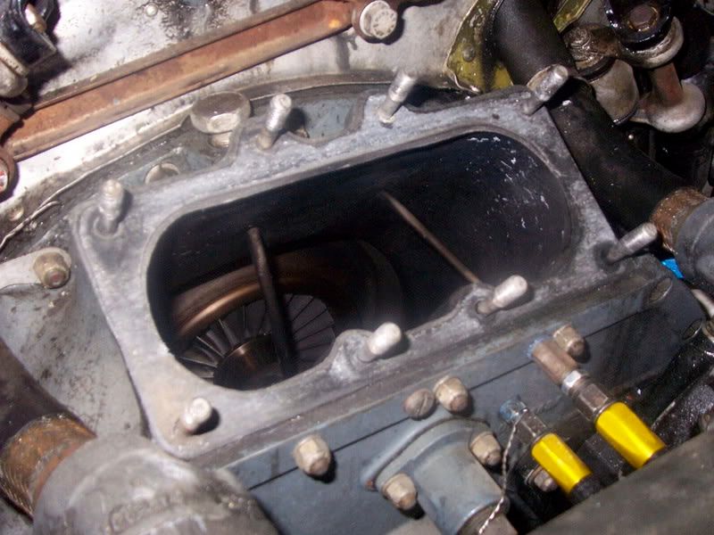

T'was a dirty job, but someone had to do it! Where the carb. USED to be!
No probs getting the carb up and over the engine mount! Piece O' Cake!
Victory! NOTE: the wise old owl tried to tell me he'd rather have a root canal performed by a Proctologist than pull a carb. off an R-1820 Dash 97
Now WHY did the Maintenance Officer think this needed re-furbishing? hmmmmm :wink:
PostPosted: Wed May 28, 2008 1:19 pm
Posts: 3442
Well, at least the impeller looks nice! :shock: You did put a cover on there, right?

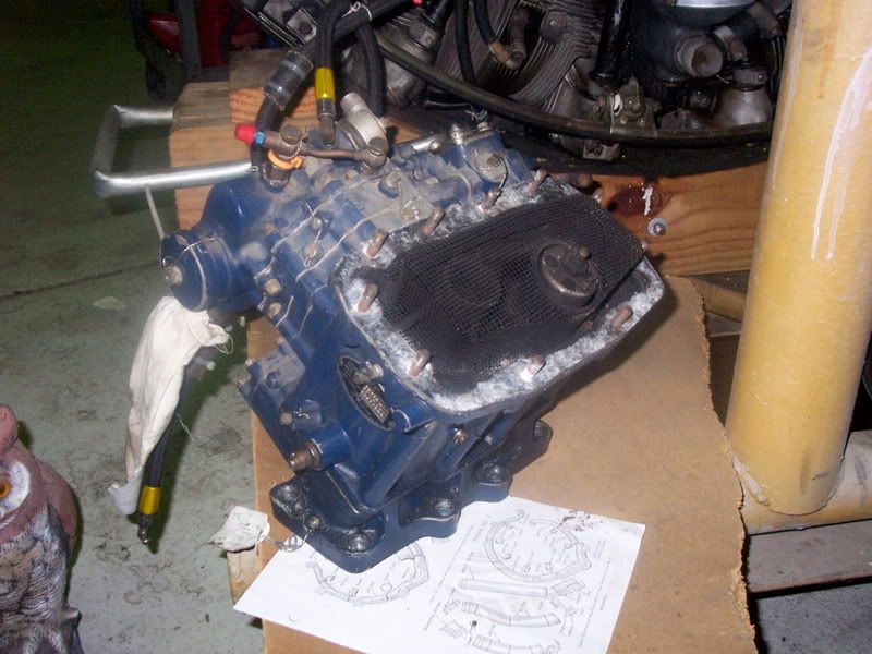

S
PostPosted: Wed May 28, 2008 1:42 pm
Posts: 1275
Location: Houston, TX
I made two intake covers and ONE discovery...
Always drill the holes BEFORE you cut the cover to shape.
I had just cut the first one from a pattern and took it to the drill press and CRRRRRRRRRRAAAACK
:twisted: the board split.
Another "Oh Fiddlesticks" moment!
But yes, I did put covers on both orifices.
I had ALWAYS wondered about the R-1820s being referred to as "turbo-supercharged" and now I know why.
The Education continues!
