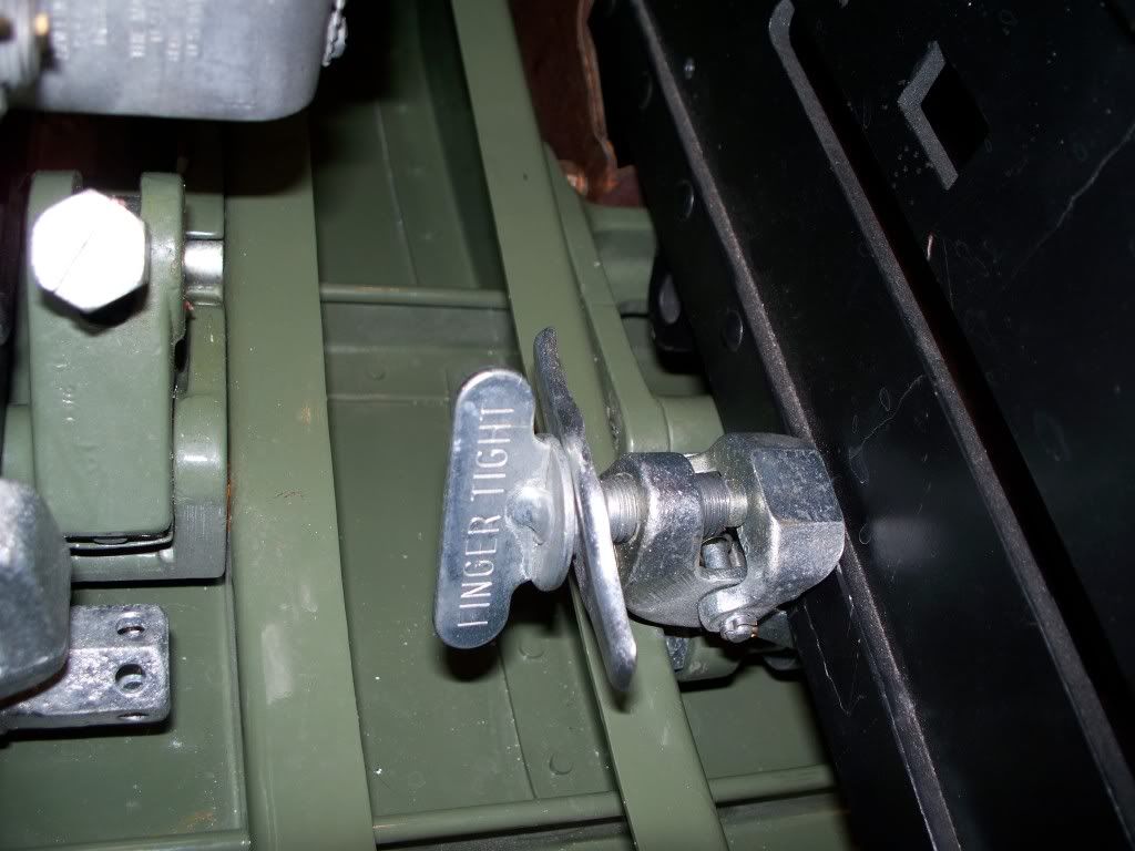

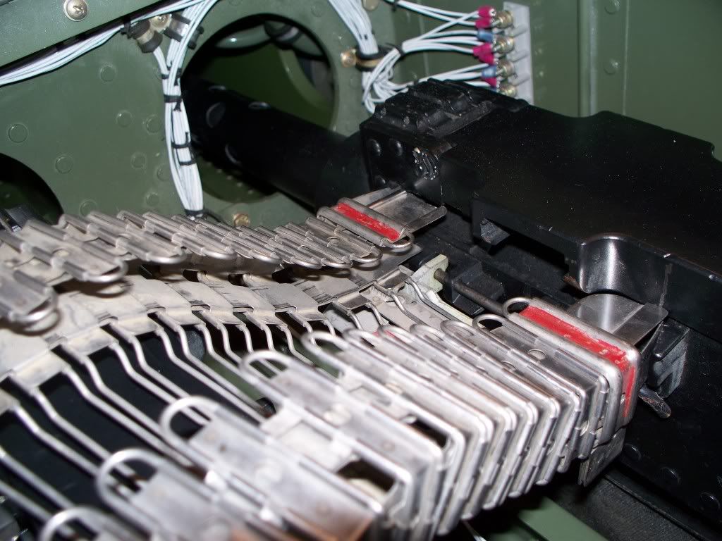

Some details of Winnipeg's guns-

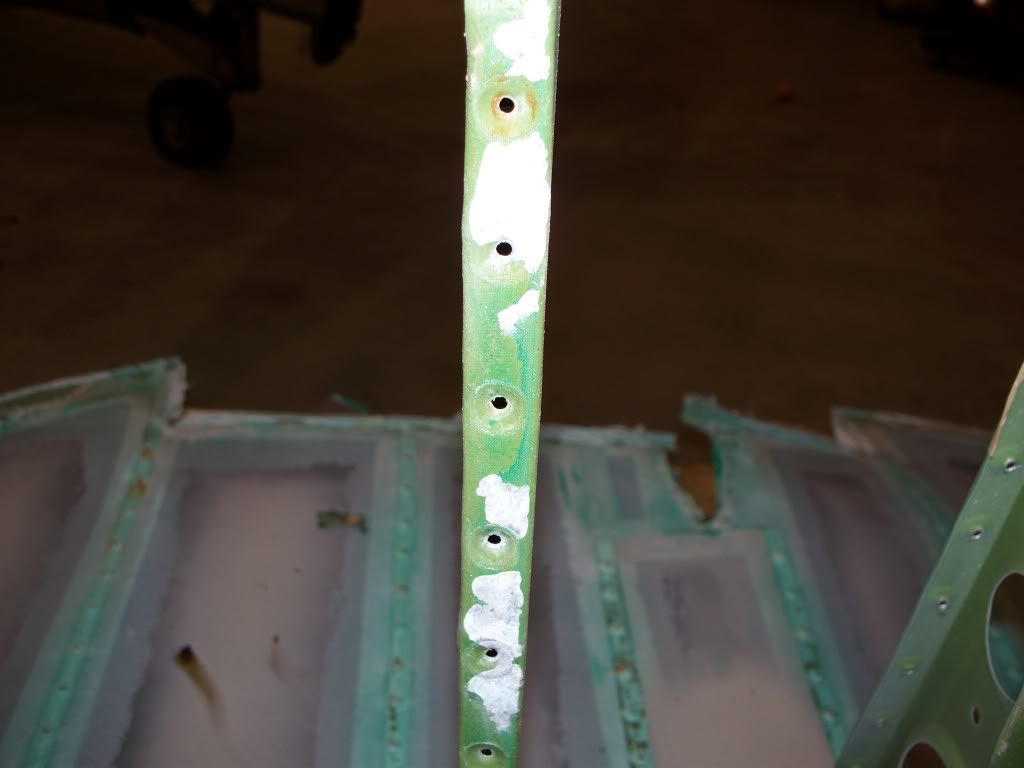

The T-6G that is here is showing old airplane syndrome-
The fabric wasn't that bad but had been done in the mid 80's. This elevator control surface seems to have been sprayed with Imron but without a primer. I have found Imron from the 70's/80's will let moisture be absorbed through the paint. I have seen bad corrosion issues in other A/C with Imron over Bondo as well. The primer actually does the protecting of the metal. In this case the the fabric along with the Imron has set up some areas of significant corrosion to deal with. Many of the washers on the screws that attach the fabric to the ribs also were rusted.
