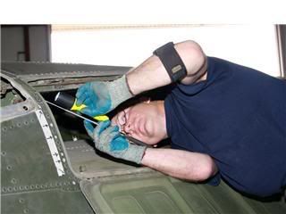

STOP CLEANING THE AIRPLANE!!!! I just found the perfect paint scheme for TR:
Princess Pat, salvaged 3/25/45. Courtesy of the 381st Bombardment Group (Heavy) website.
In fact, you need to ADD gunk for an accurate paint scheme, but that should be easier than doing this:
(Spanner cleaning, his human Q-tip description is accurate.)
Scott
