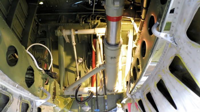

Meanwhile back on the left side, David A and company did the retract on the gear and continued working on the rigging. Big Mike is making up an independent reservoir/accumulator for our hydraulic mule to run just this gear up and down instead of possibly having trouble with leaks if we ran it thru the rest of the ship's system.

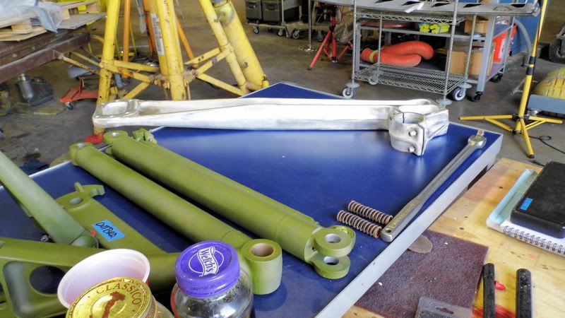

Posts: 2563
Work continues on the right gear. These springs are part of the "bear claw" in the downlock system. We suspect they may be part of the reason the downlocks sometimes failed back in the day. They are too long and over-compressed which could lead to fatigue and failure. We are replacing them with new, but will have it on our maintenance plan to change these out every 100 or 150 hours.
PostPosted: Wed Dec 19, 2012 5:49 pm
Posts: 2563
And this is what they hold tension against... the "bear claw". Yeah, I know, you were hoping it was the edible kind with all that good cinnamon coming out of every layer... Sorry, Charlie. JR

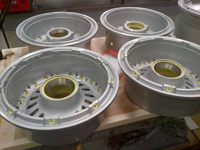

Posts: 2563
The real JR sent this shot of our main wheels coming out of paint and just waiting on some hardware to finish the reassembly. Cowabonga! Sure are pretty. Almost look gold plated??? I wonder?? Better go buy a lottery ticket me thinks to pay for those!! Wow... just a thing of beauty. The other JR
