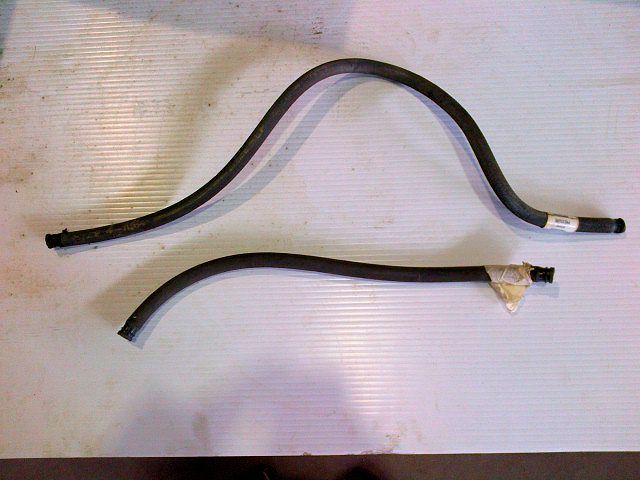

Posts: 2563
Many of the hoses dated back to the OnMark conversion to the K model. These have 1964 dates. Big Mike made new hoses to replace these and the guys installed the new ones. JR

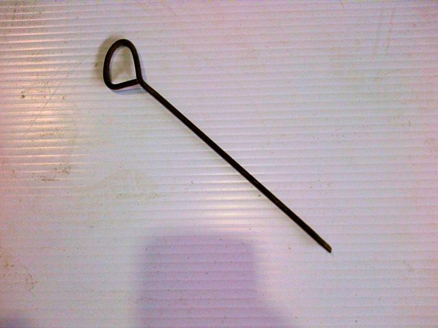

Posts: 2563
This homemade screwdriver was found in the sidewall next to the pilot's seat. No telling when it was dropped there, but it looks old enough to be from WWII. We will add it to our collection of other tools found inside the airplane. :-) JR

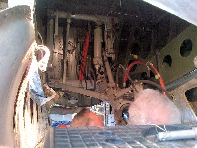

Posts: 2563
Arnold, David A and others started testing the left main gear for rigging. This is the first time the gear has been retracted.... another milestone on the return to flight! JR

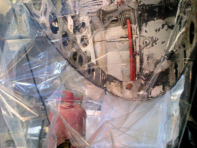

Posts: 2563
The right main wheel well has been tented and is being prepped for paint stripping. We are trying out a new plastic media to see if it does a better job. Our blaster had to be modified to use it so tests are being made to see how to best optimize it. For some reason, this wheel well does not appear to have the same layers of paint that the other side did. Maybe this will go faster. The rest of the gear was removed, cleaned and prepped for paint. We are waiting on one small package of seals to arrive so we can start the reassembly. This gear has gone a lot faster than the left one. It was in much better shape. JR

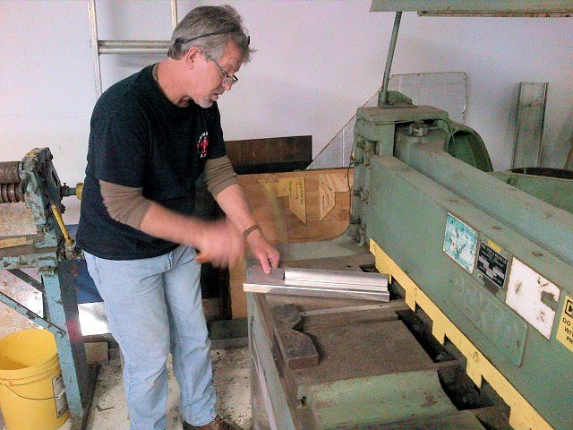

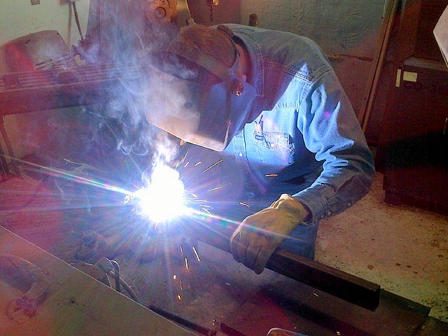

Posts: 2563
Another great talent, Ray, our master metalsmith, is making some components for the repair to the hidden damage in the forward bomb bay bulkhead. Many of the metal shop tools were not working so some of the other members of the team decided to get them all going again. This has been a big help to our team as well as the others folks in the VFM hangar who use the shop. Many thanks to Ray and team for getting us up to speed. JR
