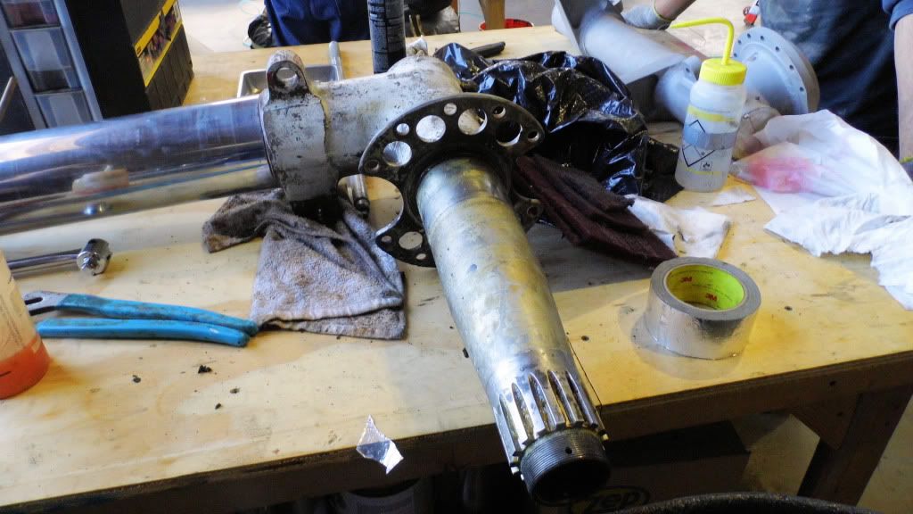

The right main gear is out now and has been completely disassembled. First reports are it looks really good. The guys are working to clean it up and get it ready for paint. Replacing some O rings looks to be about the worst of it. Much better than the left side so we may be able to get it all back together fairly quickly. The brake is in the overhaul shop and the verdict on it came back good as well. Looks like they might make the 7 Dec estimate for completion. Joy!! JR
PostPosted: Mon Nov 26, 2012 10:11 pm
Posts: 2563
Mark and several others worked on the gear and started the NDT on various components. So far no cracks have shown up. JR

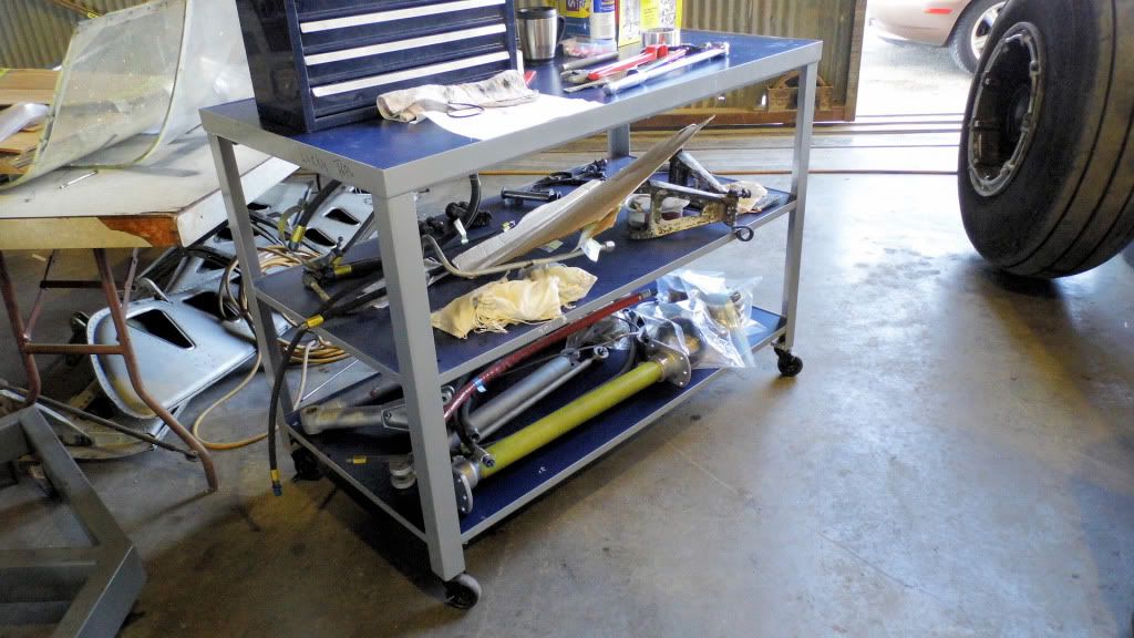

As components are cleaned, checked and prepped for paint, they start on the top shelf and work their way down to completion. Just our way of keeping track of where we are with the process and what is left to do. JR

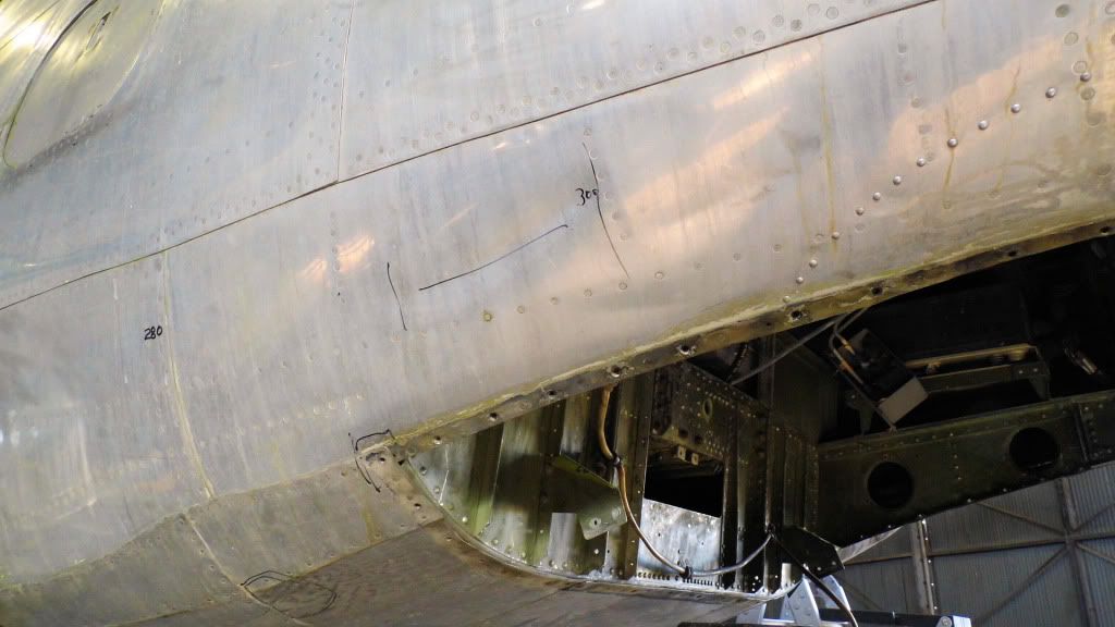

Posts: 2563

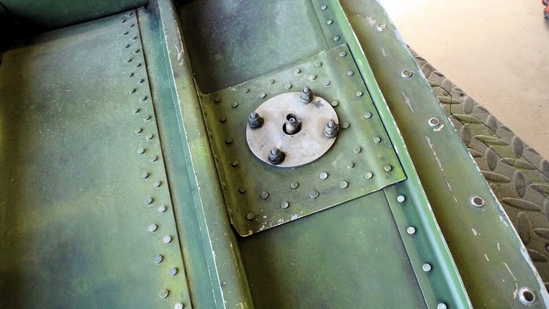

Lou and friends removed the belly skin just aft of the bomb bay bulkhead to see what was there. In WWII, there was a remotely controlled turret and the outline of it was still visible where it was removed. At one point, there was a target tow line that came out from the covered hole near the center, but that had been changed by OnMark apparently when the airplane was also configured for recon cameras. It appears there was a strike camera mounted there at one time. See next pic. JR
PostPosted: Mon Nov 26, 2012 10:46 pm

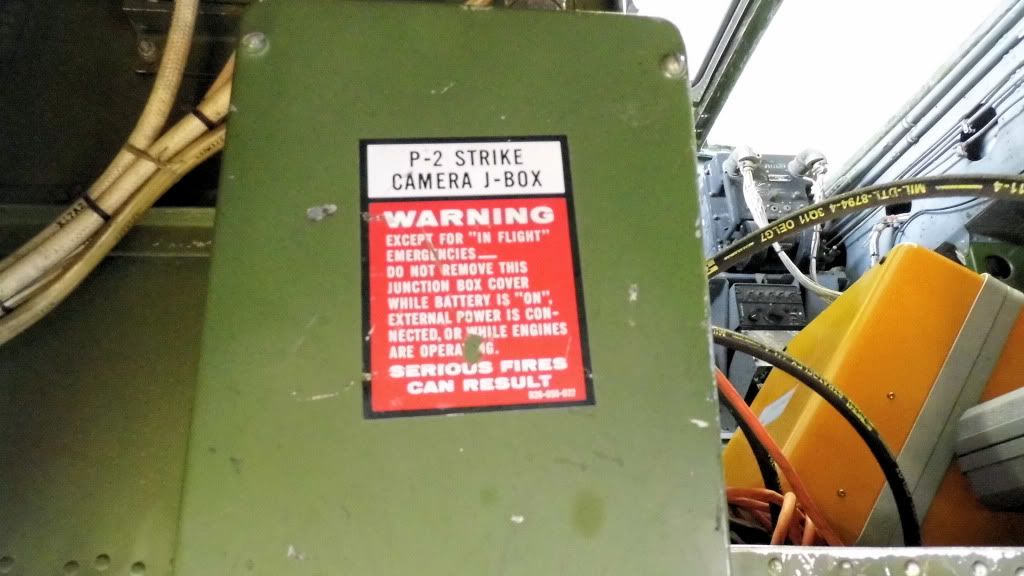

Posts: 2563
This junction box is labeled for the strike camera in the area aft of the bomb bay bulkhead and the rear gunner compartment. That compartment held many of the camera controls for recce work, but the strike camera was probably automated to run with bomb release by the pilot. Anybody have the dope on that? JR

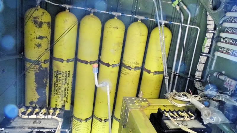

Not that we would ever get up high enough to require oxygen, but we think it would be cool to get the system functional again! These tanks are mounted to the inside top of the fuselage in the tail behind the aft gunner's compartment. This would be above the inverters and radio stacks. This will have to be something we do after we get flying again. Too much other stuff needed before we are due to fly over the Air Commando Association Memorial Service at Hurlburt AFB next October. I wonder if we could fill those things with laughing gas and rig it so it drops on the wild hogs. Might slow em down a bit so we don't have to waste so much ammo chasin' them around or risk collateral damage out at the ranch! :-) JR and the Ace Feral Hog Extermination Company of Texas!

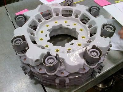

Talk about a quick turn. Brake shop at Aviall sent picture today of our right brake all finished and ready to pick up. Unbelievable 7 day turn around on a complete overhaul. They had experience with the other side brake and all the parts needed this go around, but their crew had a special reason to get it prepped and ready for the MAN. See next picture... for the rest of the story!! :-) JR
PostPosted: Fri Nov 30, 2012 10:19 pm
Posts: 2563
Wayne is the MAN!! He is a VN Vet and he wanted this brake from a VN era airplane to be the last brake project that he did before retiring from Aviall. His last day is Dec 7, but the team got it prepped so fast because they wanted to give him time to finish it before that date. Talk about teamwork, they got it done in record time. Too bad the HeiferBoys can't take a lesson from them. :-) Many thanks to the guys at the brake shop. We are seriously indebted to you guys... and Wayne in particular for helping us out. We will make sure yall are invited to see the A26 fly! Mah best! JR
