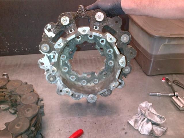

This is the right brake assembly split open for overhaul. It has been a long time as evidenced by all the crud. However, it was mostly superficial and the housing cleaned up rather nicely according to the brake shop guys. No show stoppers so far! JR

The small parts were run thru the cleaning process and the magnesium housing was reported to be in remarkable shape... considering it is magnesium. It cleaned up nicely as well. JR

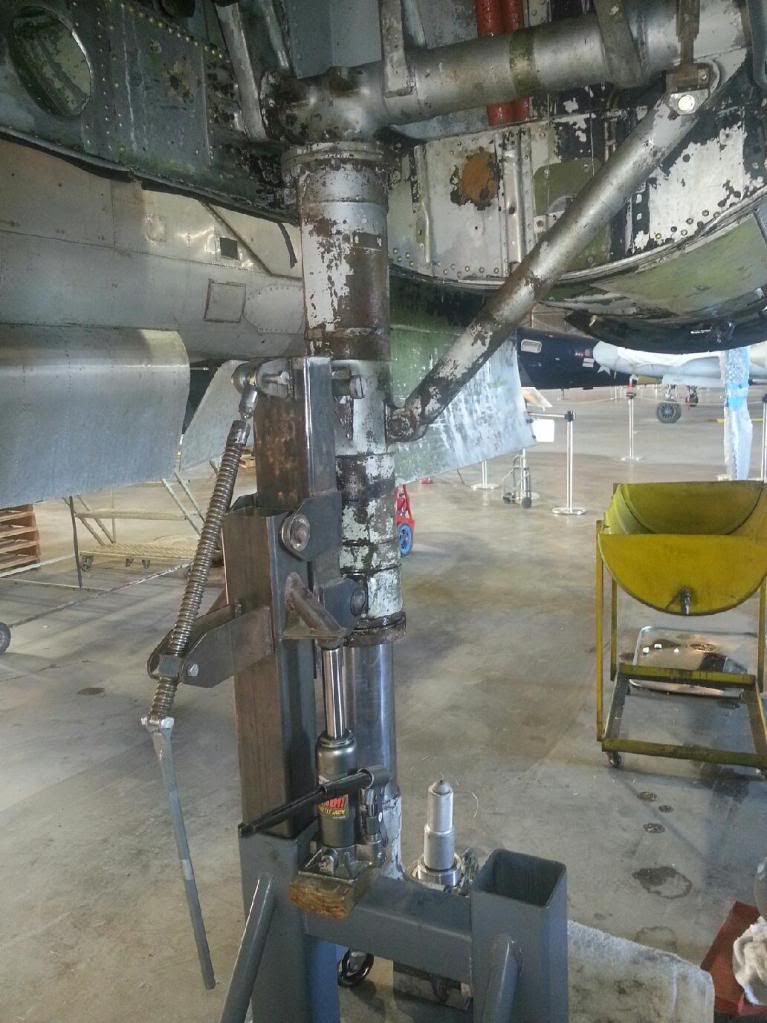

The right main gear was made ready to pull and this was completed. Following shots show the disassembly. It is turning out to be in much better shape than the left side.
The real JR thinks we can have it back together within 60 days. Yessssss! A plan comes together. The other JR

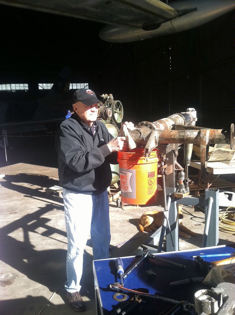

Posts: 2563

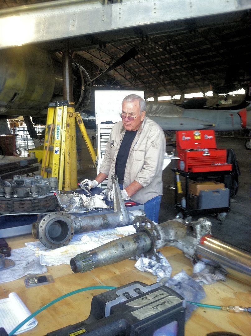

Joe Maynard, one of the original Nimrod pilots, helps to take the gear leg apart. We are very happy when Joe shows up as he is such a wealth of knowledge about A-26's. He flew one of the airplanes over the Pacific via many island stops to get to NKP. That alone is quite a story. They were more concerned about running low on oil than fuel. Note that our Floor Mgr is keeping a watchful eye on the gear work. :-) JR

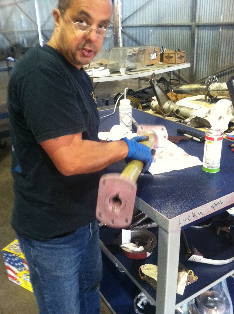

Why the look on Arnold's face? Well, it seems the Floor Mgr was not giving his approval of what Arnold was doing with the gear. This was later resolved as usual by the real JR. Work proceeded. The other JR

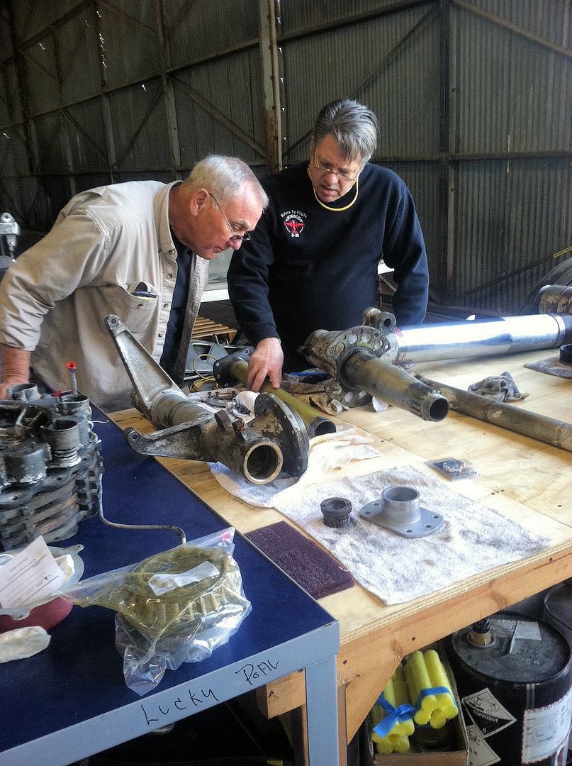

Posts: 2563
The gear is looking purty good at this point as JR and Arnold inspect it. There are a few superficial pits that need to be polished out, but it looks like at this point that we won't have to send it off for plating like the other side. Keep fingers crossed for us! JR

JR: I recognize the name on that table.......Is Lucky still around? I haven't seen him in eons....
PostPosted: Sat Nov 24, 2012 12:02 am
Posts: 2563
Lucky dropped off that table last summer as best I recall. Have not run into him since. But we will have a full crew on Saturday working on the A-26 and running pneumatic lines along the side of the hangar. They installed the new motor on the air compressor today along with about the first third of the lines. It will be extended all the way to the front where the B25 is parked so they can get started on it after the New Year. Tomorrow we are having homemade stew and cornbread for the team. Lots to report after the work tomorrow. Stay tuned. JR

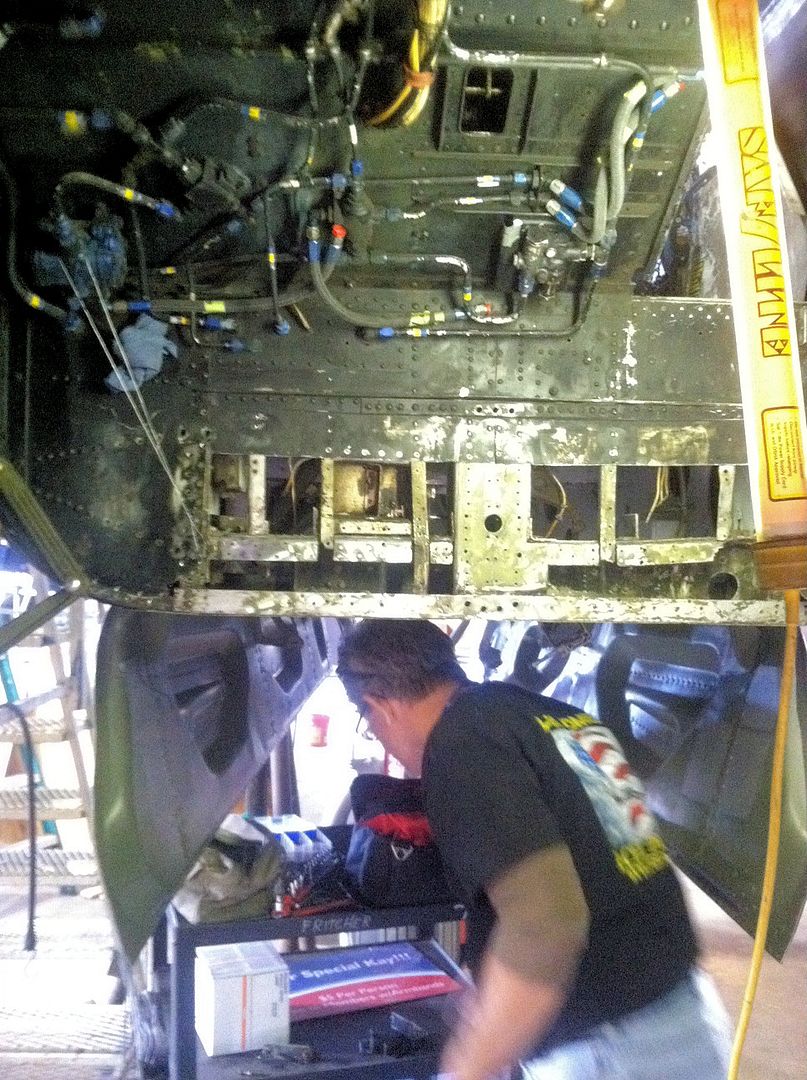

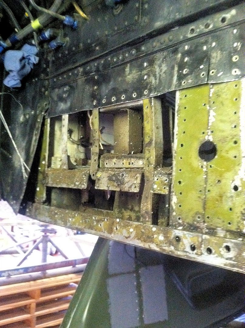

Ray found an "oh oh" when he removed the skin from the foward bomb bay. There was some crush damage from the gear collapse in the structure. We can fix it, but may delay us a bit. JR
PostPosted: Sat Nov 24, 2012 9:32 am
Posts: 2563

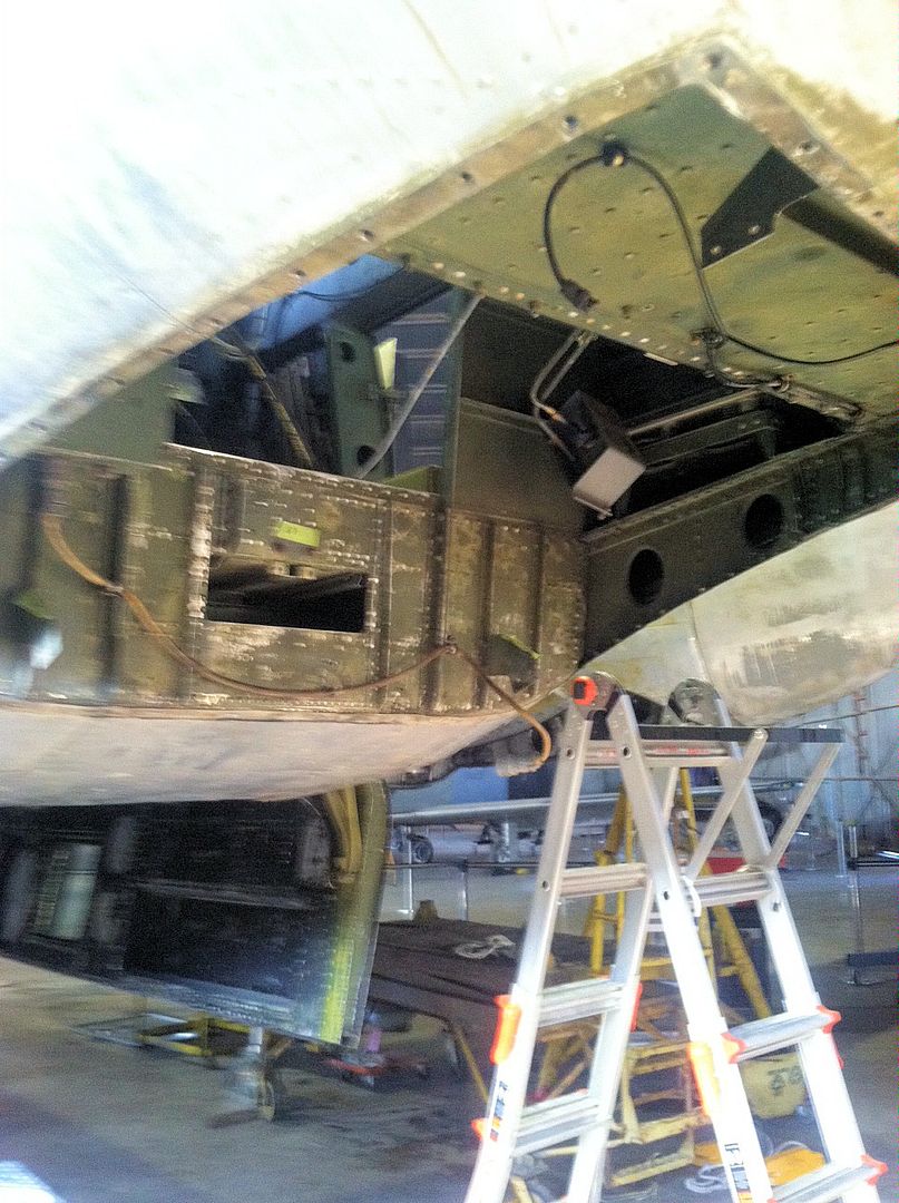

This is another view. Interestingly enough, on the other side of this structure, we found the remnants of the spoiler system that actuated when the bomb bay doors were opened. These disturbed the air flow such that the bombs would not be blown back up into the bomb bay when the airspeed was above 240. We have posted pictures of these in the past and speculated on whether to reinstall them. There is not enough of the system left plus it creates a slot where a lot of unwanted dirt, moisture etc can enter the structure. It is almost like leaving a window open. The consensus so far it to leave it covered up. JR
