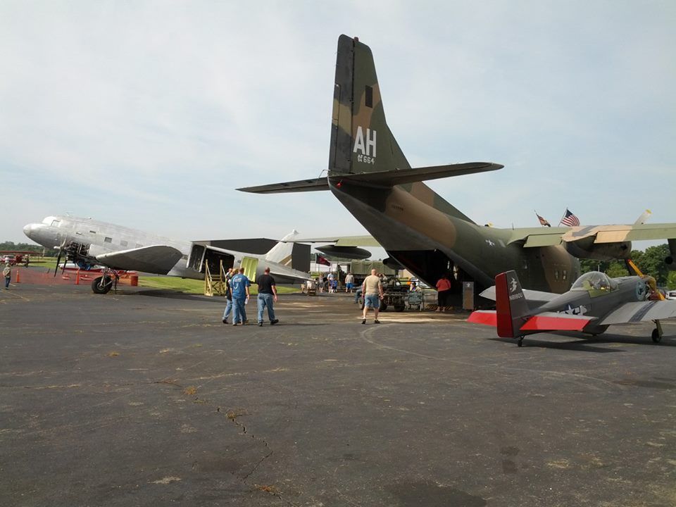

Prior to Aviation Appreciation Day (AAD), the rudder was taken off the plane and was stripped of its fabric. So far, it looks to be in very good condition, but it has not had a detailed inspection yet. Hopefully, it will just require stripping the old primer and repainting and then recovering.
Also here is a pic from early morning on AAD before the large crowd showed up. All of the photos so far in this thread have been mine, however I was so busy during the day, I never took any photos so this photo is not mine. However, it was uploaded onto our facebook page by one of the other page moderators.
She is once again back in the hangar to have work start back up again tomorrow.
Also, only 22 days remain on our fund raiser for "Luck of the Irish". So if you already haven't donated, but can spare a few dollars, a donation would be greatly appreciated!
