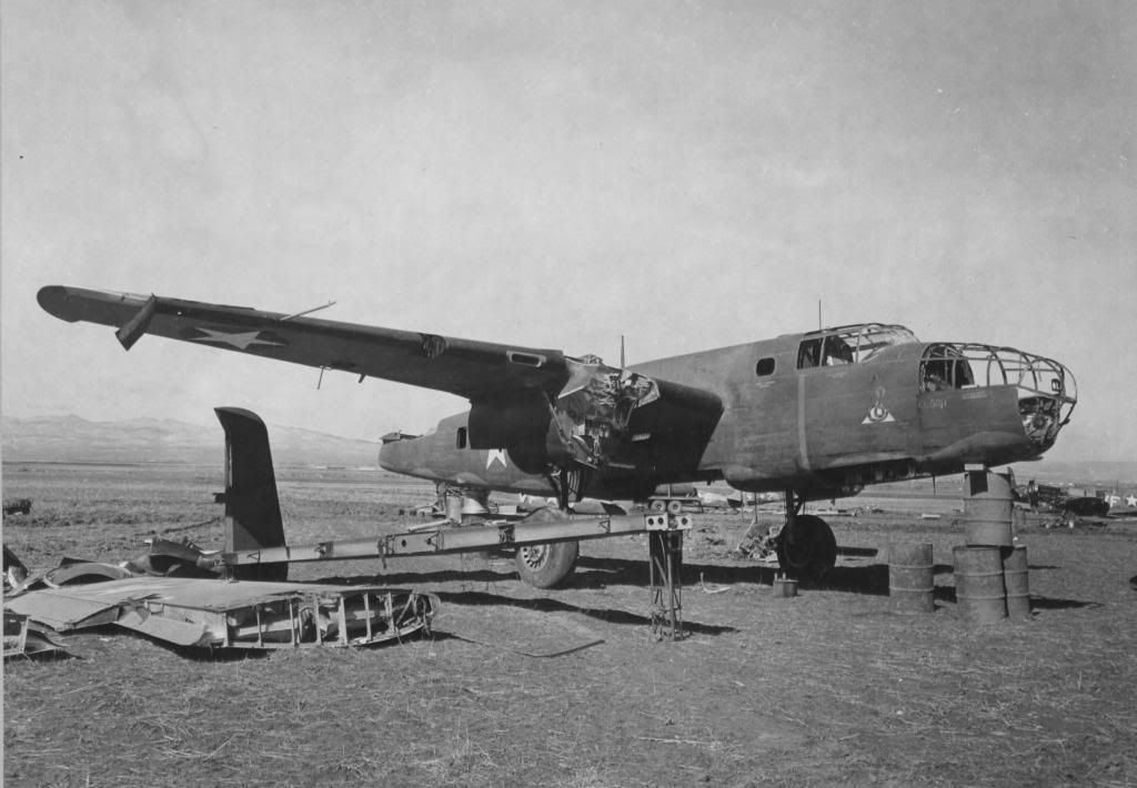

Love that nose gear. We would have lost the war if we didn't have all those 55 gal. drums for workstands, ladders, props, etc.
Amen to that!! And they're still just as equally useful today :mrgreen:
