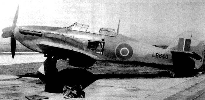

I would think you would calculate the CG change before you started the modification. Besides, it seems there was a wartime conversion already done, unless the photo above is a Photoshop job.
If this was built up from a wreck, it may still have the same count of original parts either way. Personally, I'm hoping they make it into a twin-Hurricane to overcome the CG issue.

bdk wrote:
...unless the photo above is a Photoshop job....
PHOTOSHOP?!?!
This time you've gone too far! Prepare to meet your doom!
Not only did the USAAF fly two-seat Hurris, but they painted them...
with...
SHARKMOUTHS!! (Ha Ha! Endure the full fury of my wrath!)
It seems the three squadrons of the 350th FG each had their own 2-seat "Hurrihack".

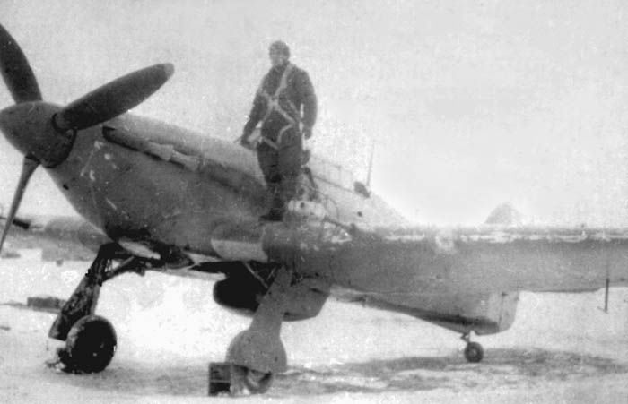

And if you tire of these schemes, the Russkies even converted some as weather ships post-war...this from 1946:
