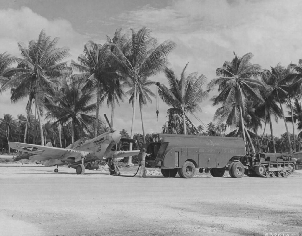

About servicing the struts with compressed air; it was a common practice and if I'm not mistaken it still is. I know nitrogen is the preferred gas to use primarily because its dry whereas compressed air will likely introduce moisture. I have 4 different air compressors used for struts. The first is just like a bicycle pump except shop air is used on the inlet side instead of ambient air. Hook up shop air and pump on the T handle until you achieve the desired strut height or you pass out which ever occurs first.
The second is a portable Aerol pump that uses the same shop air input principle but instead of the armstrong method the piston cycles back and forth pneumaticly. This type of pump actually came on the early Cletracs that used a two stage compressor so the Aerol pump would serve as the third stage. The later Cletracs had a three stage compressor driven off a PTO which is the third type we have.
The fourth is a bit more modern and it came from Travis AFB where it was used for servicing C-5 struts. The guys in the squadron maintenance said they called it a high pack. It is a trailer mounted and gas powered unit that puts out 4000 or so psi at 7cfm. It has a serious air separator and filter so you can keep the inside of he struts water free. Cheaper and more readily available than using than a lot of nitrogen I suppose.
The Cletrac in the P-47 shot has a field mod oxygen tank mounted on the right side for servicing the low pressure oxygen bottles in the aircraft . On the left is a similar factory installed air bottle that acts as the receiver for the high pressure compressor. It is this system that i believe he is using to service the struts.

I just had to bring this topic back to life so I could add Mark's photo showing the Cletrac towing a trailer tanker
