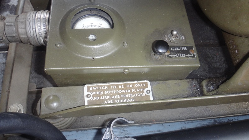

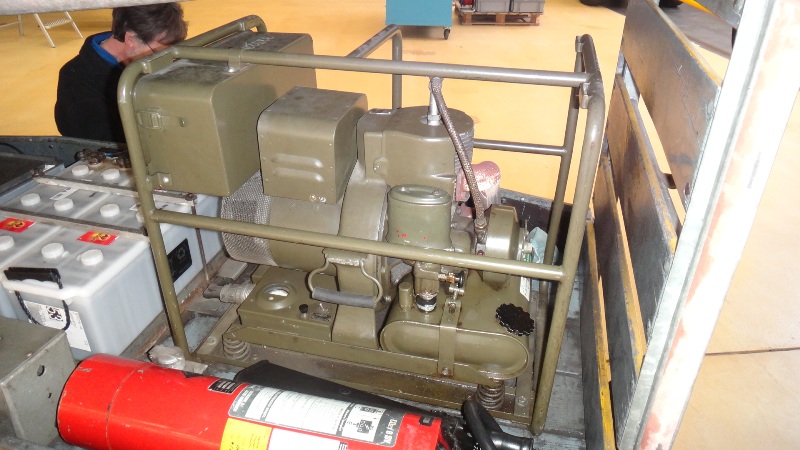

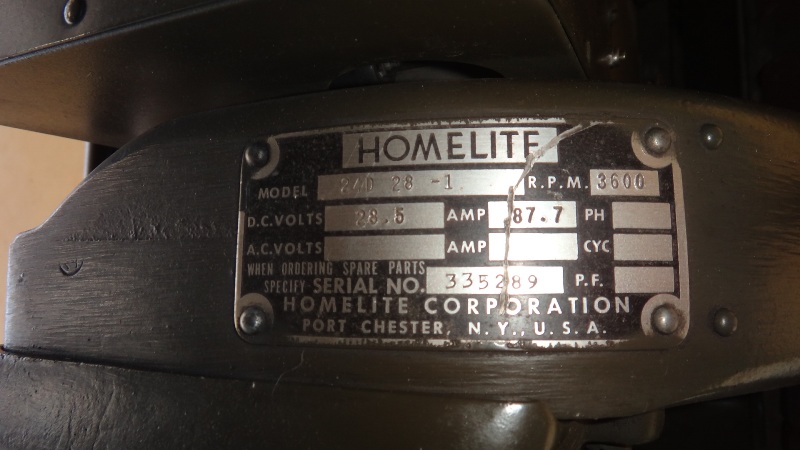

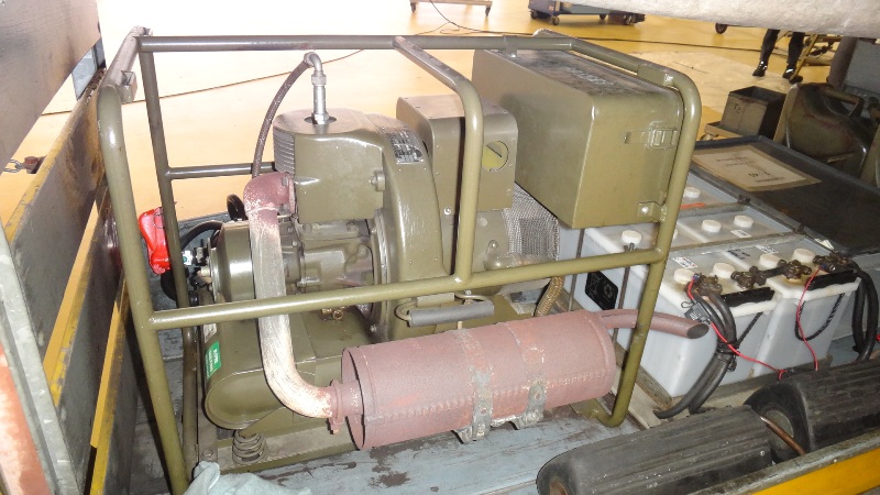

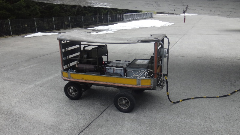

I have been in Switzerland for about a month doing maintenance and flight training on two Beech 18's (Canadian 3NM's) and a DC-3 (ex C-47).
Check out what they are using for ground power
Its a homelite 28 volt APU exactly like the ones used in every B-17 and B-24 throughout WWII. The thing had been sitting idle since last October and fired right up. Pretty cool.
