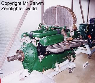

That looks like an older style V-12 engine to me, and there's no Japanese marine aircraft (floatplanes or flying boats) that used such an engine, according to the books to hand on those types. There is the 'Hiro Type 91' engine used in a couple, but that's a 3 x 4 cylinder bank engine, very different (and interesting). Otherwise they seem to be radial equipped.
So what IS it? Assuming the tailplane is associated, then it's got a stressed skin horizontal stabiliser, and a V-12 - pretty powerful relatively high performance. Any guesses?

(I should say there's on exception with a V-12 - the Aichi M6A1 Serian with an inverted V-12, but it's not going to be that, for obvious reasons.)

Didn't the Tony have a V-12? Not a seaplane....but maybe somebody thought it was and therefore, it became one.

Certainly! The Ki 61 'Tony' did indeed have a V-12, but inverted again. Not that that's the critical point. I don't think this engine is necessarily the right way up, as displayed, but the proportions look wider and shorter than a W.W.II era fighter type V-12 (inverted or upright) to me. (But I could well be wrong - the stubs look like 1940s style ejector types rather than the 1930s straight out kind.) If we open the possibilities out to non marine types, it's a much wider net, of course, but I agree, I think the marine id is probably wrong.

I can only think of a couple of Japanese WWII types that used inline engines. My WAG is that this is a Ha 60 from a D4Y "Judy" dive bomber, displayed upside down. Here's a pic of a Ha 60, displayed in a similar fashion (with radiator attached.)
And here's some info from the Smithsonian: http://www.nasm.si.edu/collections/artifact.cfm?id=A19710927000

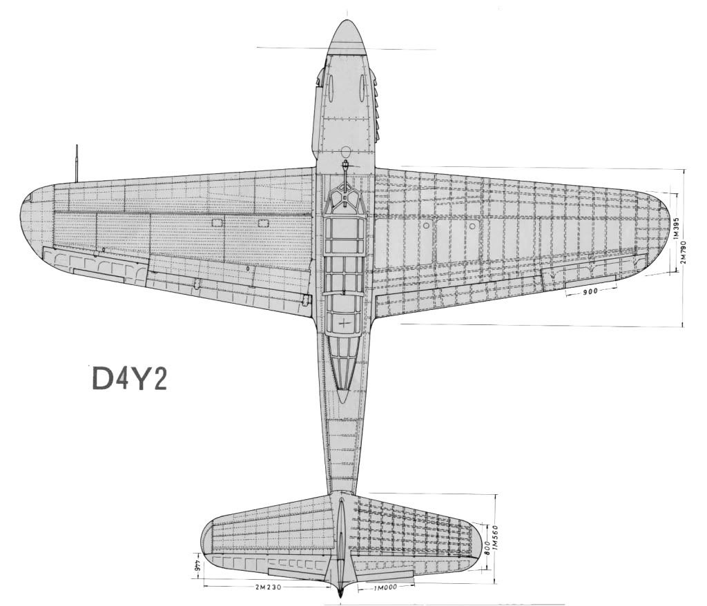

Assuming that's a tailplane, it could be from a Judy as well, although it's too incomplete (for me) to be sure. If it is a tailplane, it's much too large for a fighter. Anybody involved in the PoF Judy restoration have any insight?

I think Steve may have well put his finger on it. The distinctive large tube arrangement (that looks like it runs off one cylinder head and parallels the other - most unusual) matches. There's only the Judy that had that radiator arrangement (if the tube relates) and used the engine.
