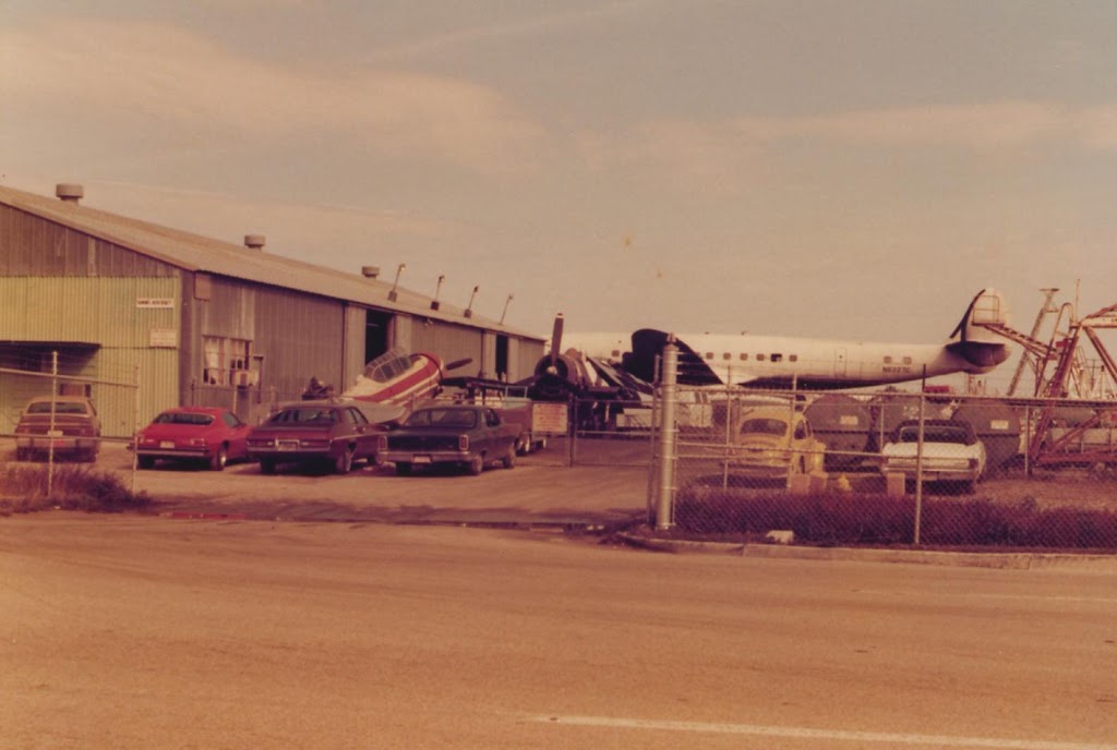

I used to go look at it occasionally when it was in the fenced lot on the NW corner of MIA when Dave Robinson (I believe that was his name) owned it. IIRC either one or both wings were removed.
Probably got a pic of it sitting there...
I believe there was a T-6/SNJ there as well.

Hi Glenn
I think this is what you are talking about.
Mark F.

That's the one!
Thanks!

Yeah... That is where I grew up black from head to toe.
Dave, or what everyone referred to him as, Robby was my Dad.
The T-6 or (SNJ) is sitting five feet from where I write this now.
Thanks for the picture. Any more would be greatly appreciated.
